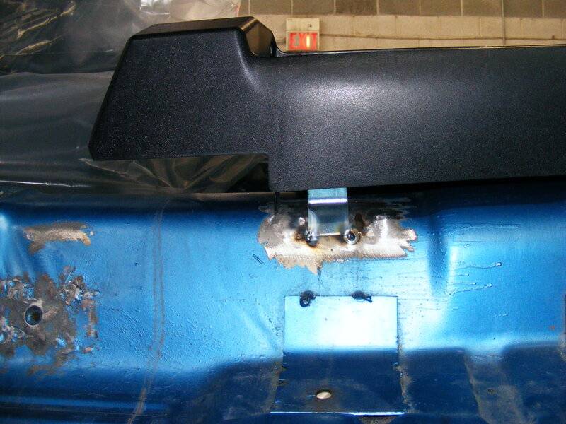

The bracelets have been removed, but the placement of where the linkage comes through is shown. Enlarge the picture and you can see where the bracelets were.

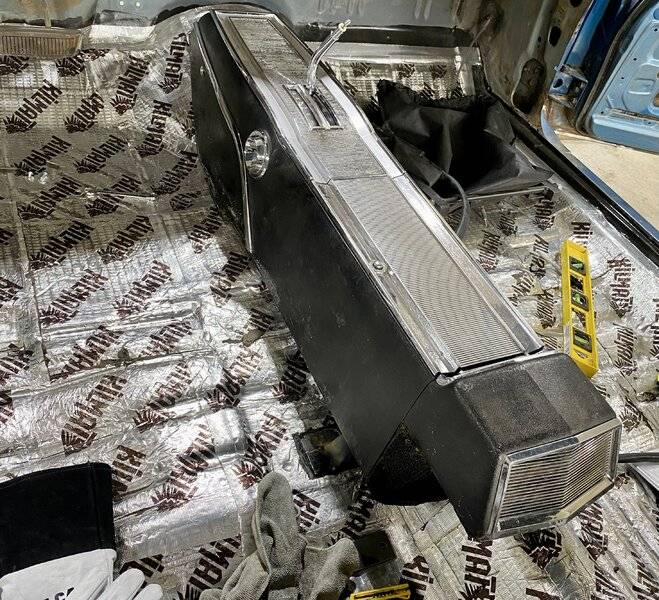

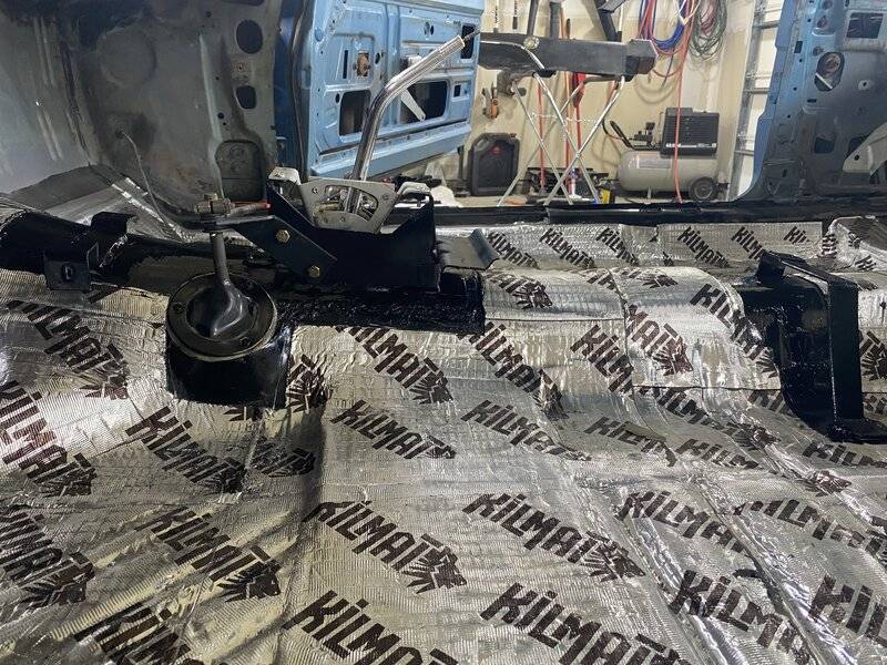

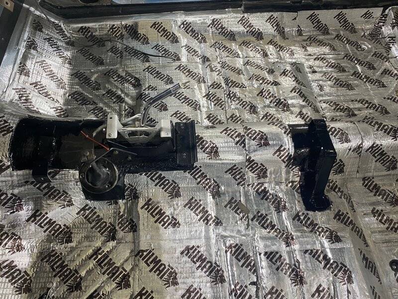

This afternoon, I successfully installed the console, which was made possible by the FBBO group.
Time to disassemble the console and prepare it for fresh coat of paint!
