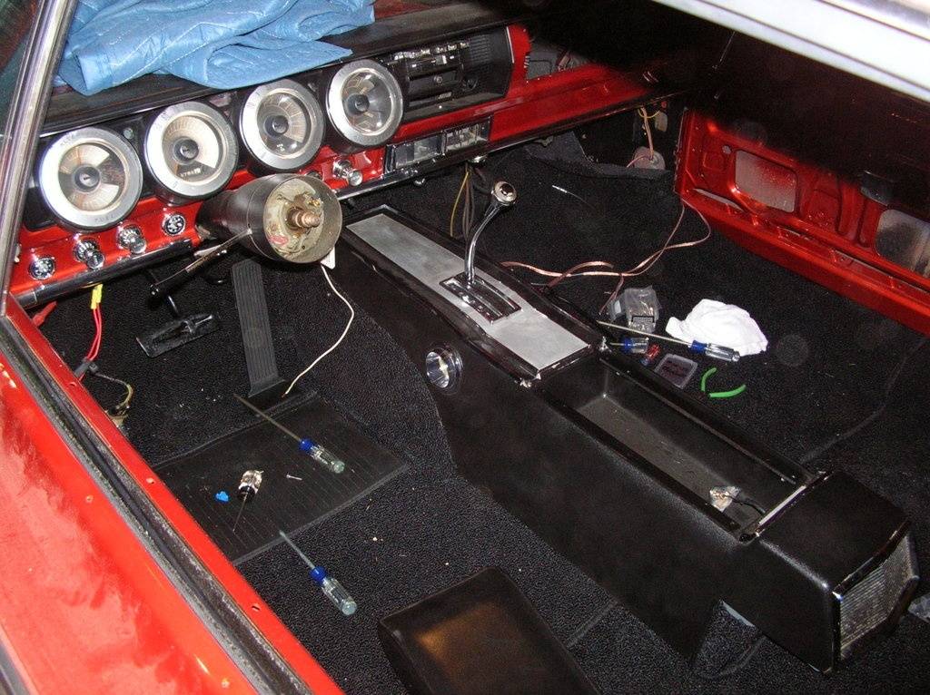

dragrazor......I took in one of my plastic parts to the local paint shop and ended up with SEM 15243 satin black color coat paint for vinyl or plastic. I too cleaned the panels well and used a paint adhesion spray before painting. Mine looks great.....
Carl
Thanks :) How about the metal part of your dash ?
It is painted the same color as the car....picture attached.
Carl
Very nice :).............which order did you re install dash/ heater box ? thanks for your input.........How ever quite aways to go b4 that process
My car is an air condition model, so I spent a couple months rebuilding the heater/air box and installed that first followed by the dash shell. I installed the pad next followed by the dash trim. I had to remove the trim twice to install items in the dash shell. I also had to remove the dash pad to install the speaker grill. Seems like I had to install and remove several times on items...lol...it is just part of the process.
Your car looks cool.....I remember when mine looked the same.
Carl

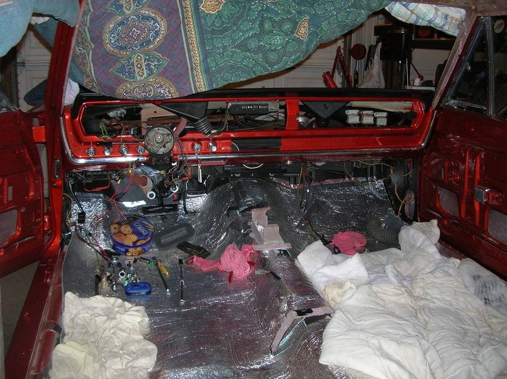

Hey thanks so much for the info, that is exactly what I am trying to avoid (redo after redo) If I had the energy to do so, but don't, so trying to do it in easy yet correct order :). Car had only 29,000 miles but sat in junk yard 20+yrs then my JUNK yard another 20 :) Windshield got busted via a tree limb, unknown to me early, so rusted passenger floor board. Was in salvage yard as being towed from accident scene, never got tow charge paid so was left in the salvage yard (left front damage)...........Not numbers matching as previous owner had engine self-destruct and dealer replaced, at less than 5,000 miles. No written verification so who know how true..........Any way is why am not going back original. Again thanks for the advice and info :)
