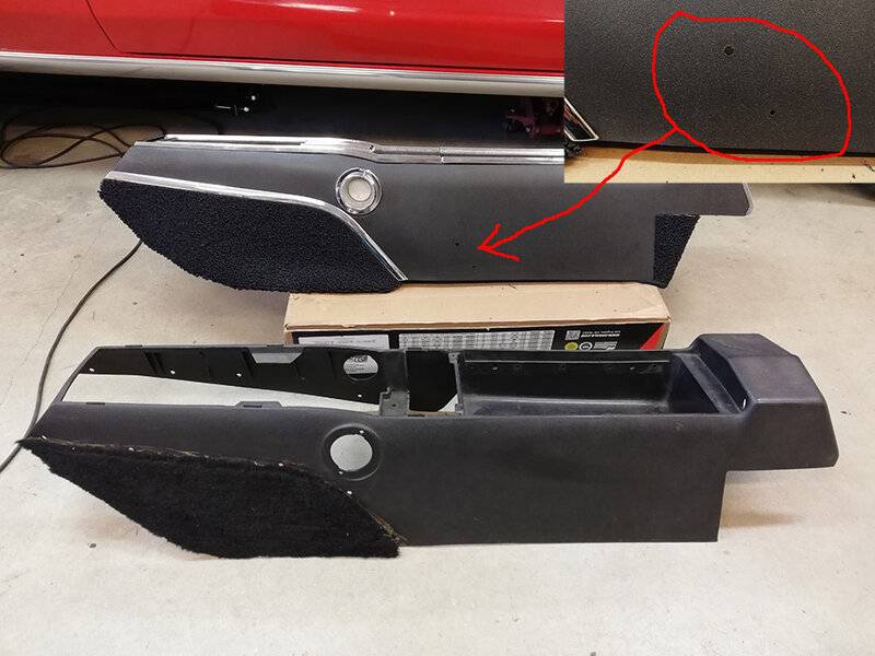

1. On the repro there are two holes on the drivers side, these are not found on my original. What are those holes for?

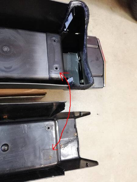

2. On the repro the light bezels, door hinge and lock latch are screwed into plastic only. On my original I have metal brackets behind the plastic for the screws to grab into.
(Had to do some plastic shaving and drilling to get my metal brackets to fit again.)
Is this a repro thing only?
3. The bracket in the car to attach the rear of the console is not flat, thus the original console plastic has some extra material on one of the screw holes.
The repro is flat and needs some plastic shaving to fit.
Repro thing only?

Those holes look like to me someone started drilling to make a 4 speed console and stopped. They should not be there..
True, that looks like a explanation for those holes.

Those are the differences between Auto & 4 Speed. All differences are shown and only on Drivers side. As far as the rear bracket they are the same for Auto or Manual...
Thanks for the info QuickBpBp. :thumbsup:
Yeah, Then Im even more confused why the extra holes are there and that this part is advertised as "original fit".
Again I think someone started to make it a 4 speed one and stopped... They should not have sent that out to you but they did...
