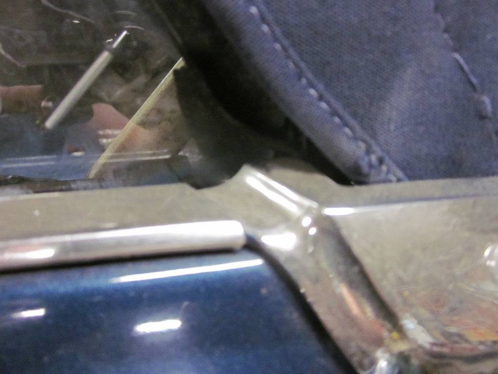

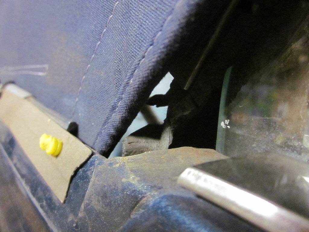

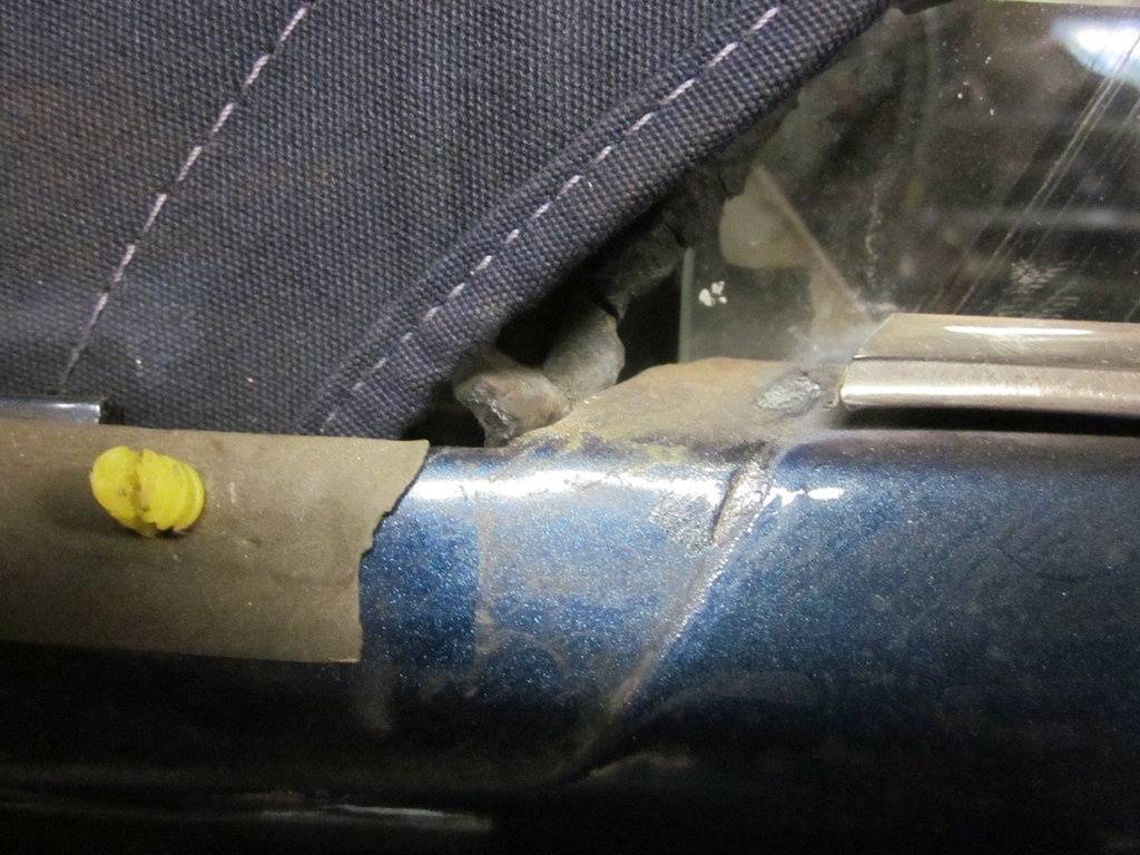

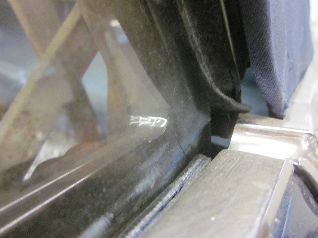

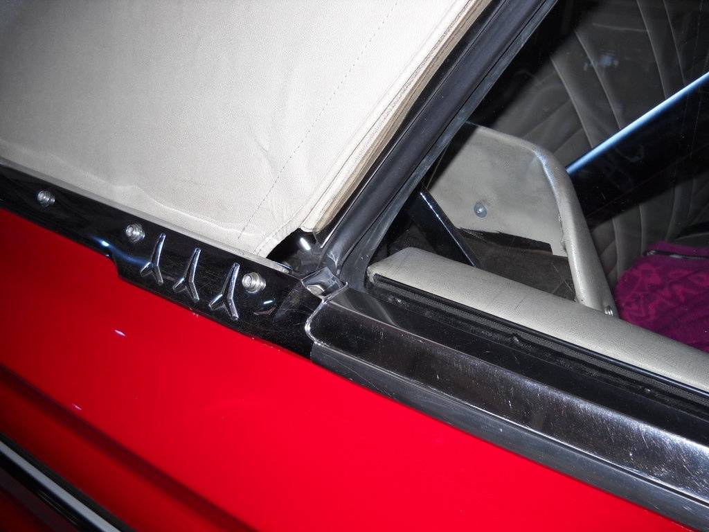

Glenwood - do you have any open gap at the base behind the rear windows like I posted with mine? Thanks, Ron

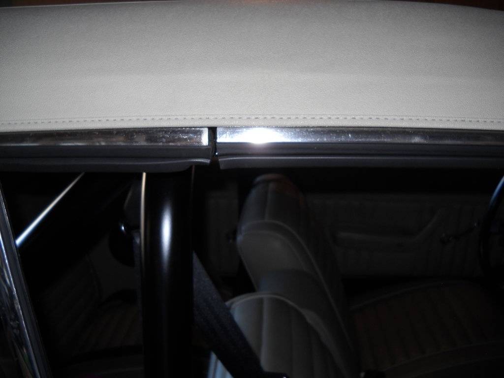

Not much of a gap Ron. The weather stripping needs replacing, but isn't in this year's budget! I went out and snapped a couple of pics for you. The top hugs the window trim fairly well and has a steel cable running through it.

I've looked over your pictures again, and there might be some adjustment room on the hold down cables to snug up the fit at the top of the windows. The problem with this is latching the top might be difficult to impossible unless you have two other people to help you get it latched. You could try an experiment to tighten the hold down cables and get the top latched (with assistance). Then let the sun try to form the top a bit better and don't put the top down for several weeks. It might work.

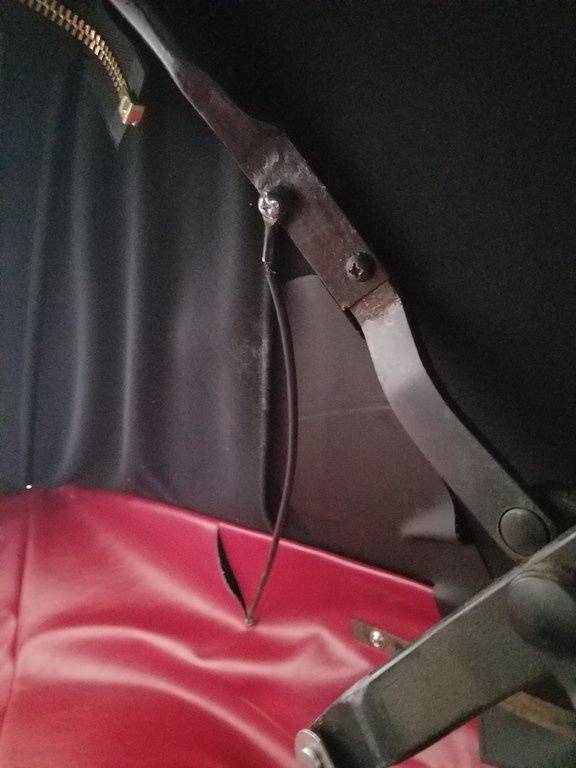

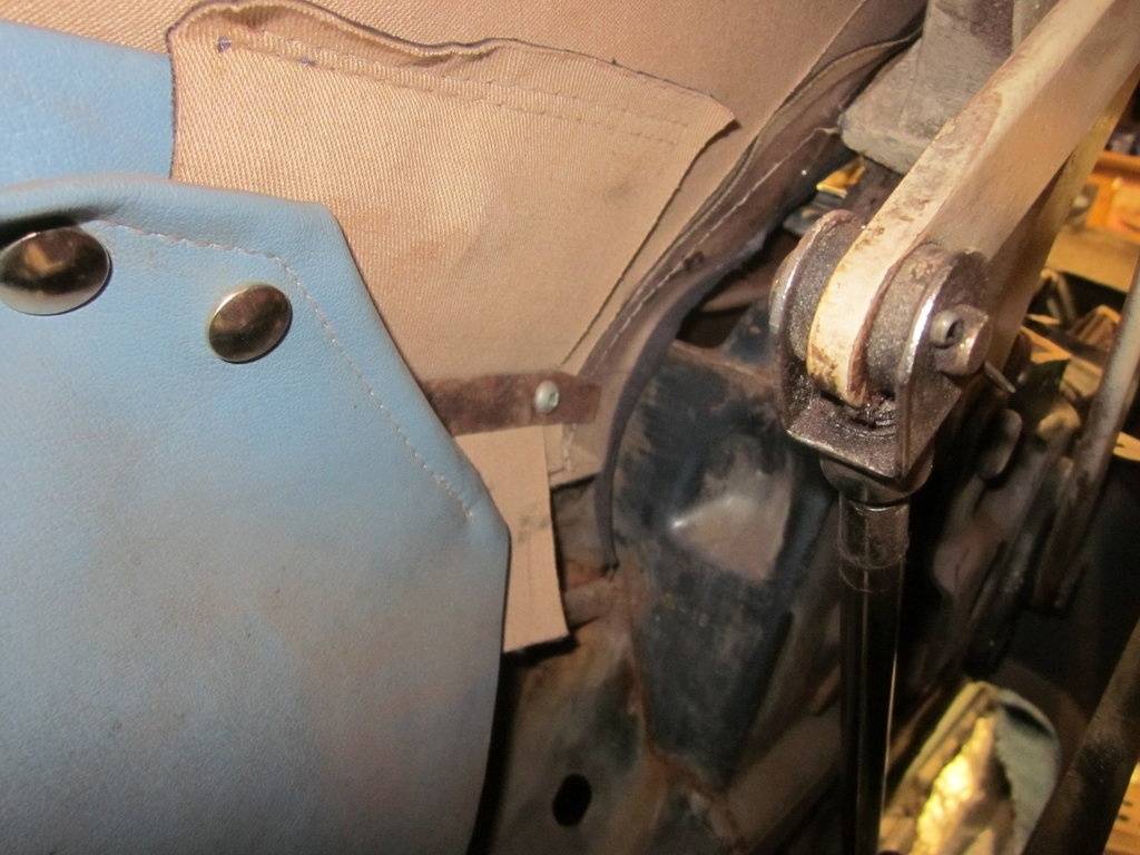

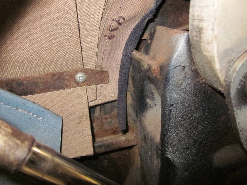

The only cables on my top are in the back attached to rear-most bow as I photo' d. There must have been a later top design perhaps...

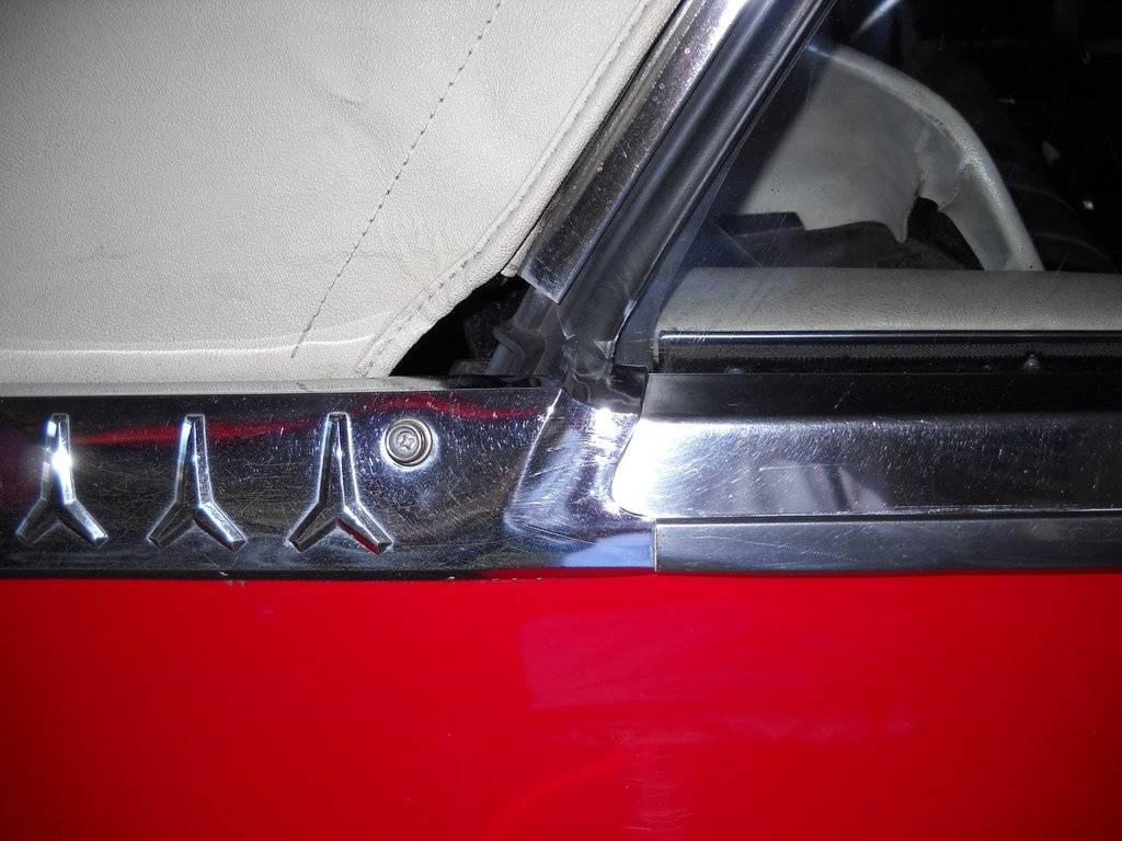

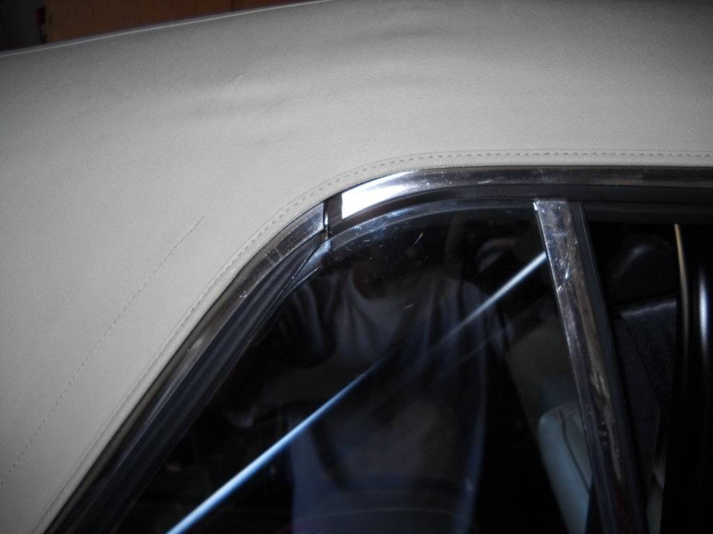

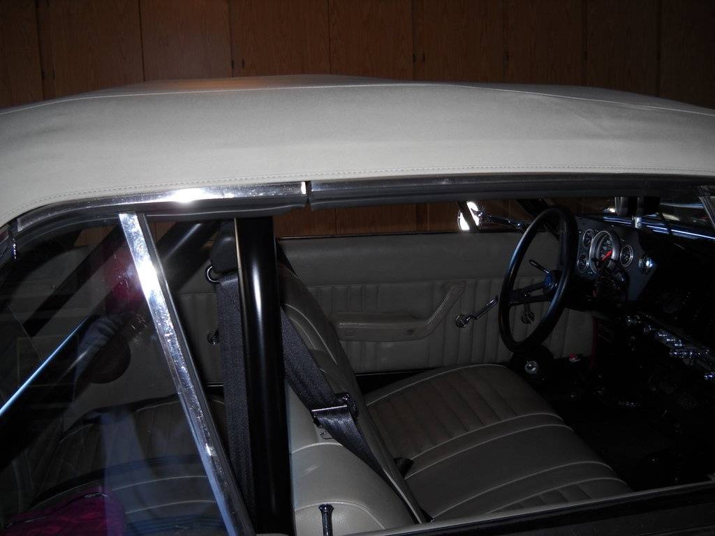

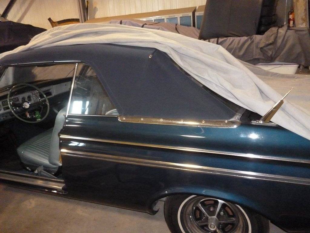

Here are a few pictures of the top on my 63 Fury. It's been on the car for 15 years that I know of. I've had the top down for the last few days but within a couple of hours those little wrinkles will disappear.

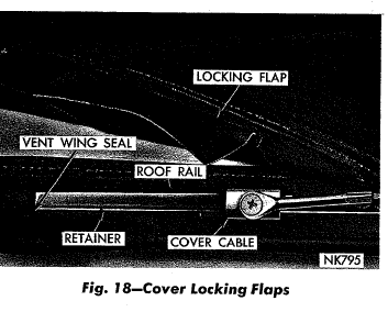

Bet your car should have them. Tough sometimes to find people who'll do something right. Not sure if this is the cable but I think so. Cover cable.

It appears that there could have been a redesign of the top frame after '63 as I don't have cables as shown in the diagram; just the ones I pictured above. And have no idea how they're supposed to work; they don't show in my factory service manual either for adjusting the top. Coloradodave your gap is like the gap I used to have on my old top - a little gap - with the new top it's like twice as large if you saw my earlier pic of this. I used to wonder about the opening as it certainly doesn't give a water tight area. Your top also covers a good degree of the top channel over the windows where mine doesn't. Way it is now, all I need to do is if lift the edge a little and can reach right into the inside of car over the top rail. Suppose if there's a place out there that knows how to adjust the frame it could make the fit a little better. There are numerous adjustments that can be made. Still holding on the top guy getting back to me...

My 63 Fury top only has the one cable at the rear-most top bow on each side. There are no cables or pockets for cables running the length of the top over the windows.
This was the design back when...must have changed it couple years later. The cable has slack in it with top up. Same with your cables? Thx
