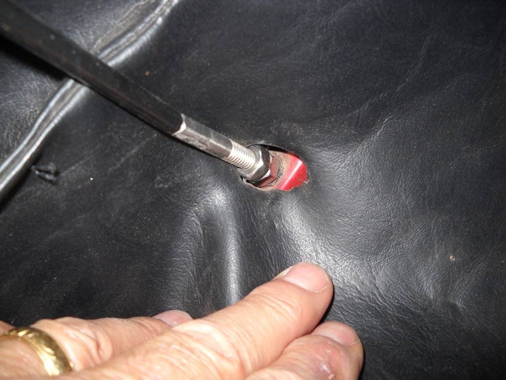

As afar as the cable ...There is a loop with a screw on the frame (so it can swivel as the top moves ) the other end is a long thread with the cable swaged too it . It screws into the steel body of the car ( around the side of the wheel tub.?)
You must remove the screw & eyelet to adjust the tension by twisting the cable ,thereby screwing the threaded end into or out of the bodywork.re attach the eyelet with screw.

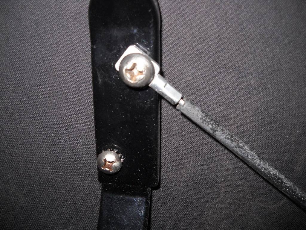

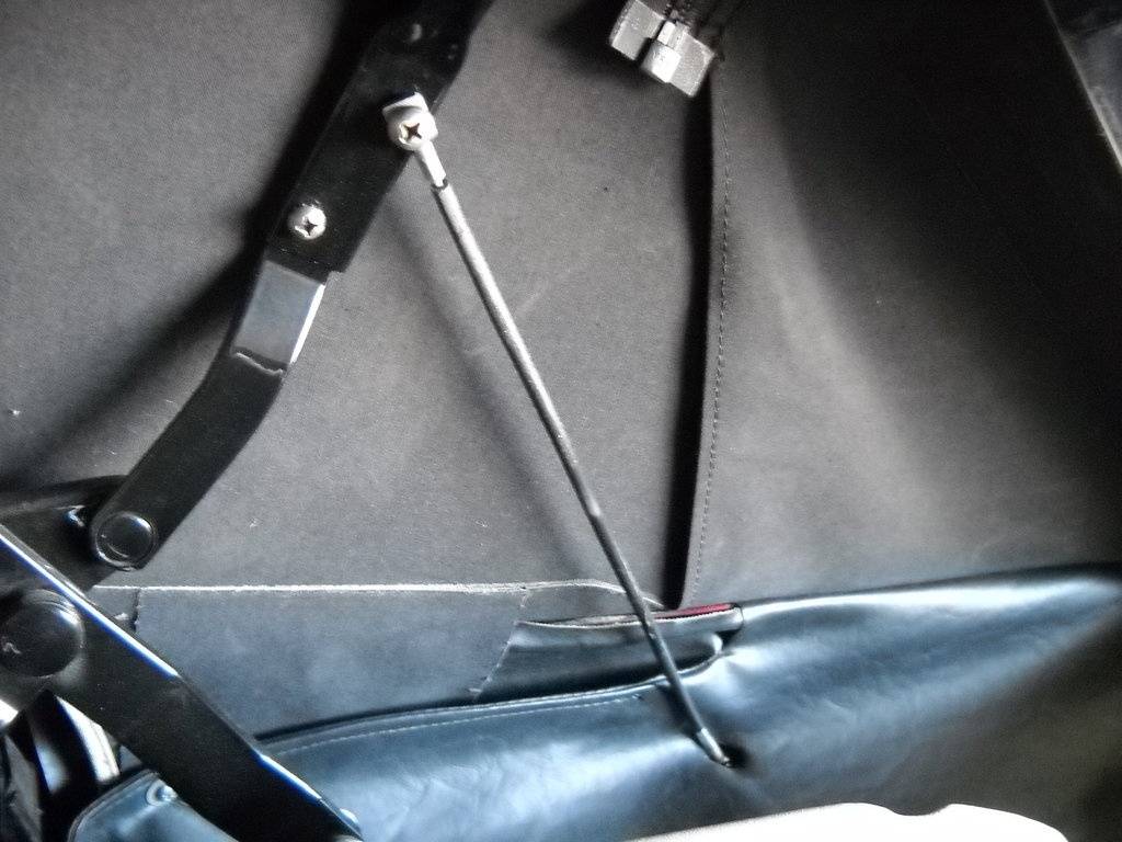

Ron,
Here you go. The bottom of the cable is threaded into a nut attached to the body. To adjust, you remove the top screw and spin the cable to loosen or tighten it.

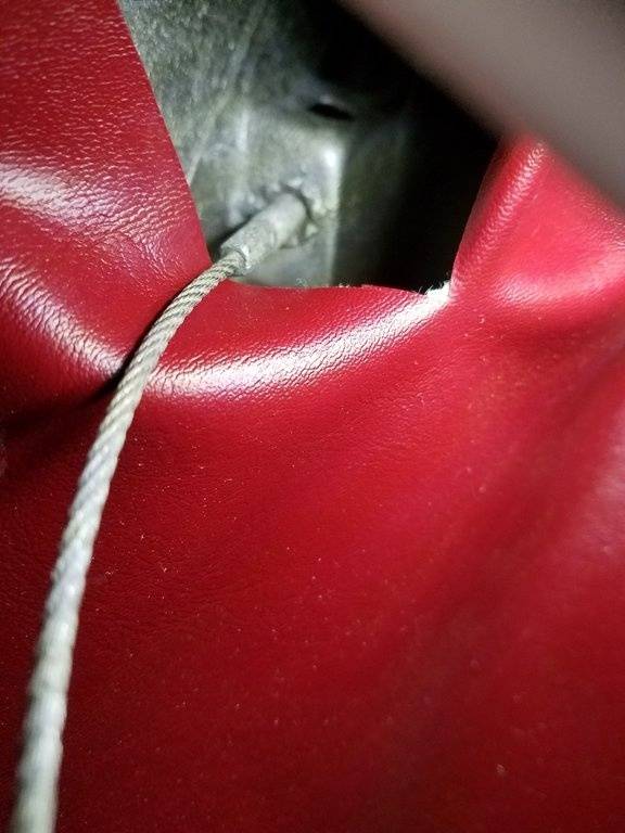

The cable connection is different on mine having a pressed fitting into the bracket. Some mirror work I hope will show me how it's affixed so I can take it out. There's what looks like an access hole on the top of the housing; a bolt or screw in there or a retainer clip I suppose...
Talked to Hydro E but the tech guy apparently wasn't interested in talking with me relaying a message to the front desk to say he doesn't know how the cables are removed; well bought a cable from them so I can see how it looks and hope it works once I figure out removing the old one.
