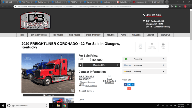

I was considering ordering a glider but DAMN $191,000
