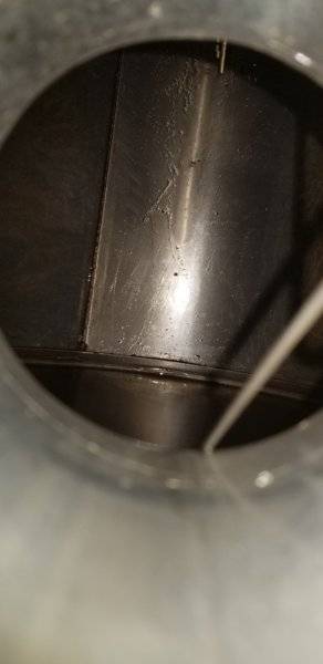

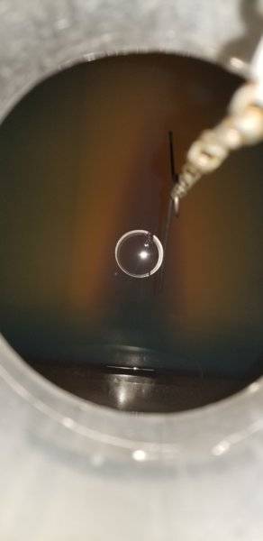

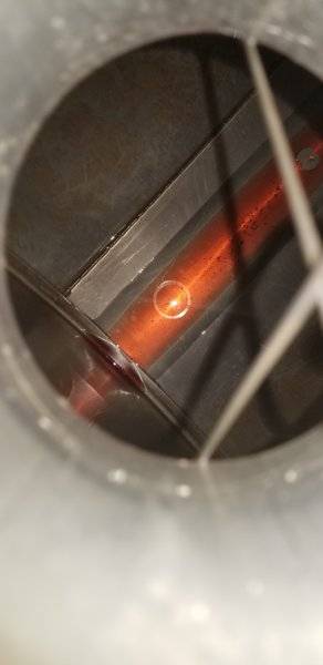

So I got the tanks cleaned out today,now we wait. Before and after pictures.
