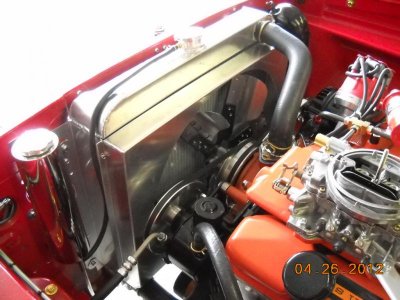

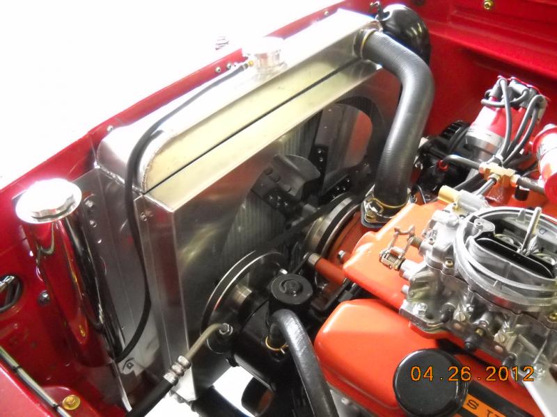

I used a dorman universal overflow bottle. It fits perfect next to the radiator on the drivers side. I added a fiiting to the side of the bottle which will allow for the overflow. The bottle comes with a spout in the bottom and you use that for your fill and return. This will fill when it gets hot and suck it back in when it is cold. Oh the bottle is less that ten bucks. Hope this helps.
