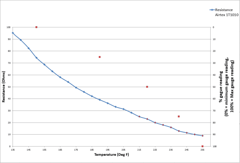

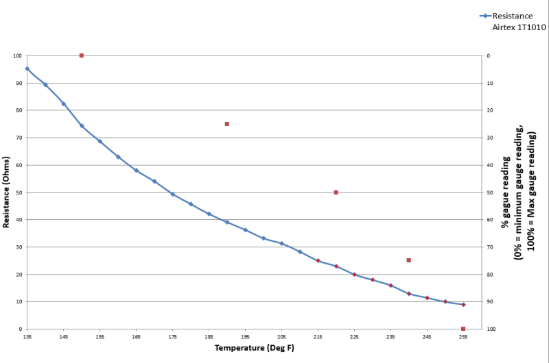

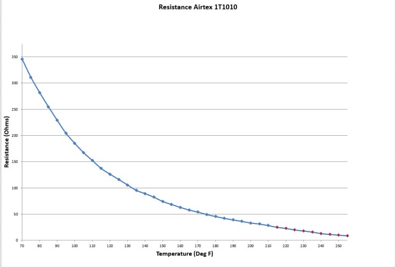

The values in Red diamonds on the graph are extrapolated based on the curve I don't have a way to get the water above 210 deg
The Red Squares are the gauge readings 0 = cold, 25 = 1/4 scale, 50= 1/2 scale etc
My thermostat is 180 deg and my gauge sits at between 1/4 and 1/2, so in the 190 to 215 deg range

This is what I got with various A Body senders and for the gauge reading (Red Triangles) I used several 100W 10 ohm and 1 ohm resisters in series till the gauge read E, 1/4, 1/2, 3/4 F in the car with the cars IVR and the cars wiring.

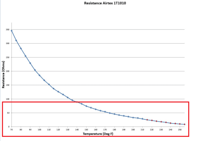

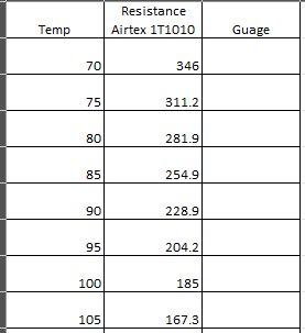

The sender is a variable resister and has a very wide range that it can measure. Our gauges are only interested in the (roughly) 100 to 250 part of the range
So the sender that can read the interesting part of the range and can also read the other parts of the range BUT our gauges cannot.
Here is the curve that the sender CAN provide
Here is the PART of the senders range that the gauge CAN display
The gauge can only display this part of the entire curve
so when you measure the sender at room temperature it will read in the 300 ohms range till you heat it up to about the 135deg range, then it will be in the 73-10 range of its curve.

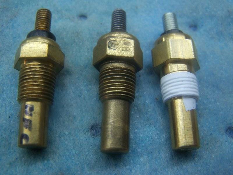

Often times the parts house will supply you with the wrong sender. It happened to me last year. In the picture, the sender on the left is new but bench tested at 500 ohms at room temp. (70F) The center one and the one on the right both read 352 and 360 respectively. I'm not sure what the part number is for the one on the left. It looks similar but has more threads and is not correct for a Mopar. The one on the right is a Standard TS-17.

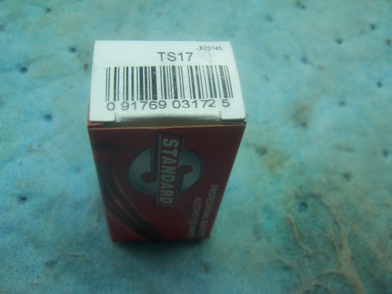

I have a collection of ts17 and the economy ts17t. It’s like buying a moog lower control arm bushing, all wrong and unusable.
Ts17 or the T model is correct according to application but the quality control is out the window so you never know if it will work accurately or not
