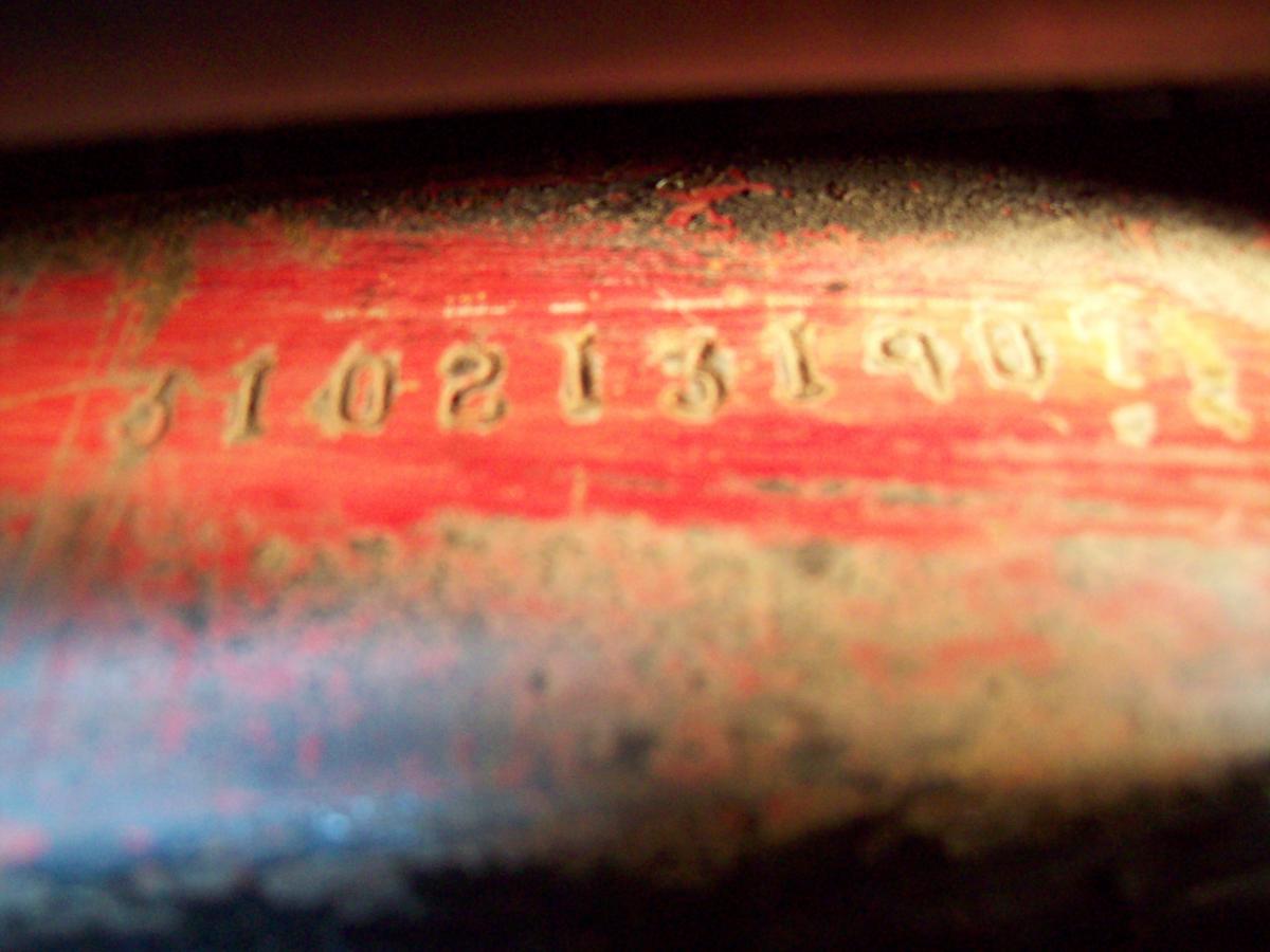

I'm pretty sure you should find the Sales Order, not the VIN, on the radiator support. Since it's a St. Louis car, have you looked on the side of the radiator support on the engine side or have you only looked on the top?
I am pretty sure '62-5 the SO #'s are stamped on the top rad support and under the package tray on the passenger side. I know my '63 Savoy and the few parts cars I have cut up are all stamped there...
Here is the SO# stamped on my upper rad support, it matches the fender tag SO#.
