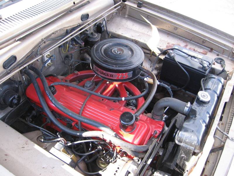

Sure it can be done. I used a flexable air gun and snaked it as far as I could. I was doing a 64 Dart and the cowl plugs were already there.See Photo. It is a messy job.Using air from the top cowl vents and back again thru the plug openings. Don't for get to open the kick panel vents too and blow them out.

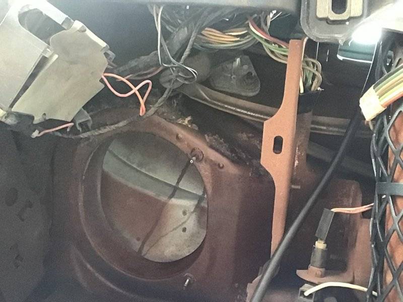

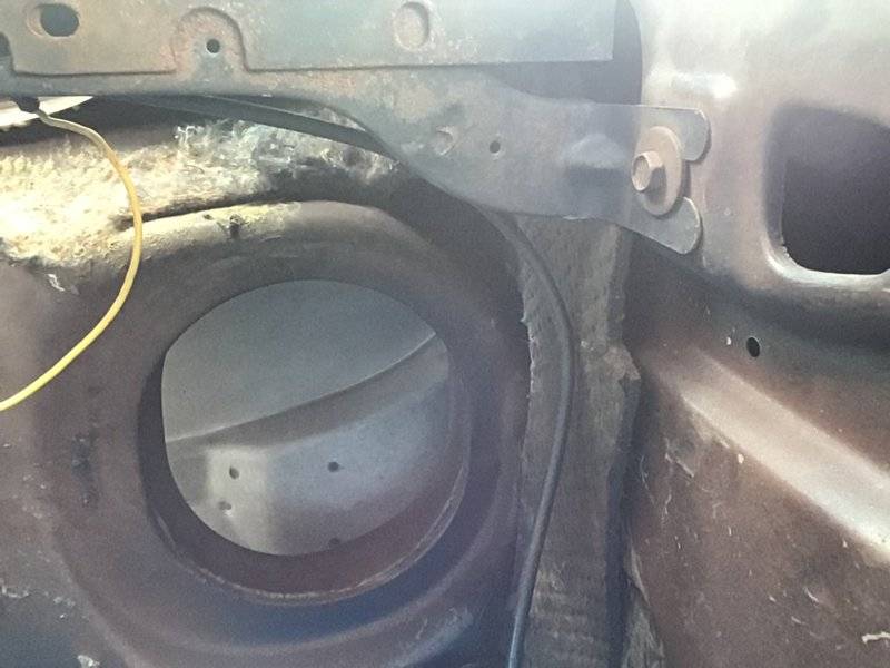

Remove your heater box and the drivers side vent, then you have two huge holes to access the cowl and clean it out. They are smooth and you are not going to cut yourself.
You can reach in and pull out the bulk of the debris, then shop vac it out. Then run water in there, there are drains holes on each side. There is a raised up dams around both these huge holes so water won’t get inside the interior.
Top pics is pass side, bottom pic is drivers side.
B297B9A9-AA36-4150-8941-10B074768D54.jpeg C5C00610-DB8B-4C59-A222-7419B3659A0C.jpeg

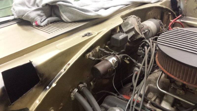

Yeah I did. I cut an opening big enough for my hand to go in, and kept the piece I cut out to put back in. I had a huge mouse nest both sides, as well as leaves, sand etc. It fixed the leaks I was having. I was able to get a wire brush in there and clean the area thoroughly before painting it. There was only surface rust remarkably and it all came out well. Much easier than removing the windshield, top of cowl etc on a '66, plus I was painting the engine bay anyway.
The holes you cut are smaller than the factory holes underneath the cowl.

View attachment 821479 View attachment 821480
