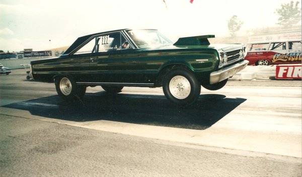

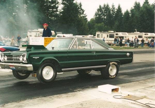

I had talked to Cragar about them too,
they said "they are NOT made to be street driven",
after coming across that same info... that's why I sold mine off the '63 pictured,,mostly street driven..
