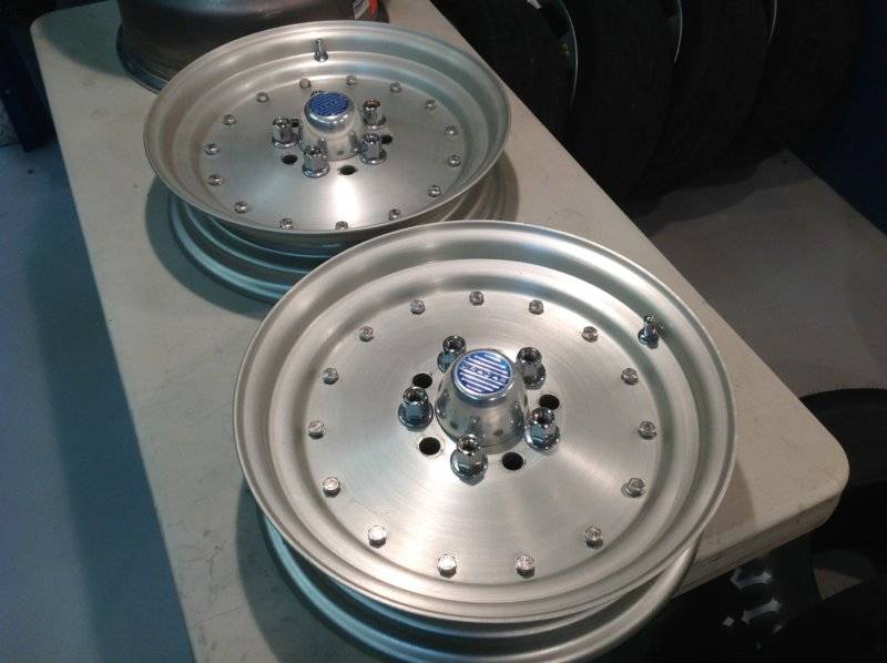

So after months of watching for Super Tricks a fellow member right here on FBBO came through with a nice set of fronts for me. Still on the look out for some 15 X 12's with 5.5" bs.
A big thank you to fellow member XYZ guy for the 15 X 3.5's! Great shape and with a good scrubing and new set of stainless steel bolts they look like new.
Malex, great find for you and even the center caps are in great shape. Good things can take a little time, like wine! Hope you can score the rear wheels as well.

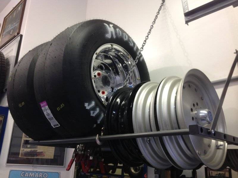

I'm expecting the 15X12's could take a long long time to round up. In the meantime I'll run draglites on the rear with the Tricks up front. With the wheel change and the other changes made since end of last season I'll be about 200 lbs lighter this year.

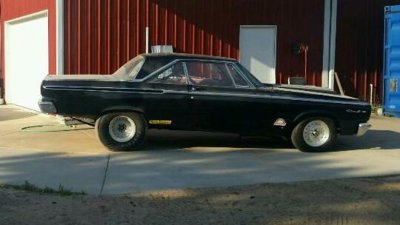

Neither cars are mine. The black one belongs to a friend of mine, the red one was for sale not too long ago. I really wanted the car but wasn’t able to connect with the guy. I have a set 15x3.5” and 15x12 I’m going to use for my 65 Dodge. I love them!!

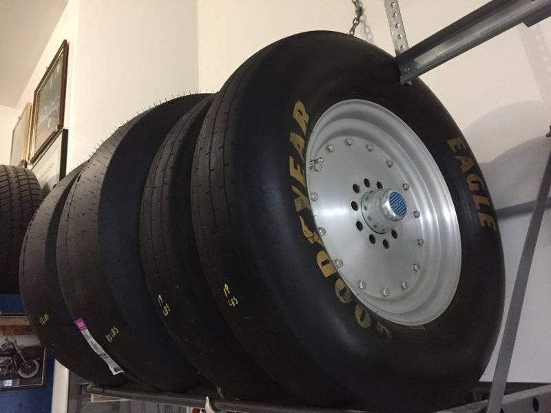

There's just something about those iconic Super Tricks on old Mopars... Thanks to fellow member XYZ Guy I have a nice set of fronts now too. Eventually some 12's with 5.5 BS will show up one day.
These 3.5's look like new cleaned up.
Super tricks with Good year fronts come in at 38 lbs for the pair.

Malex, did you use tubes in those tricks? If not( and at 38lbs i'm thinking you didn't) are they holding air?
Awesome set btw. I wish mine looked half that good.
I've had Super Tricks on my GTX since the early 70's with no tubes in the front and the only time they lost any air was, I didn't tighten a valve core. :thumbsup:

Thanks 33! No tubes. Zero leaks.
I cleaned off the old sealer, cleaned up the original o-rings and reinstalled, followed by a nice coat of silicone all the way around. I also installed new stainless steel bolts while I was at it.
In the picture below you can see the o-ring under the clear permatex silicone.

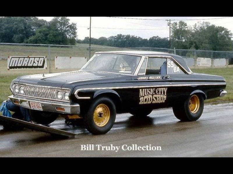

Love those Super Tricks!
This has got to be one of my favourite pictures of all time.
As you can imagine, I've been doing lots of thinking about anodizing. First I need to locate some 15 X 12's with a 5.5 backspace. Anyone?
Wish i could help with the rears malex, but i only got my fronts that came on a car i bought. That car came with 15x12 auto dragson the back. My 15x3.5 came with tubes and i was told they would never hold air without them. Clearly as Richard Blaine would say"i was misinformed"(casablanca)
What i liked about the supertricks was that they Could be anodized, which you couldn't with centerlines because of the stainless rivets.
When i do see wide rear supers, they are almost always on a car that has used them for decades.

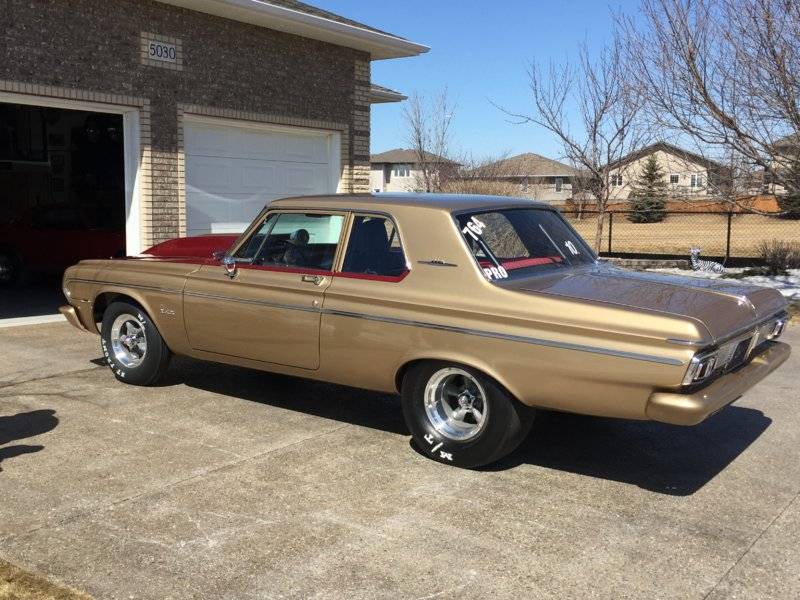

Malex, Many years ago when I first got Super Tricks, I almost had them anodized gold as I thought the gold would complement the green paint but I changed my mind. Are those American 5 spokes on your Plymouth?

The rims on my Plymouth are the American Racing Torque Thrust V105D series. Period correct and very affordable, also quite heavy.
