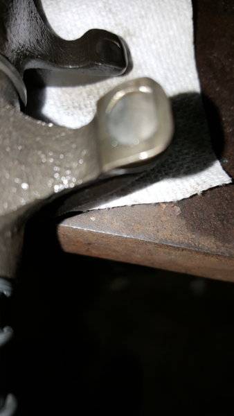

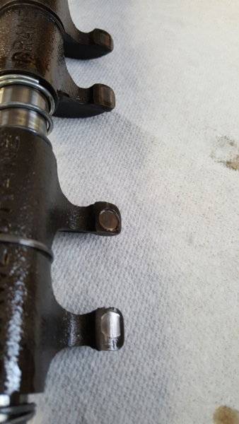

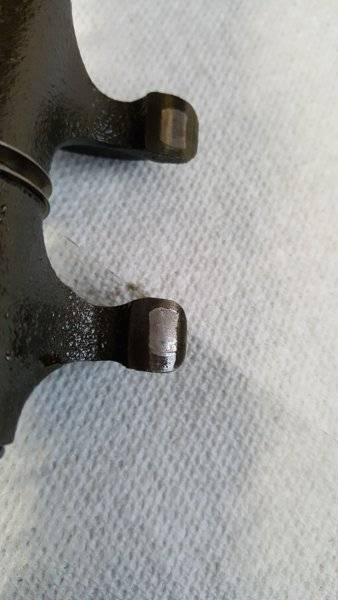

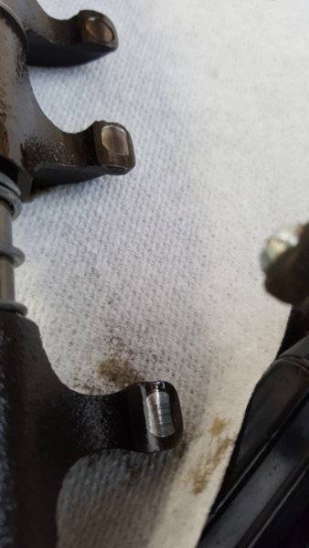

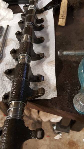

So I decided to do some pre-spring checking and pull the rockers I installed last summer since threewood had experienced failures with his last year. I had already bought mine, so I went ahead and installed them. Unfortunately, I found the same problem with mine with very little run time. Really sucks!
I contacted Crane and they discontinued them a month ago apparently. They must not have been hardened properly to wear so fast.
Now I have to replace them and probably the bloody pushrods again...not happy. What to use?

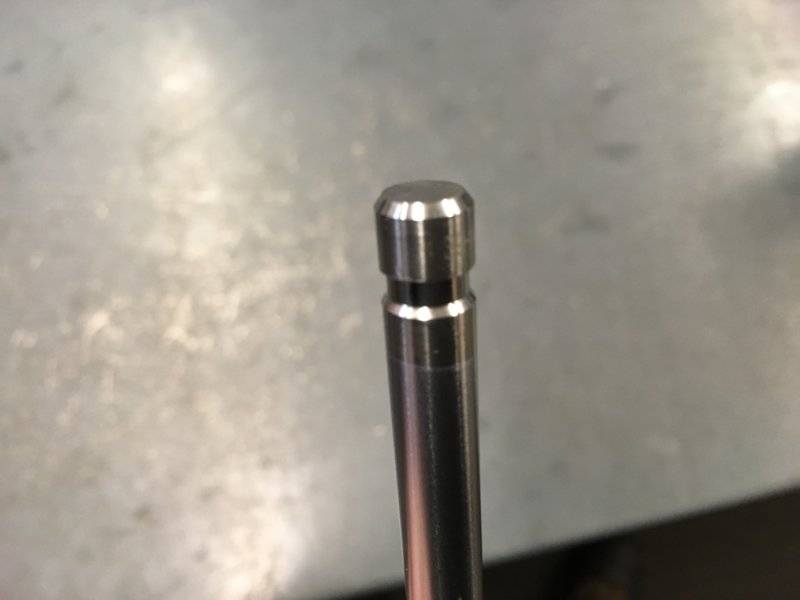

If they’re being used with Stealth heads, it wouldn’t surprise me if the cause of the problem was the smaller contact area of the Stealths 11/32” valve stem vs the 3/8” stem the OE heads have, that the rockers were designed for.
Additionally, the recent two sets of Stealths I’ve had here have a fairly substantial chamfer at the valve tip, which makes the contact area even smaller.

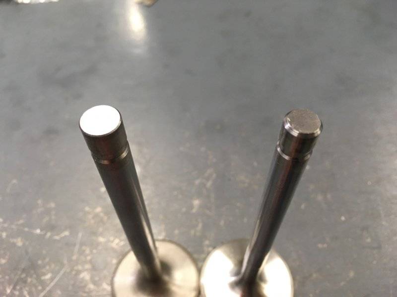

1st pic- Stealth valve tip
2nd pic- Stealth valve tip compared to Ferrea 3/8” valve tip

they are sidewinder heads which also have 11/32" stems. I didn't realize they were smaller than OEM.
I don't see a chamfer but then I'd need a magnifier these days! If that extra 1/32" dia. is a contributing cause, then other ductiles like isky might also be a problem? So I'm looking at rollers or back to the stamped.

this is the nature of the beast. those ductile iron rockers use a late '50's-early '60's design/technology. there was never fast cams or heavy springs back then. if you want those to be somewhat reliable use moderate lobe profiles/lifts, lower spring rates, and be sure you'll never get close to coil bind. I use them, have used them, and have had to throw them away. if the tips don't go bad the fulcrums do; and most of the time both. never use them with a high lift cam. don't understand the love affair with them in conjunction with a modern fast rate high lift cam.
What do you consider a high lift cam to be?
I thought my 494/513 lift was reasonable for these rockers. The springs are 924s at 120@1.82 height and 347lbs rate i believe.

I wouldn’t have expected an issue with those lifts and spring loads, and it’s certainly possible the rockers are just soft.
But, I wouldn’t risk another set at this point, unless perhaps you found a used set that had enough miles on them to prove they’re properly heat treated, but not so used the ID is all galled up.

I have run crane rockers for years with over 450lbs over the nose with no problems. Its definitely a hardness problem. The 924 springs barely push 300lbs at.500
