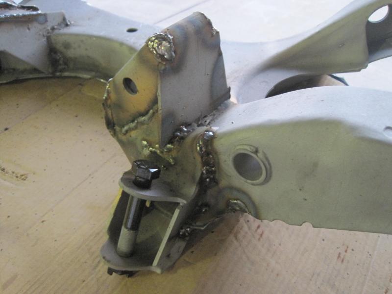

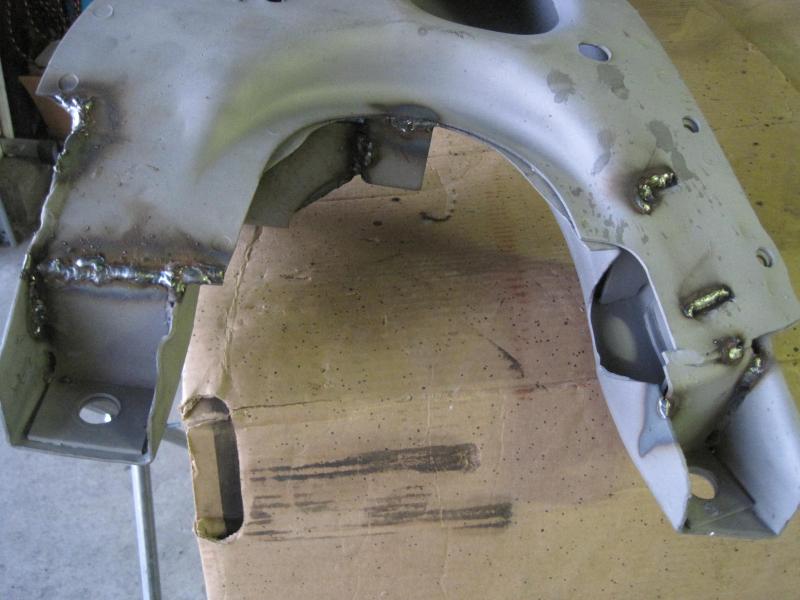

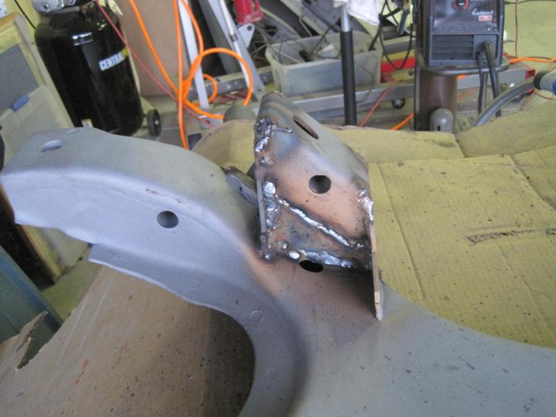

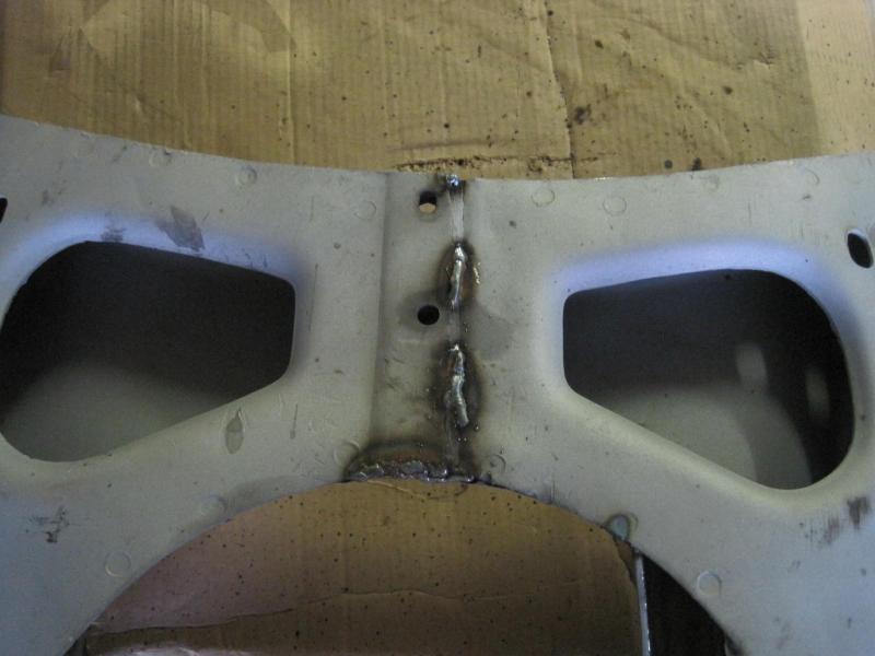

Started Project Overkill yesterday. The steering gear bracket is sturdy enough but there are two openings that I wanted to box in. The third steering gear bolt is off to the side with a large triangular opening below, that was boxed in as well.

I welded all the edges of my K-Member, and then added one reinforcing plate for the steering box. Looks like you have added a little more that I did. However, I did not see if you welded all the edges. These were merely spot welded, so adding a bead around the edge is a good thing to do while you are there...

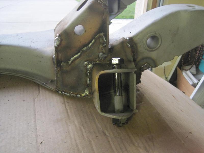

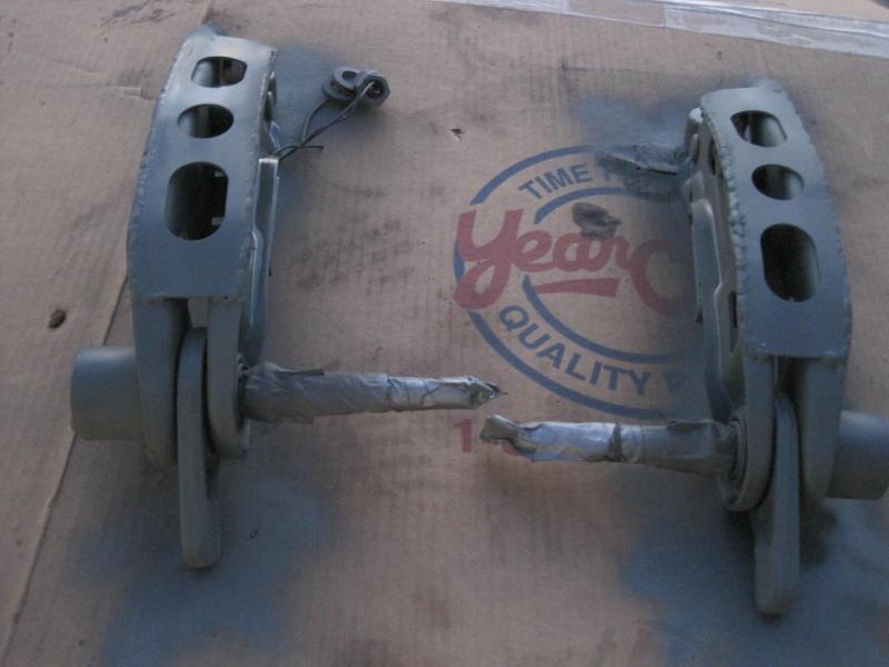

Boxed in the driver's side engine mount bracket and went over seams that the factory missed.
