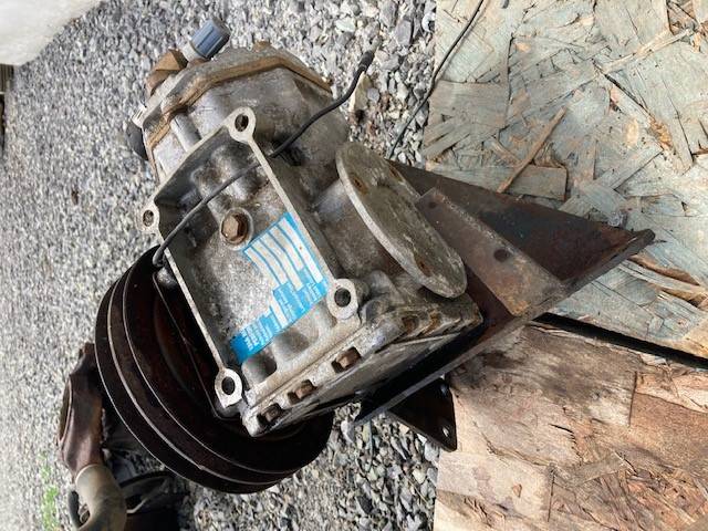

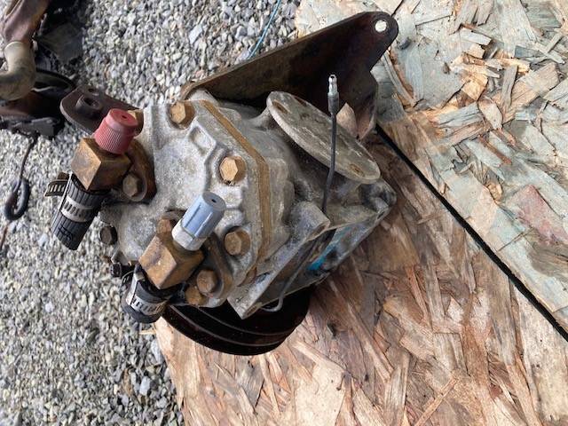

I bought a '77 440 out of a motorhome yesterday. Sat for many years beside some guys house but fired right up with a jump and a little squirt of fuel down the Thermoquad. Odo shows 36K miles. That's not the crazy thing. The crazy thing is this enormous aluminum A/C compressor. Anyone ever seen anything like this?
York Techumseh compressor is what it looks like to me
Yes, on 60s Fords. My Dad had that compressor on his 64 TBird. Also, I have an aftermarket Frostemp A/C that was put on my 66 Coronet in 1970 with this compressor.
Add on a/c systems used them. With the type of hoses and fittings in the picture definitely an add on aftermarket install.
Looks like the one on my '76 F 250. Not the most massive compressor that I have seen.
From a add on a/c unit.
I used to install Mopar add-on systems in one of the dealerships I worked at and at that time (mid 70s) all the kits had the York style compressors. I still have a kit for a 74 C body I want to sell.

Not really unusual. Stock on Fords and our cousin AMC's back in the day. They adapt well to onboard air compressors for the Jeep/off road crowd.
They work great. If you need an air compressor pump, they will make 300 psi.
Like others are saying, that was a REAL common compressor back in the day.
Hell, you could buy an aftermarket A/C kit from SEARS for your car featuring one of those...

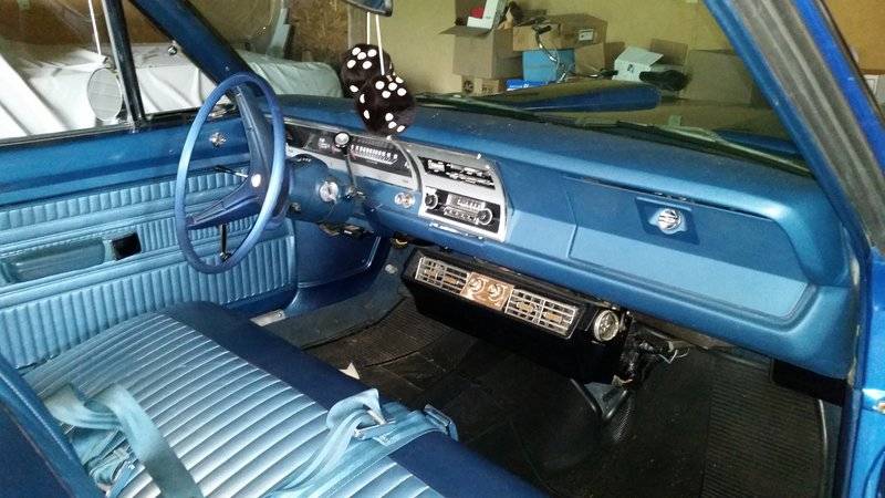

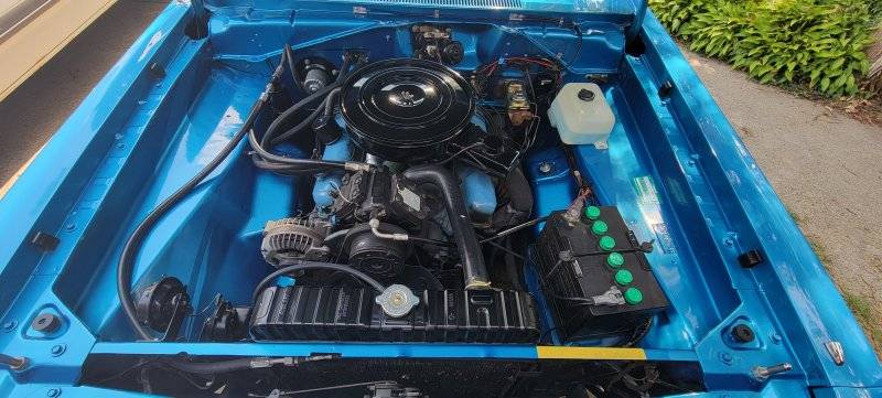

The factory Mopar kits had the V2 and the aftermarket kits had the York. I own a 70 Swinger with dealer installed air with the factory Mopar Kit with the V2.
We installed 100's of them and just about every Mopar kit used a non OEM compressor not a rv2. These were the kits ordered direct from the Mopar parts department. If there were factory kits with the rv2 I do not remember them. All the kits had the window sticker in them.
