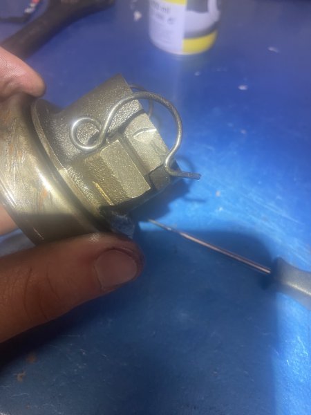

Trans is out now and sure thing, the fork was hanging on one end.
I got a pretty deep mark on the bearing where the fork sits.
Also the clips that holds the fork are bent, one is worse and it really makes the fork wanna slip away.
Bearing got Some rattle so i quess i just replace it and I should Also check my clutch before assembly.
I have re-bent the spring clips and re-used them before, not easy but can be done.
