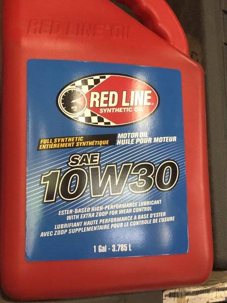

I nominate THIS brand as the most useless "tits on a bull" motor oil:
Hey wait....what do you mean? I see it is a synthetic though....

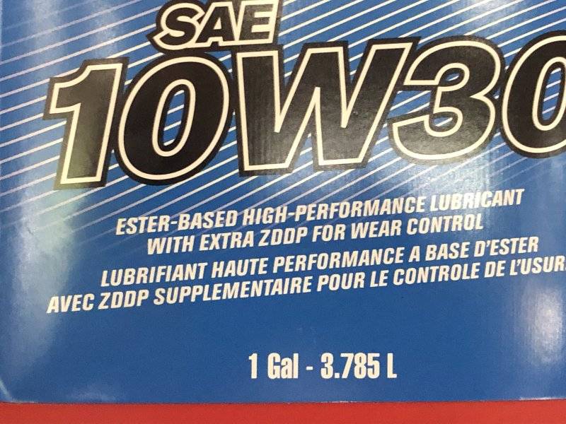

It also lists EXTRA ZDDP for protection...

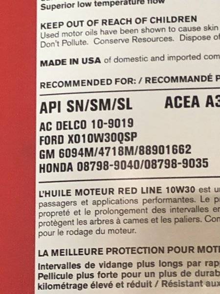

But then you flip it around and see the label.
Yeah....SL, SM, SN are all the latest formulas with HIGH detergent.
An oil with high detergent will wipe off the ZDDP as the oil circulates. This is like a police force that arrests all criminals but leaves the jailhouse doors open.
It cannot have "Extra ZDDP For Wear Protection" and also be "API SN/SM/SL". There seems to be a chemical disconnect here. Oh, wait! I think I got it; false advertising somehow!?!
