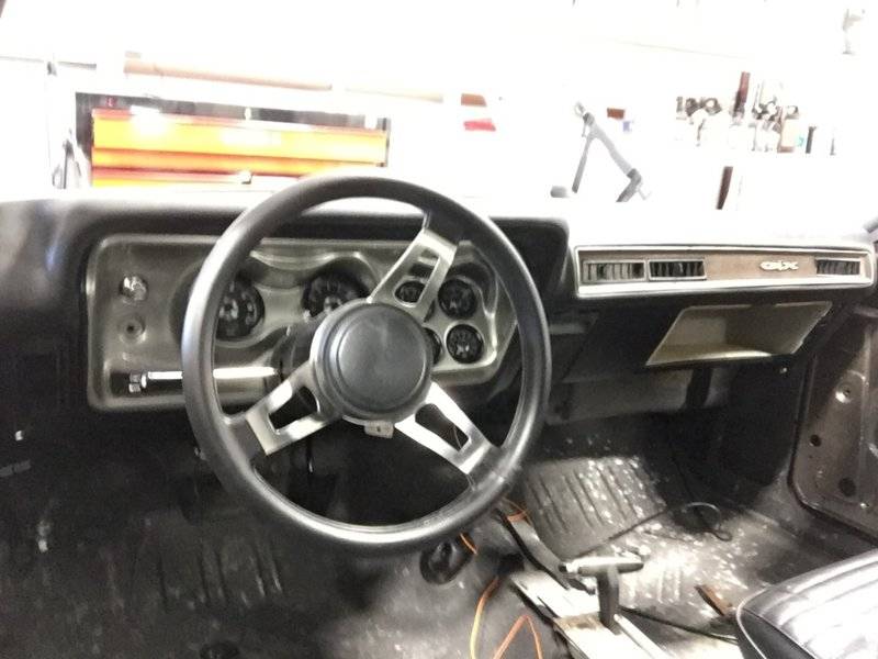

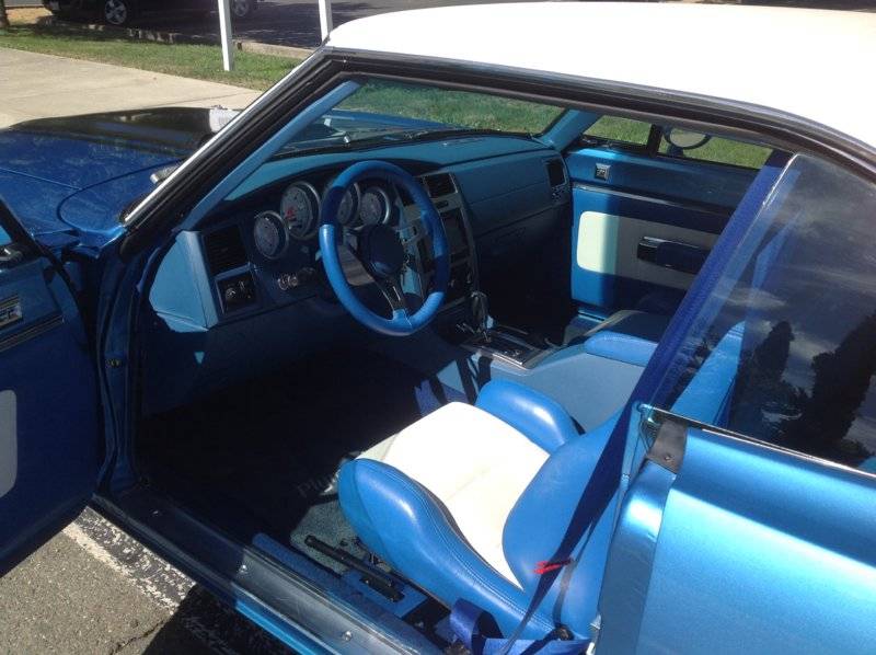

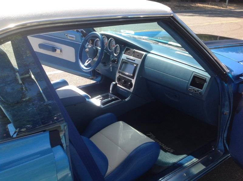

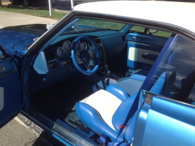

I put an entire dash and center console from an 07 Charger in my 70 GTX. It was much easier than it seems but it did take a lot of time, many in-and-outs to get the fit just right. Lots of discussion about it on my build thread. B Body Stiffening in member projects section. Sorry about the lousy pics, if you are that interested I will take some cleaner ones.
View attachment 582810 View attachment 582811

How did I end up doing the same thing without ever hearing about your car? That is really a nice job! I wanted to cut the squared off hump out of the Audi too but it's in a salvage yard. So I made one. Other than that I did what you did. I have to install the harness still but like yours it's a BEAST!
Yours is looking great Ghost! There are tons of emblems that could look just right on your wheel center, particularly once yo fill the holes. Are you going to paint the dash like I did or leave it as is?

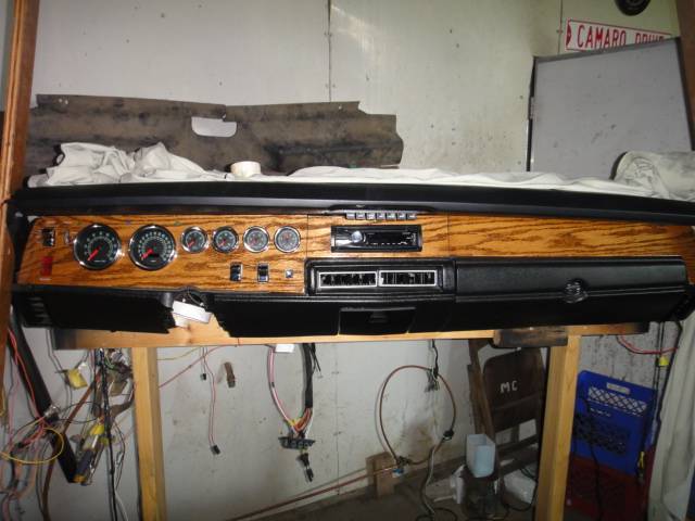

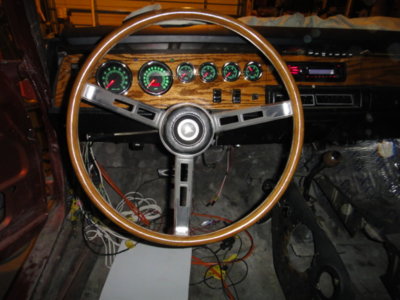

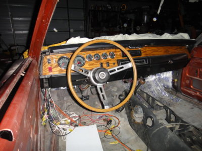

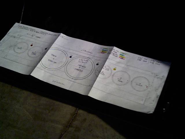

this cost about $750 to do in 2011 IIRC
for one of my 68 RR's

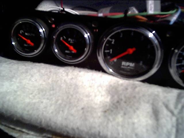

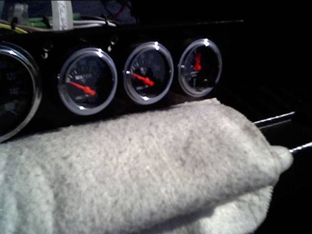

I ordered this gauge set. I got the blue led lighting.

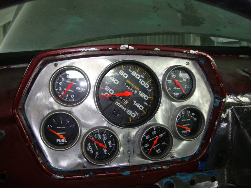

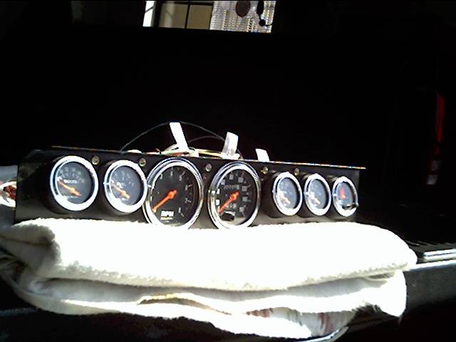

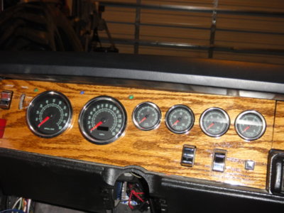

New vintage gauges, home made bezel.

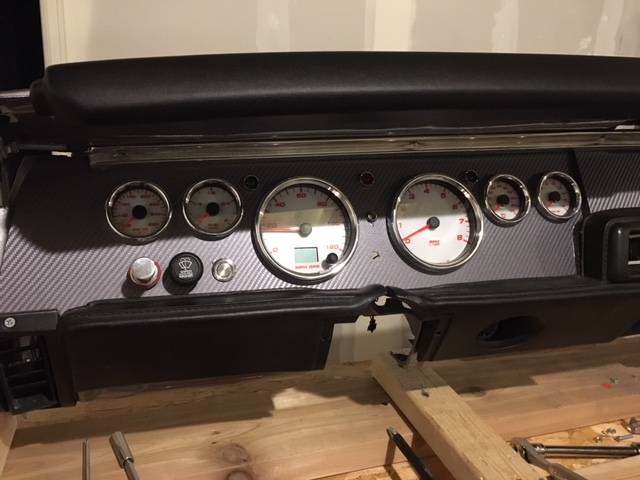

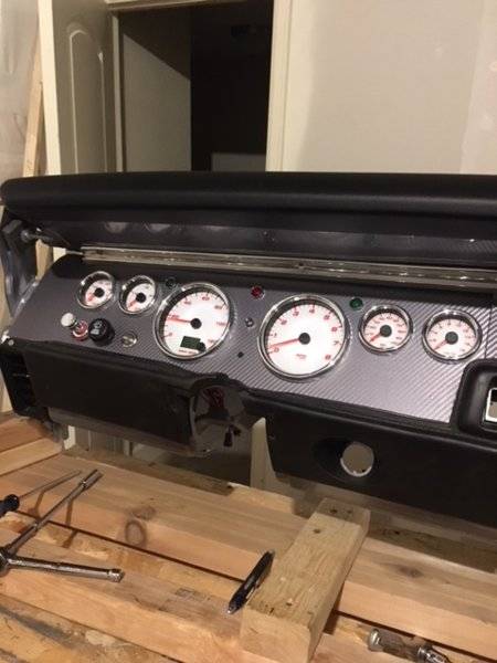

69 Coronet with carbon fiber overlay and Speedhut Gauges. Sorry about the lousy pictures, lighting not the best in shop. Had to build a sheet metal insert to replace the original,
weld in place,
arrange gauge placement, cut all holes, cover and then collect all the dash pads from FBBO and ebay. LED indicators and warning lights as well as LED in gauges.....a work in progress. About to order the full car wiring harness and attempt to wire her back together before mounting. A question for you experts: Should I mount and then do my under dash wiring OR wire her up on bench and then mount dash in car? Which is easier and makes better sense from your experiences?
I would do all that could be done on the bench and then install. Lying upside down across the door sill ,is no fun. Any connections could have an extra length of wire added so the dash could be placed up close to it's final location and completely wired up and then set in place. The extra lengths could then be coiled and taped up underneath. If you ever have to pull the dash again then everything can stay hooked up while the dash is out and flipped over so you can work on it in comfort. That's my plan anyway.
That sounds like a great plan, hadn't thought about adding extra length! The wiring of all this new technology into a 50 year old car has me scared anyway...might as well be comfortable. I will be adding EFI to all this and a 6 speed auto with an ECU....I'm really asking for a headache! I appreciate the coaching Ghostrider and any other tips you and others might have. Mocajava
