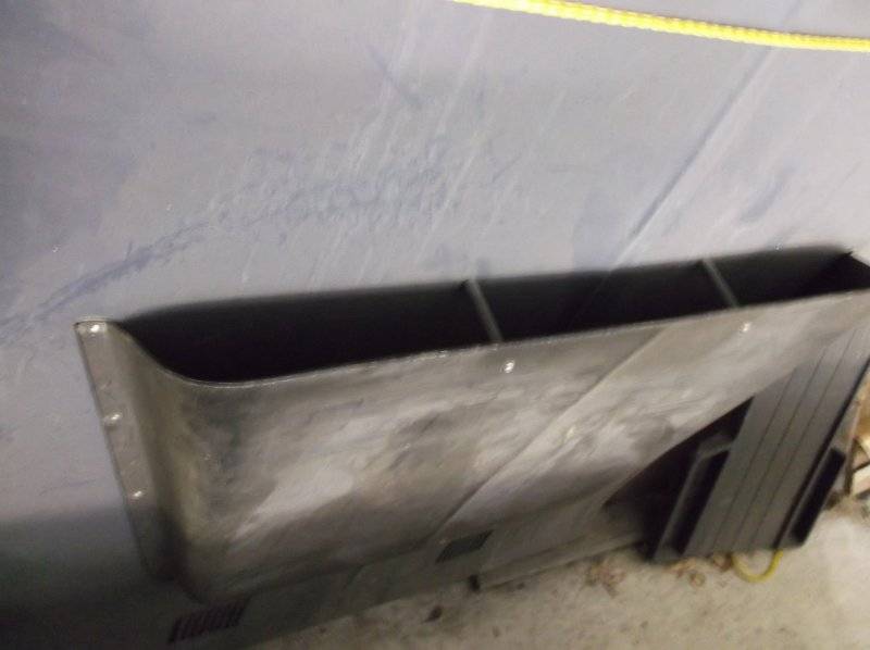

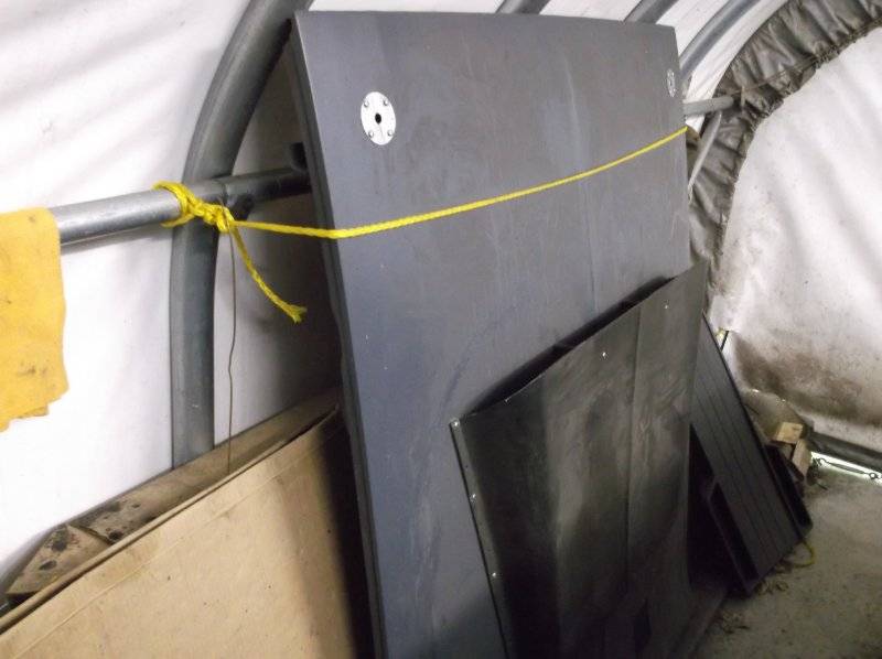

That's what I was thinking. I have one that is mounted on a 73 Satty hood from the days before me when the car was used for racing only. There were or maybe still are, two methods of affixing a plastic or fiberglass scoop to a hood. One had bolts or molded in threads similar to what you have drilled and the other had a flange that you drilled through and pop riveted or screwed down. I am at work presently and have to work overtime tomorrow but I will take a look at that hood & let you know what the measurements are if you are interested. I am sporting a factory power bulge. Pictures below.

Awesome. Yea. That looks very close to what I had. It’s just the dimensions that are screwie to me.
The more I look at your hole pattern, I'm sure that is a 68 hemi Barracuda scoop shape. They were very wide at the front, with a couple studs to hold them down, and tapered to a narrower width , and shorter height at the rear.

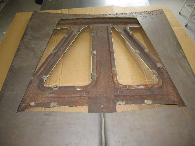

I fabricated this scoop from an old hood skin. That gave me the OEM ridge. It was quite easy to cut and bend. My body guy glued the scoop to the hood with panel adhesive.
