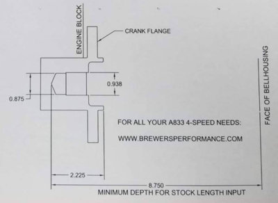

The bearing I purchased from brewers they include directions on how to address the input shaft......

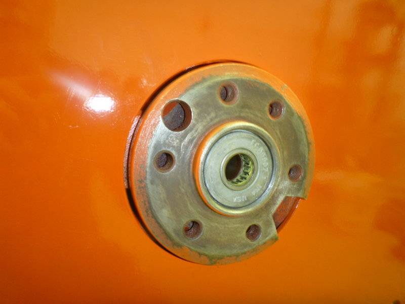

Putting my Bee back together and mating it's #'s match trans back into her in the past few years I had to use the roller bearing shown above, as it's one of the transmissions that I'd cut to put in another car many moons ago and it didn't have enough input shaft remaining to reach the OE pilot bushing anymore. Anymore than 5/8 to 3/4" max cut off and you'd have no input shaft left to be a guide point.

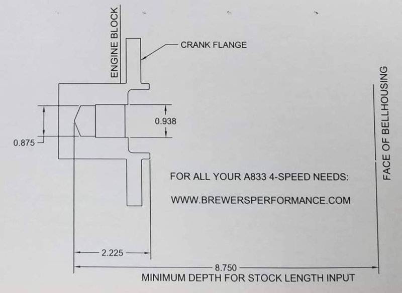

Directly from Brewers.

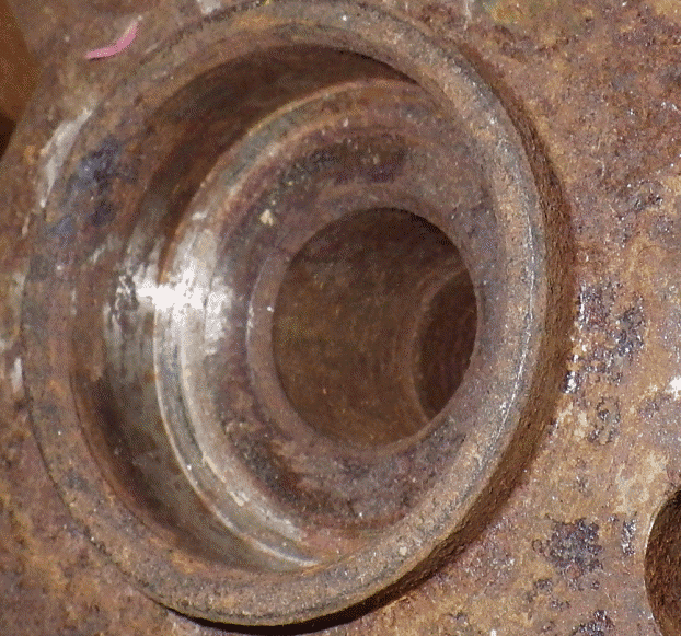

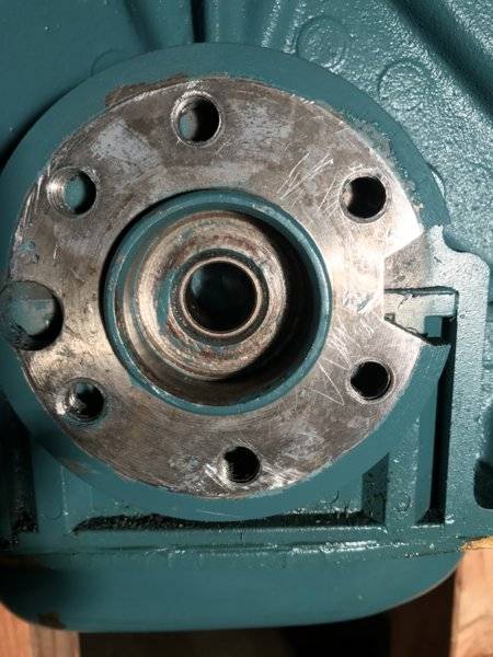

Here's a 440 auto out of a '68 block. The bushing area is not opened up....

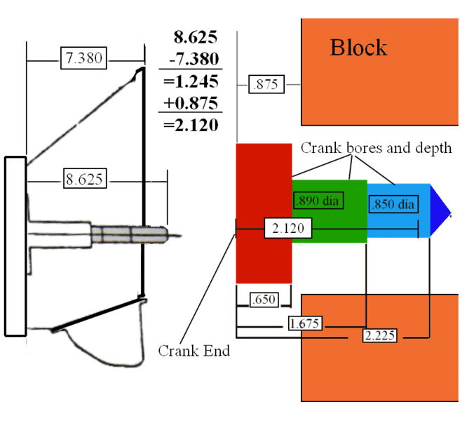

What I came up with using that crank and an uncut input...…...
