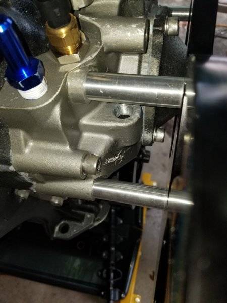

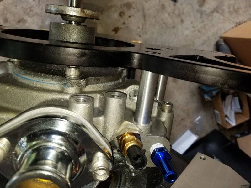

I'm putting the wraptor all in one on my 440. one of the main bracket bolts blocks the lower heater house fitting. I'll call cvf tomorrow, but wondering if anyone here had this issue.

The kit should have a brass 3/8 pipe 90 degree fitting for this. I had to grind or machine some off the spacer where it is above the fitting, then another 90 to bring it back up for the hose pipe.
Not sure if your trying to clean things up under the hood while your at it but what I did with both heater hoses was installed fittings that turned them down and went under everything. Mine is the SD serpentine so the hoses pop out under the A/C unit then to the fender, leaves the front of the motor nice and neat.
