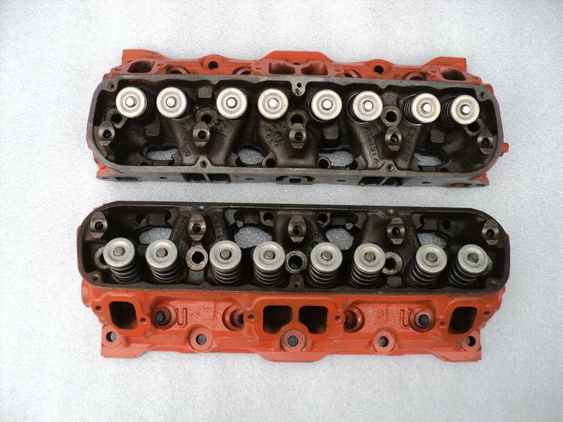

i have a set of small block cylinder heads,supposed to be from a 340.the only numbers i can find on them are 714 h299.i checked the valve size with calipers and valves still in heads could be off some.int 1.880 ex 1.500. does anyone have an idea what these might be.any help would be appreciated.
Should have a X, U, or J next to the spark plug hole & the X heads should say 340, U Heads are T\A head$$ worth some coin.

Noletters ?get the casting number from under the valve cover
