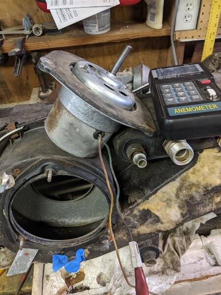

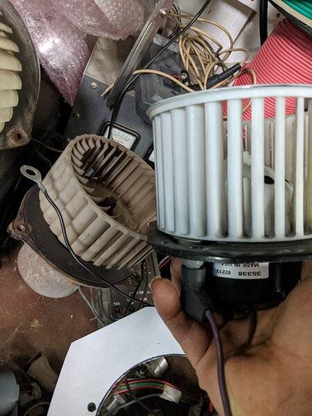

So I have collected four AC blower motor and I've got a spare evaporator heater for under the dash and I got to wondering about a newer blower motor that might be more efficient. So in one of my trips to the pull aparts in Tulsa I looked for a blower motor and fan out of a newer vehicle. And I found one out of a early 2000 Chevy van that looked sort of close.

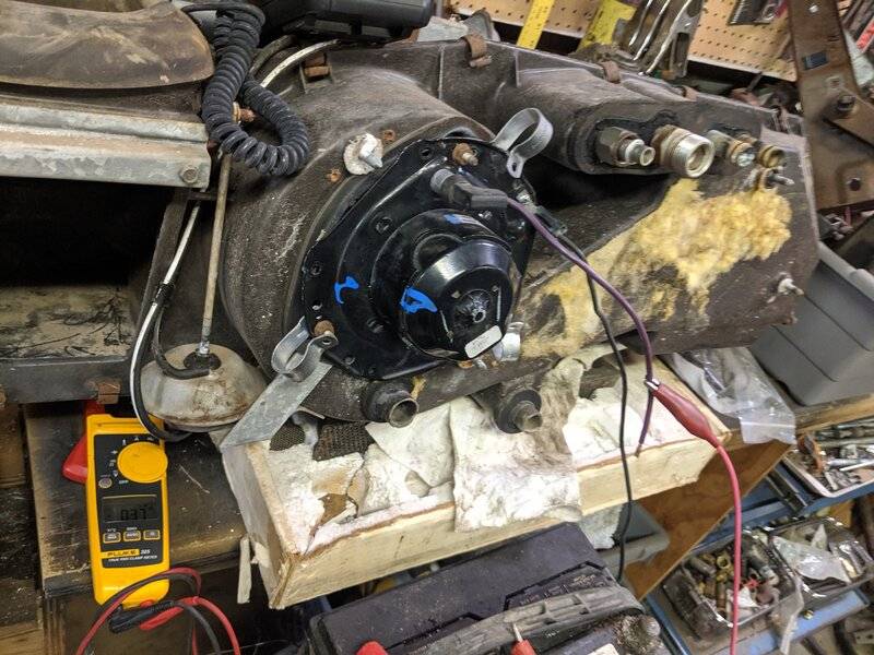

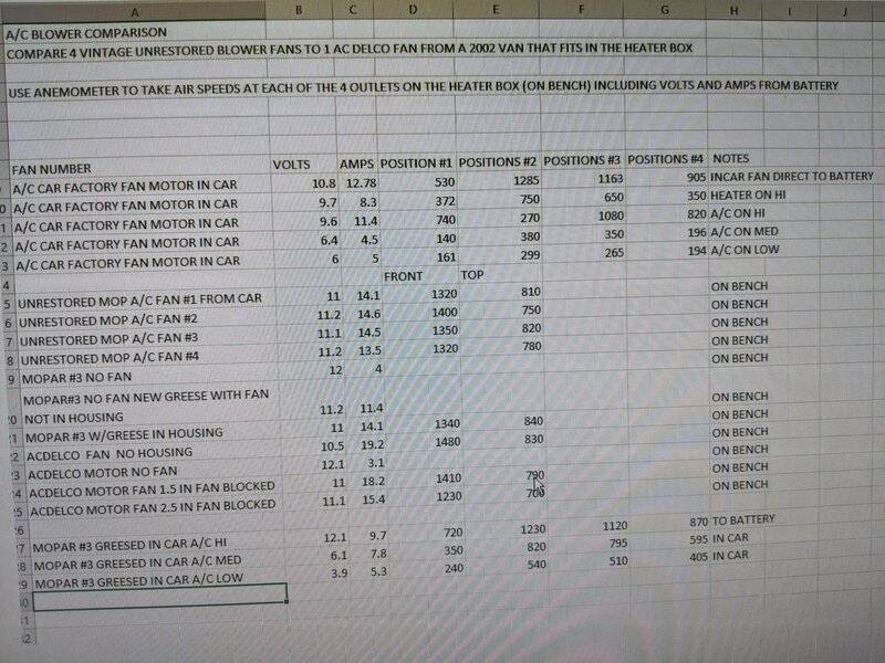

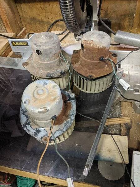

So I decided to do a test. To test the blower installed in my '72 roadrunner and compare it to the motors and the GM motor to see which one is more efficient. So I measured the airspeed out of my vents installed in the car and then I did a bench test with the AC heater box and all of the fans including the GM blower fan. I checked voltage and the amperage with the blower motor head to the battery and then on medium and low and took that motor out and that is motor number one in the chart below.
So the newer gm motor is more efficient with not fan on it but not with the gm fan wheel on it or in the heater box. the shaft is smaller and d shaped making hard to put the mopar fan wheel on it.

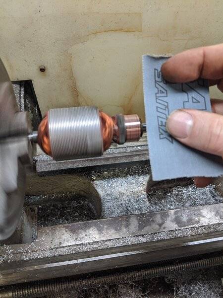

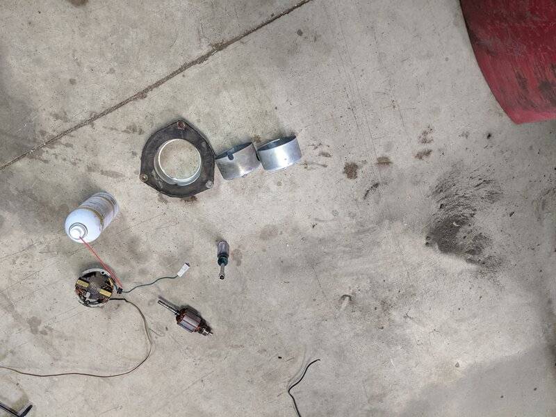

I then rebuilt the best blower motor that I tested. I took it apart and sanded the armature down and greased the bearings.
Overall just greasing the bearings did the most improvement as all of the old motors are very similar. It didn't help on hi moving more air but on med. and low the air speeds were up. Every little bit helps.
