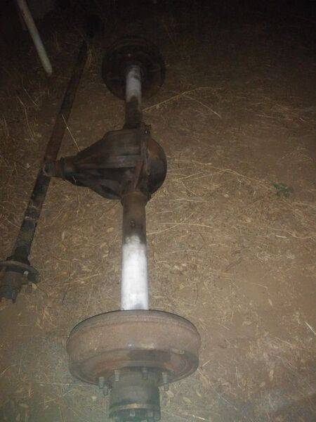

Hi everyone, I was curious if this cheap Dana 60 I found on CL could be a decent candidate to modify to fit into a 69 RR? The only info it has is: "Dana 60 with 4.10 axle ratio from Dodge D200"... I saw some posts where people cut/customized these Dana 60s to fit into B bodies.
I currently have an 8 3/4 489 29 spline rear end w/ drum brakes and S/S springs. Would like to keep a drum brake setup. I'm just not sure what needs to be done exactly, any tips would be appreciated.

If your not sure what needs to be done that will cost money. Are the axle tubes the correct diameter? Did the guy who removed them damage the tubes? Is the ring and pinion good? Will it howl? Is it for sure a Dana 60 and not a 61, 70, or 80?

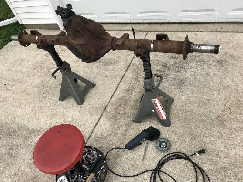

I’m doing one today... 4.10 gear out of a Ford truck. I’ve got new bearings, a spool to go in as well as a billet yoke. Using 8-3/4” housing ends. I paid $150 for it, $50 for the spool, had the housing ends, green bearings and yoke. I’ll probably order new Strange axles.

In the original #1 pix, Isn't the Dana 60 shown in the pix a truck rear assembly which appears to have a "full floating" setup where there the spindle and bearing assembly that supports the drum has a separate axle that passes thru the spindle and bearing assembly and drives thru the axle bolt flange. Is this kind still convertible to a car application? Just curious...

Yes. The one I posted was also a floater setup with the hubs and axles removed. They’re easily converted as well.

Full floaters work fine. As part of the narrowing process, you cut off the truck ends and replace with pass car ends and custom axles, both available lots of places. Its just the typical time-and-effort vs money. Save a lot of money, do the work to convert a truck, or spend the money for a new custom piece that is exactly what you want.
