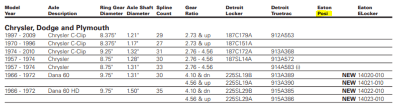

You're not running the 'E' locker are you?

Is this rear-end new to your car, did you just do 8 3/4 to Dana swap?
