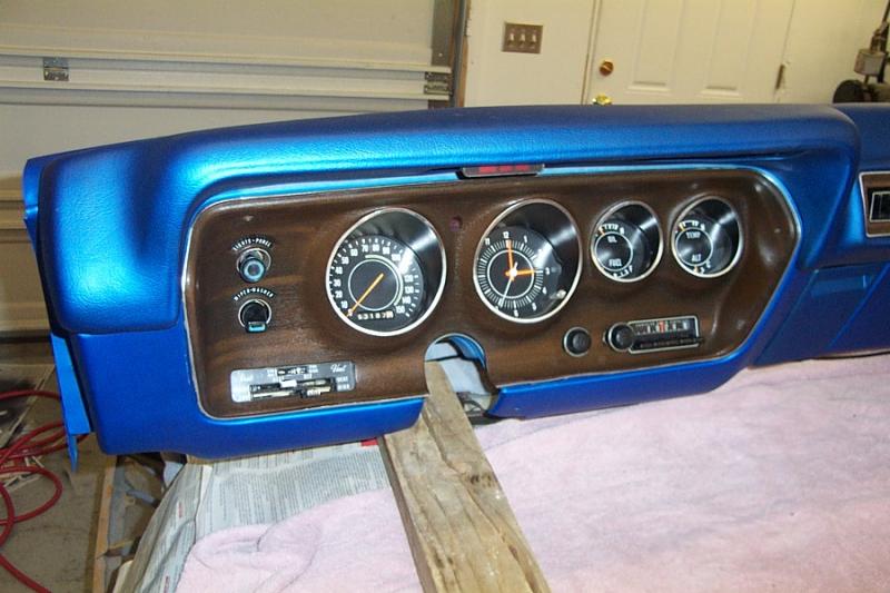

I used a silver paint pen on my no-budget beater.
I did My glovebox door with the chrome/silver ink pen and if You like silver...it's great...but if You need the original chrome look....it stinks
2.99 vs 250.00
that's true but like My friend who was building a 300k home and was complaining that upgrading His roof shingles to 3 dimensional was 700 and He was on the fence about doing it. I told Him to do it the way He wants as that if He dosn't do the upgrade,every time He gets out of His car and looks at the roof,and He will, He'll hate it. So, I want the original look, not somthing that doesn't "cut" it. Mines a driver also but I look at the dash all the time

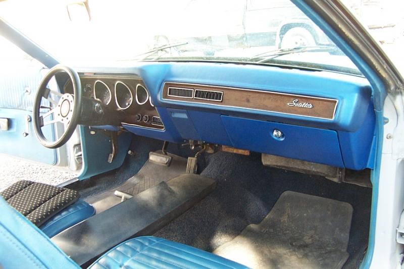

Very true but I only know of 2 options, 2.99 paint or 250.00 chrome and paint. If you want it right then have it rechromed. I'd would do this for my 71 RR but not for my 72 Satellite beater. The paint actually came out alot better then I thought it would but I don't dare touch it. Don't think the results would be as good on a 66/7 bezel.
