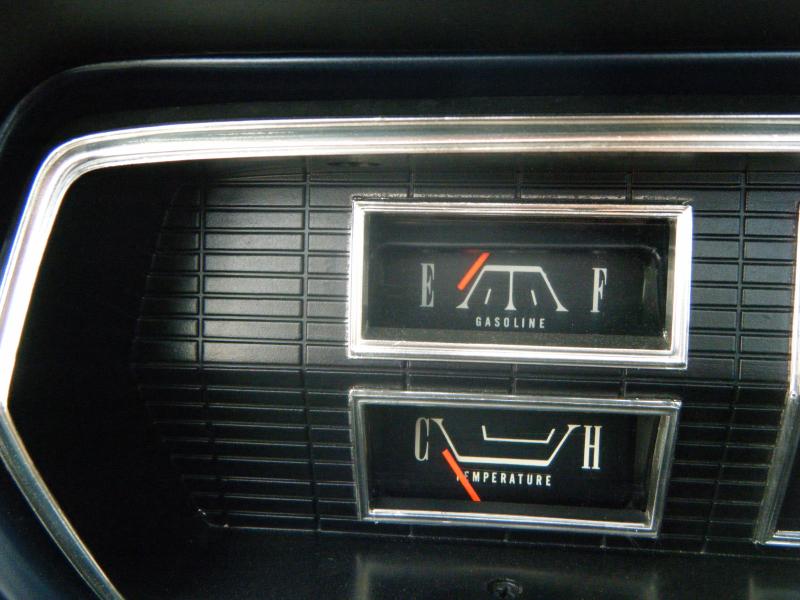

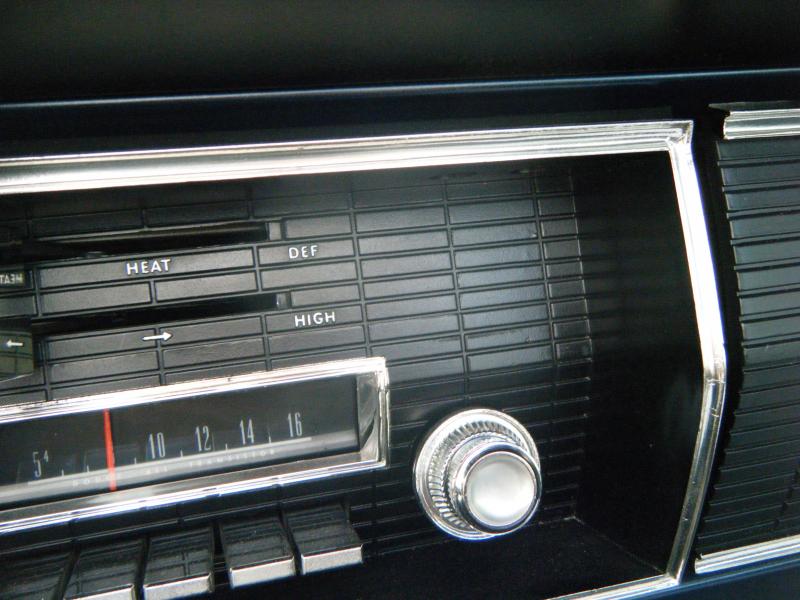

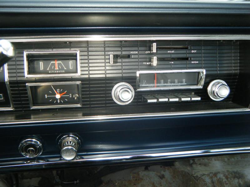

Well it only took 3 1/2 months but here are some pics of my '66 dash - chrome re-done with Bare Metal Foil.
THEMAN 440 --
What kind/brand of black did you use on the 66 Cluster?
Which did you do first - black or silver??
How did you mask it off - which tape did you use???
Actually the black on the cluster is untouched original - just cleaned up. I used white paint applied with a tooth pick for the lettering. I did paint the glove door I used Duplicolor Engine Paint, Low Gloss Black. It is a very close match to the factory finish.

I painted the glove door let it dry for a few days then I did the chrome with Bare Metal Foil - no masking needed.
Looks great.......Let us know how it holds up when the Summer gets here.....
