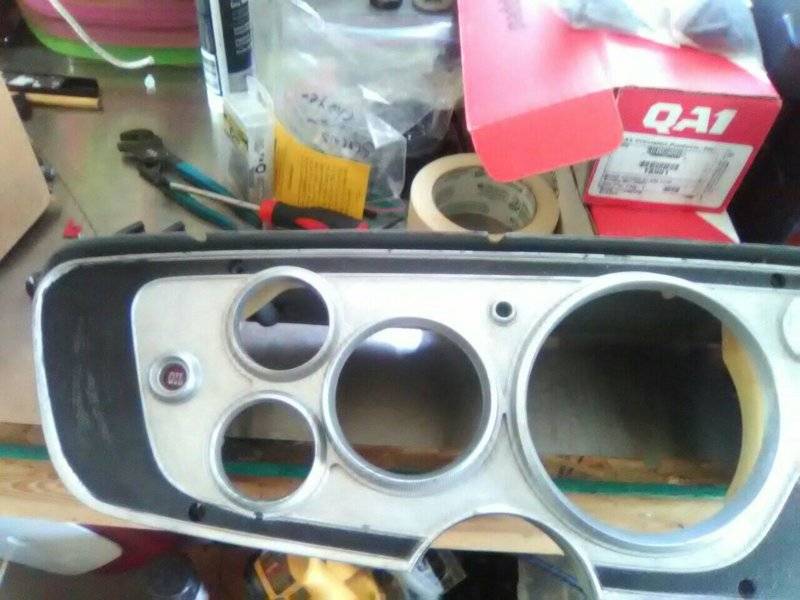

Hi,I have a question ,Ill be putting the dash and gauges in soon and fitting everything,I noticed this gap on the top of the plastic housing,is this filled in with the pad that goes on top?and does anyone have a pad for sale,are they metal or vinyl covered?our car never came with any parts for the dash so we are putting it together from scratch,thanx in advance for any info
The bezel is slide in tight under the overhead padded brow (for padded dashes) and affixed with 4 screws. I'm not sure what I'm seeing in the photo as it almost appears to be part of the brow structure but shouldn't be a separate piece from my experience (maybe post another showing the top and rear to get a better look at that). Could be from a non-padded dash. I have the brow as a set with the surrounding frame work. The vinyl padding is shot but if you have no luck finding what you need I can dig it out of my attic and send you photos of it to maybe sell.

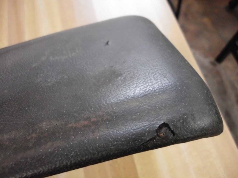

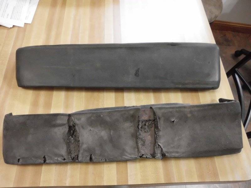

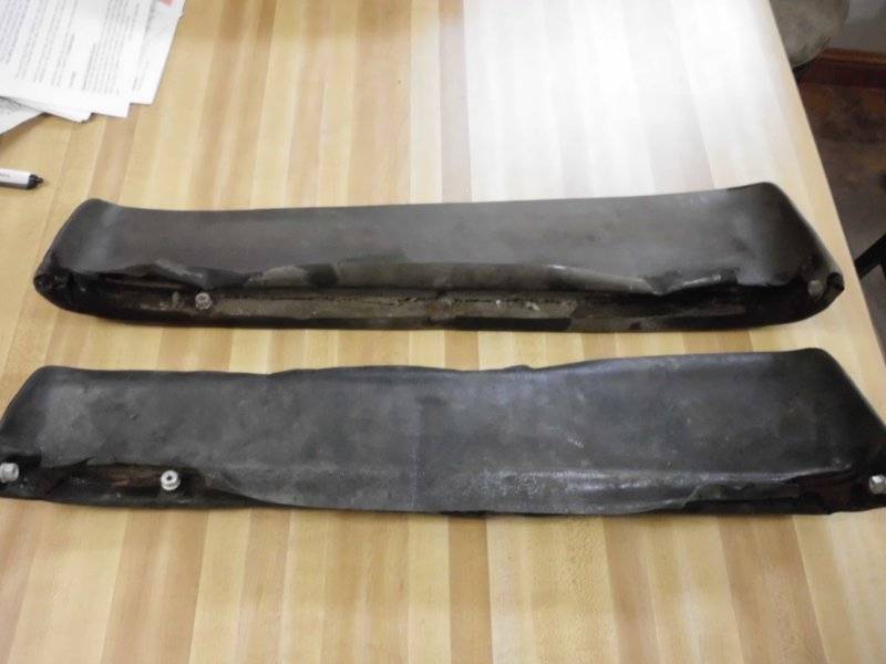

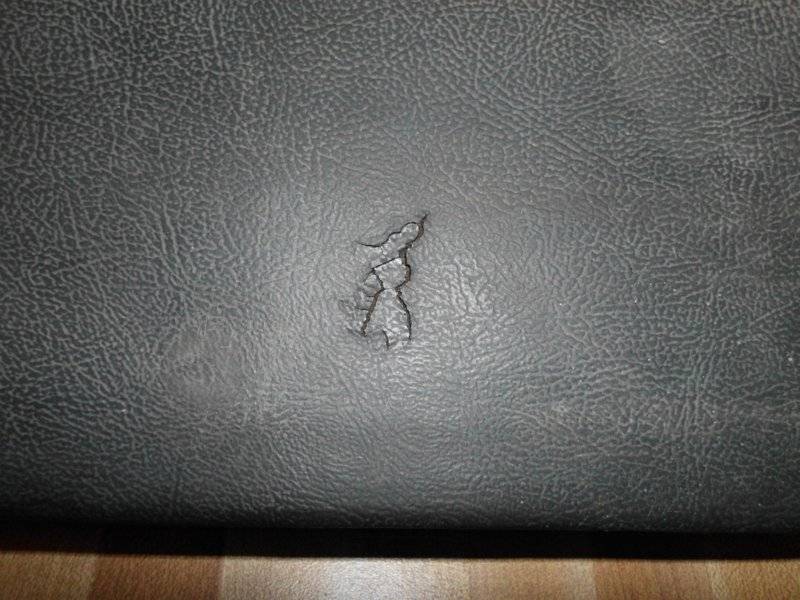

If you've not heard from the others, I've two for your consideration. One (lower) has a good frame but the foam and vinyl is shot. The other (upper) has a good frame, foam is still intact and the vinyl is in fair shape. I've shown a couple of the problem areas. This one could be made usable as is I think. Both of them have all four mounting studs intact. In all the years I've been messing with these I've not seen a used one available in any better shape than the upper one, but you need to decide what works for your needs.
First picture shows the top surface of both. Next two show the vinyl on the better one. Last photo shows the bottoms.
The upper one in the photo would be $58.00 shipped. The lower one would be $35.00 shipped. I take paypal. Let me know either way please.

The bare frame looks cool.Sorry only photo I have. It has holes in the top to bond the pad to it, if you look hard.

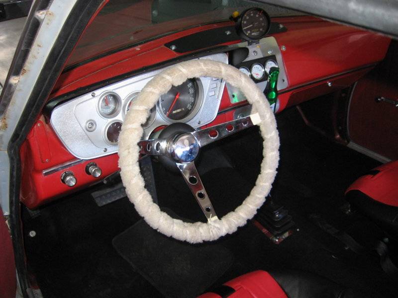

My low-buck bomb.
Yes. The car came from AZ and was sun burnt to a crisp. I soaked it in a citrus base solvent and used a gasket scraper to remove the heavy stuff,dried it and used a palm sander to clean the rest.
Great looking dash, much better than my '63. Not to detract, but...aside from optional seat belts, the only impact protection in a 63 was the padded dash.
