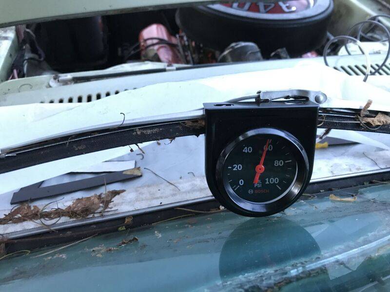

Now the oil light remains on. This is regardless of whether the engine is idling, revved in place, or put under load. If it's firing, the light is on. I wasn't terribly concerned as there were no audible indications of clicking hydraulic lifters or other low oil telltales, and to be on the safe side, I plumbed in an el-cheapo Bosch oil gauge temporarily and got 58 lbs of pressure at idle. Nothing to worry about.

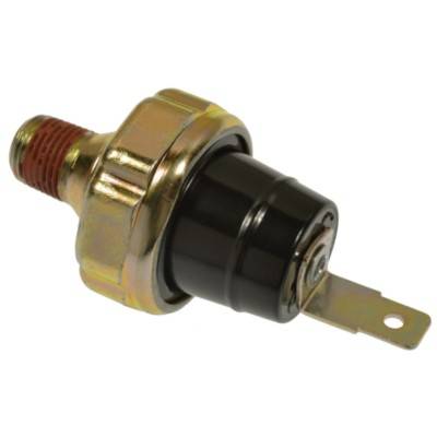

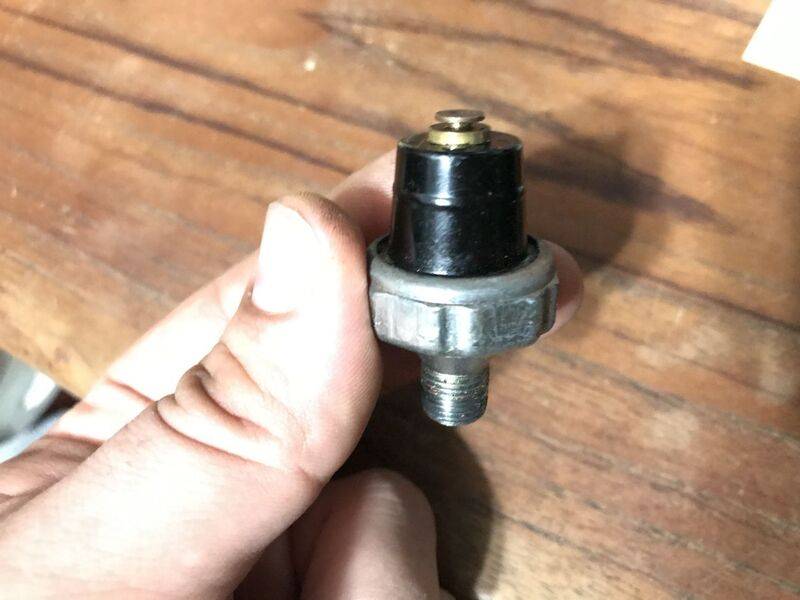

I'm guessing that I probably just need to simply shove a new sender in this thing and call it a day. I'm really tempted to dump the factory connector for a sender with a vertical spade connection (such as the sender type used on '56-87 Chevrolets). The round top is never going to be as reliable as a flat spade connection.

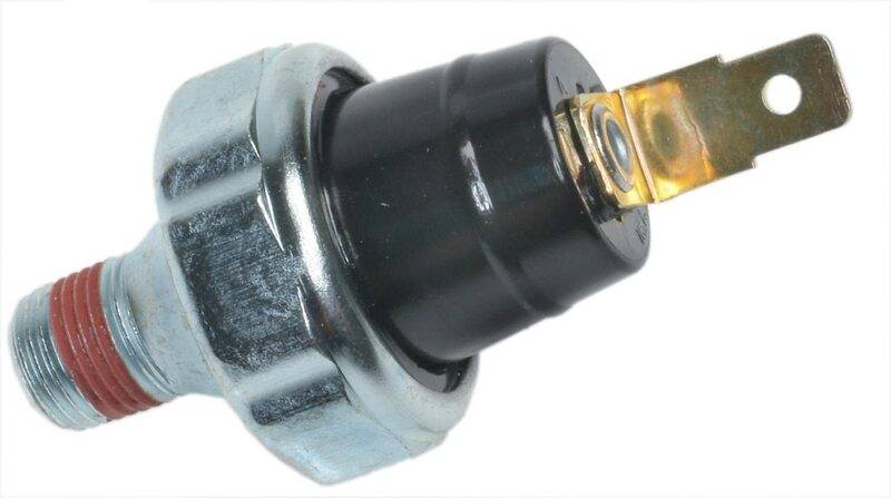

Just ordered an ACDelco C8020. Used in a number of Chevy 350's and AMC applications (and the '88 Plymouth Voyager...whoopee :rolleyes:), has the proper 1/8" NPT threads, looks mostly the same, but has the connector I want on top.
Just FYI, for anyone looking to do the same, avoid the AC Delco U8001. It looks exactly the same, but it's 1/8" PT/BSPT (28tpi), not NPT (27tpi) and designed for Subaru applications.

The Delco C8020 has been installed and it's working perfectly.
Thanks to all for the advice!
Both senders require the same female connector.
That is true, but the button-top sender wouldn't clip into the spade connector properly. It didn't matter whether it was with the repop connector or the generic spade connector that had been crimped onto the wiring harness by the PO.
The Delco may look different, but at least it locks in place the way it should.
