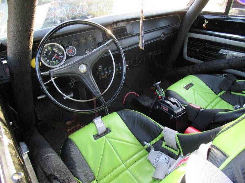

Do we have to remove the windshield and dash to change the upper dash pad???

That said, you have to remove just about everything else in the dash, and with that cage, it will be much easier to just remove the glass.

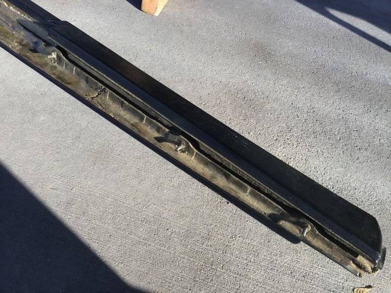

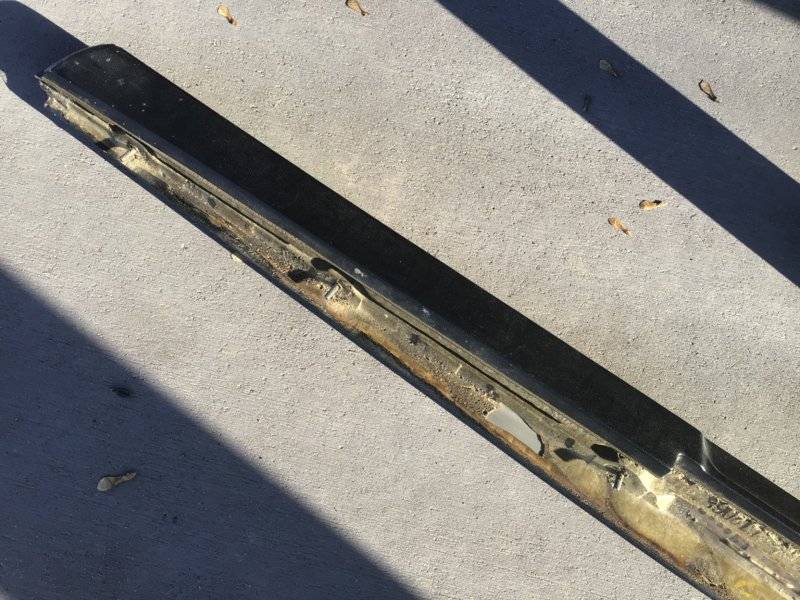

There are 6 studs that point to the front of the car. So cluster and glove box liner out will make it a lot easier. Studs are about 5/8” long.
A smaller limber person is very helpful, like a gymnast or a yoga teacher! LOL
Nothing easy about hours spent removing the windshield and dash. I wouldn’t do it. Work on it some and take your frustration breaks when necessary.
A2D273A6-4200-4CDA-BA17-EB5F2906C928.jpeg 267F6883-C30A-4F40-84C4-3D139AC7601A.jpeg
Remove the seats and shifter so you can lay on the floor then you can reach the nuts from underneath the dash with a long extension or two or three. It’s not horrible and it beats risking damage to the windshield.
