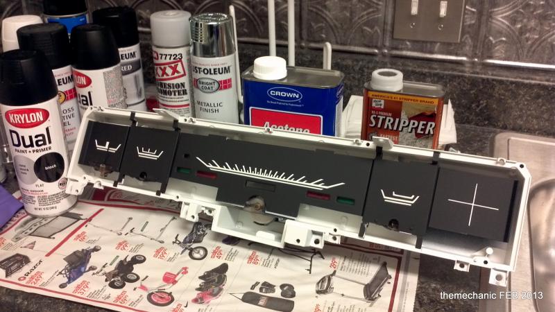

I used them on my 1969 Coronet R/T gauges. I removed the needles, stripped the paint, sanded, washed/degreased, painted with Krylon Dual flat black about 3 coats. Dry for 24-48 house then use the paint masks. Extremely hard to align. Epecially the speedo mask. I learned how to cuss again! I used Krylon Dual Satin White for the raised portions. I also sanded the housing and painted it with Krylon Dual Satin White.

Here's a picture:

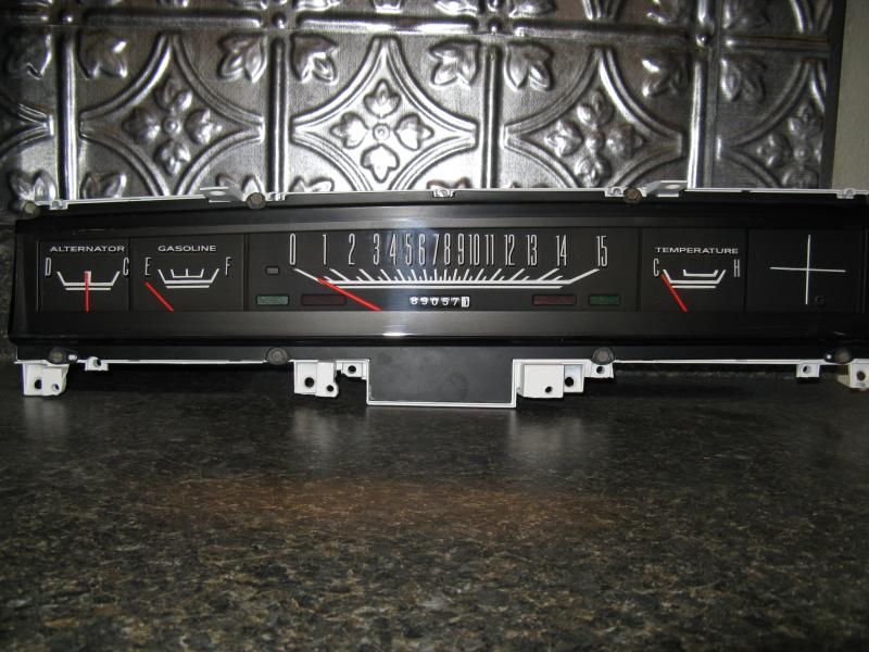

Here's a picture:

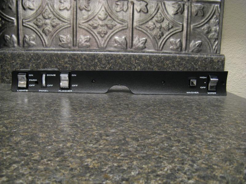

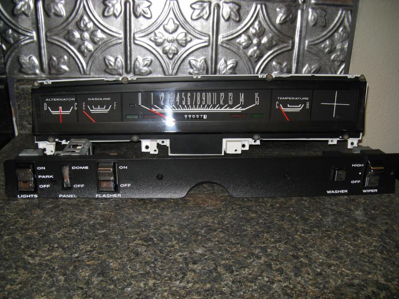

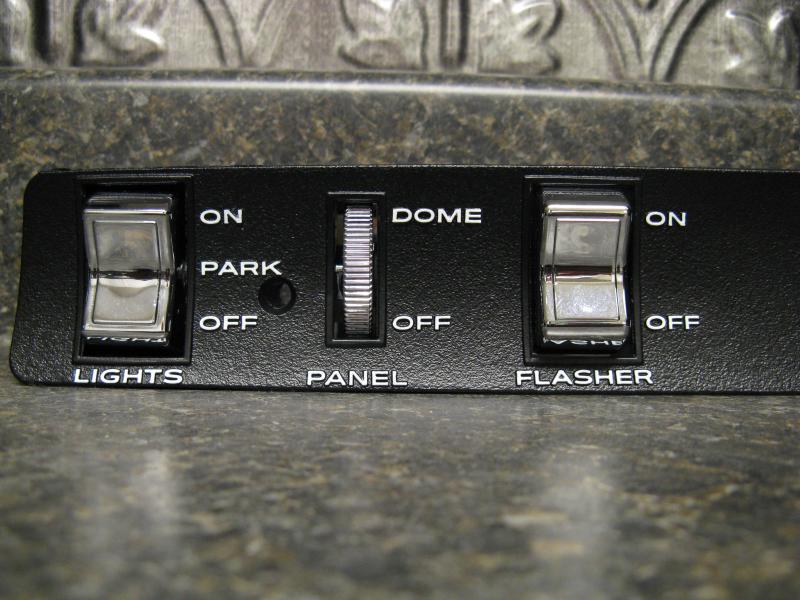

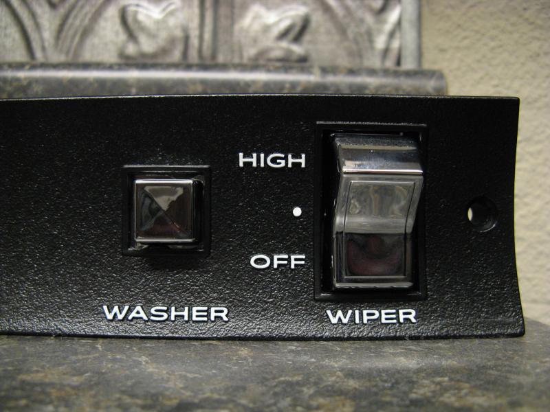

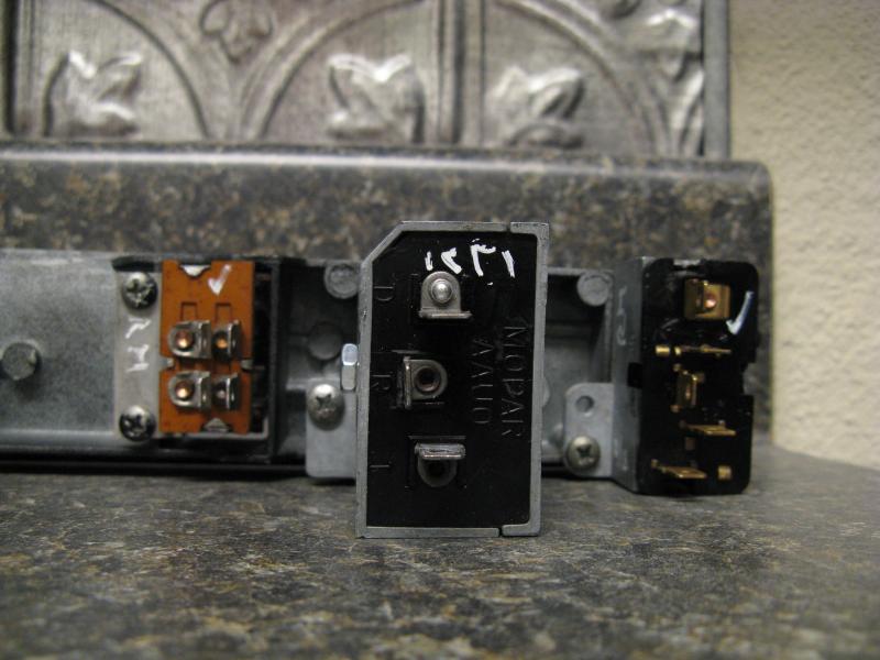

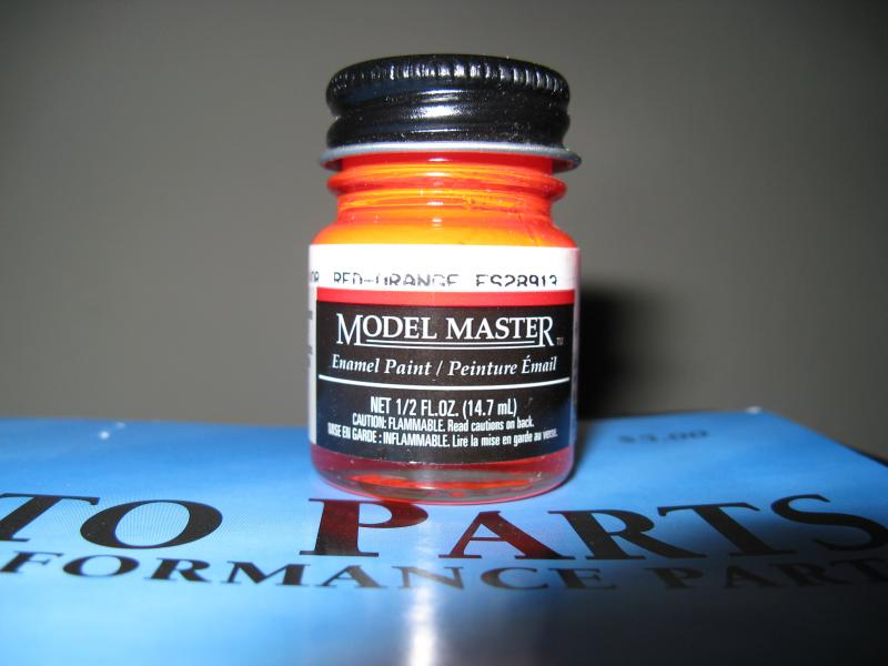

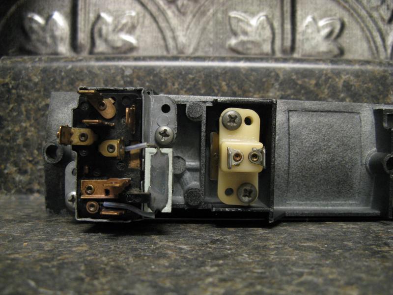

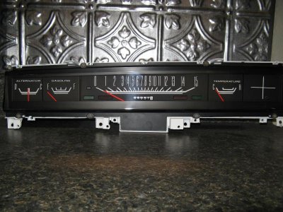

Finished. Good enough for daily driver. I used Model Masters FS28913 Red-Orange for the needles over a white base coat. Switches rebuilt by Devin Duke in California. He was the most reasonbly priced. He has a store on ebay as devinism. Here's a few photos.

I just finished mine as well for my 73RR!!!! plus added all new gaskets for the turnsignals, light switches etc, repainted the needles and "chrome" trim.
Looks fantastic! Now I'm jealous and have another weekend project for my roadrunner.
Very nice!!
