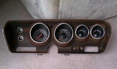

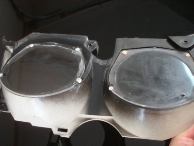

I just finished the dash restoration on my 72 SSP.
The clear plastic lens over my gauges where all scratched and somewhat yellowed. I used a headlight polishing kit to restore the clear lens and the results turned out great.
I used "Mothers" headlight polishing kit. I followed the directions using the wet sanding techniques in the instructions and then polished three times to achieve a crystal clear finish.
The pics show a before and after side by side comparison. The only issue that I had was the clean-up after the process was complete. The wet sanding residue did get between the lens and the housing but I just used a paper towel and gently cleaned in between the lens and the housing to remove the residue.

Looks great!
i'll have to remember that tip in the future.
Huge difference and looks great! Wish i would have known this 8 months ago.. Good idea!
A great improvement! Really takes the years off, doesn't it? I'm in the process of restoring my '70 dash, I'll show that when it's done.
Great tip! I use it. Getting ready to so the dash on my 70 Coronet R/T. Thanks.
Excellent job and it makes it look like new.
Did you have to use a buffer or just hand buff it?

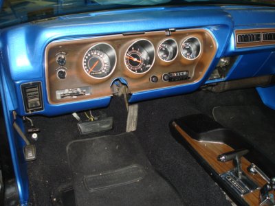

I just finished mine as well for my 73RR!!!! plus added all new gaskets for the turnsignals, light switches etc, repainted the needles and "chrome" trim.
Ron of Chicago asked if I used a buffer. The Mothers headlight kit comes with a buffing pad that you chuck into a drill. I used that to buff the plastic along with the polishing compound from the kit.
Another tip that I can offer.

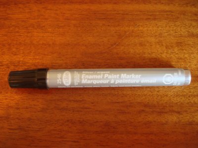

I read several places on other threads about using a silver Sharpie marker to touch-up the silver accents around the dash. I tried the Sharpie but didn't have any luck. I found that a paint marker from Testors works great. I bought my marker from a local hobby store. The color is Argent Silver. I lightly sanded the edges of the dash with 400 grit paper, where the silver color is, and used the paint marker to apply a nice coat of silver paint. I found that 2 coats of paint work best.
The marker is easy to use and gives a crisp clear line.

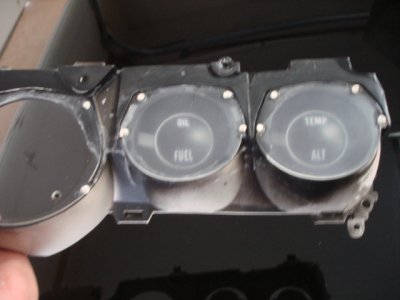

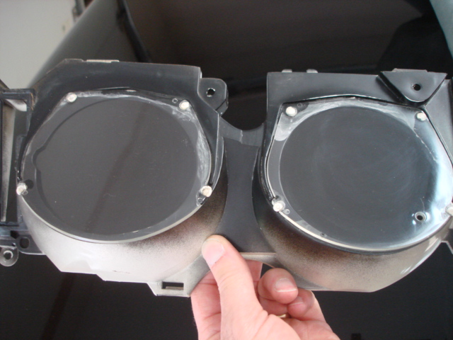

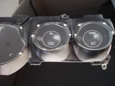

Just and FYI, if you use a very small (Jewelers) flat screwdriver and a little patience, you can pick away at the melted plastic that is holding the lenses in place and gently pry them free without cracking the original mounting posts. This allows you free access to the lenses to polish by hand or with a benchtop buffer set up.
A tiny dab of silicone sealant/caulk on each post will secure the lenses once you've got them cleaned up...also allows you to repaint the plastic housing black without having to mask off anything.
