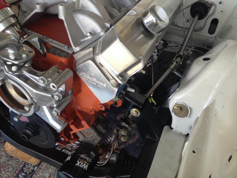

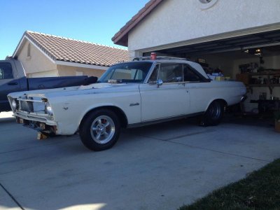

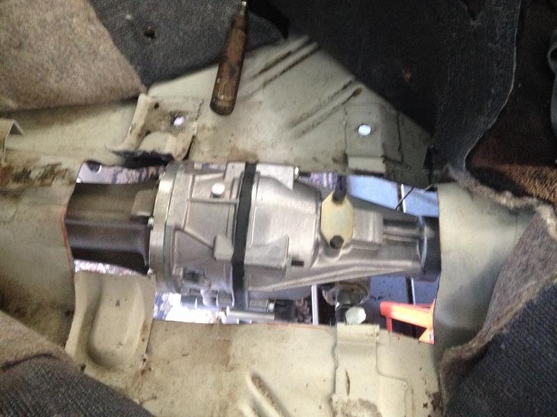

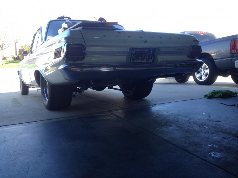

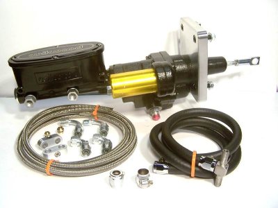

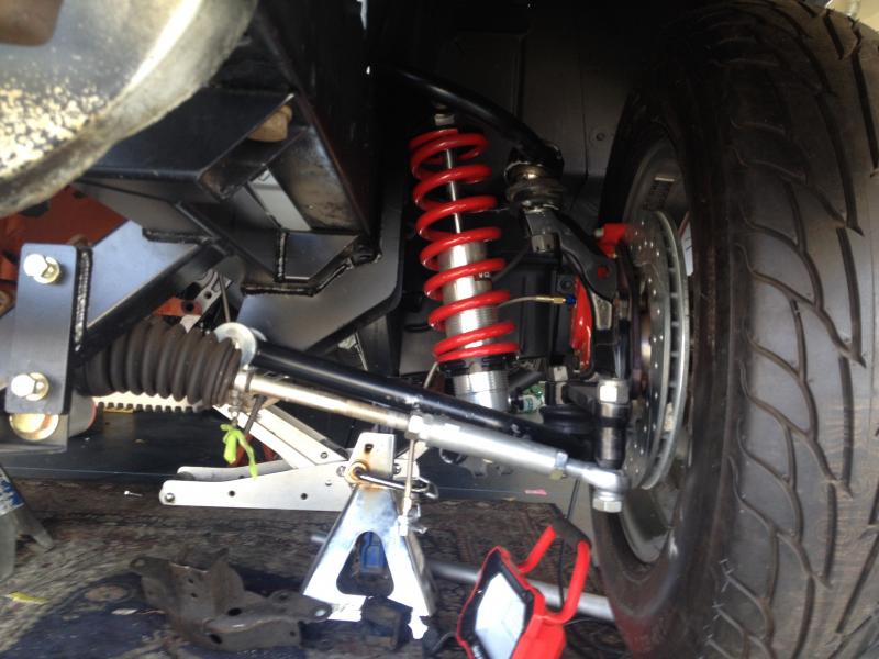

I'm leaning toward street fighter... what do ya think !!
it has;
440 With 550HP/600TQ~Gear Vendor Over Drive~RMS Front Suspension~Hydroboost Braking System~Cal-Tracks
[/B]
Just installed mine and still sorting it out as now for some reason the pump is whining off its head and its takes neally half the pedal depression to make the brakes work.
Is the pedal adjustable? Also did you put a tee in the return line or add another bung for the second return Line.
I have an adjustable rod for the brake peddle so I set it at the top. I put a second bung in pump reservoir.When I had the tee in the return line the power steering didn't work.As soon as I added the second return line bung everything started working.
i added a second bung into my custom made reservoir, the brake pedal rod is adjustable yes
