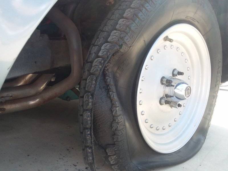

Ignore the destroyed tire. Note the header tube routing. 7&8 go through the wheelwell.
Mine have cyl#1&2 flange cut and trimmed, along with 7&8. Each side becomes a four piece header, front tube, two center tubes, and the rear tube, and collector. The holes in the fenderwell are cut big enough on my car to put the flange through the wheelwell after the engine is in place. Other wise the header tube would have to be in place before the engine is dropped in.
