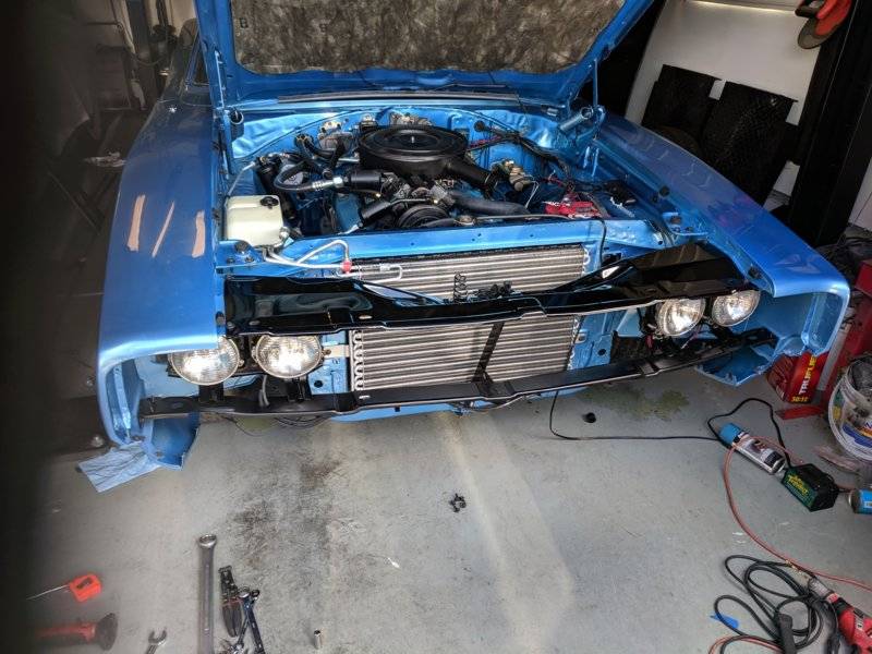

The grill has been backordered since Nov...

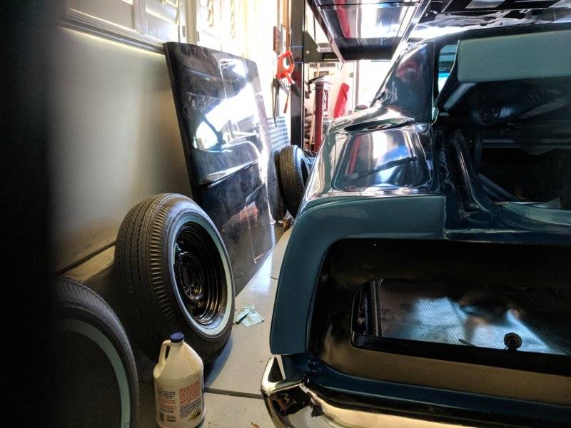

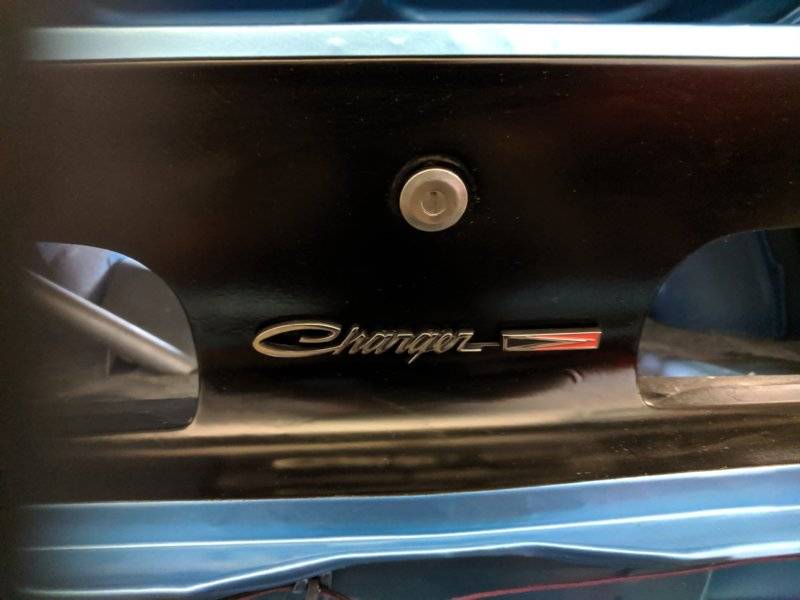

But decided to put the header panel in

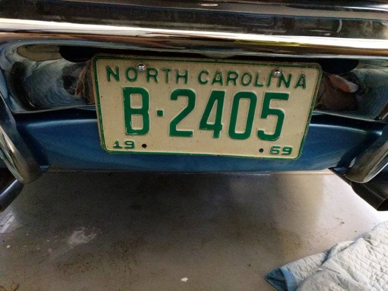

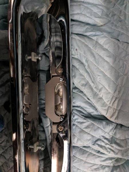

And the bumper... Needs adjustment but...
But my helper is back out... And not one bit mad at me for scratching his car... cause he knows I will fix it...

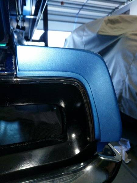

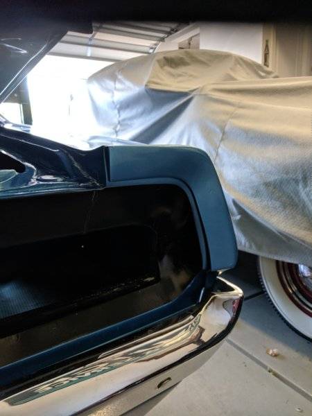

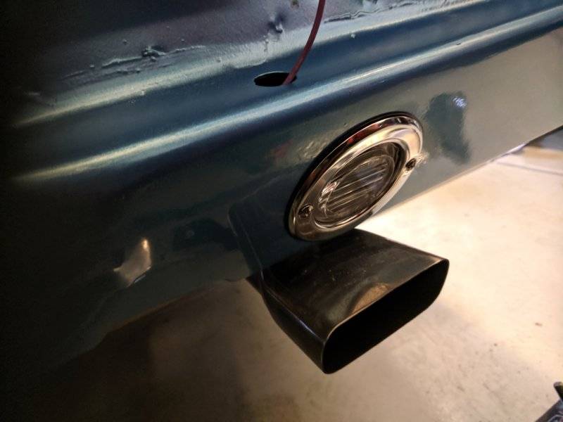

Quarter Panel Extension never fit good after the crash... Still fit like crap and barely held on. Snapped a stud on the left one... definitely one of those days.
Once again wishing I did my own metal and paint work...:mad:

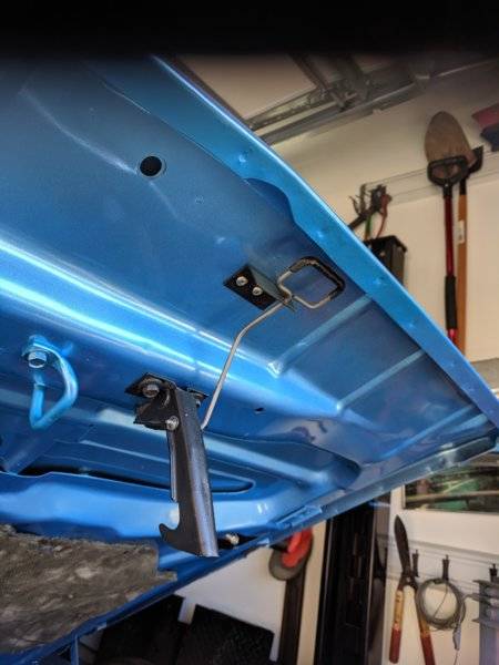

I slide a deep socket over the drill bit when trying to do things like that. Controls depth and gives the chuck jaws a surface to spin on that isn't painted.
