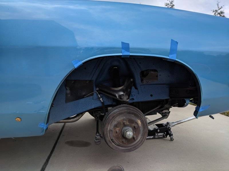

Had to drill the repro fender for wheel mldg. Decided not to install cause there is a run that the painter will need to wet sand out when they buff.

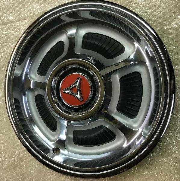

Going with wheel covers yes. Not the ones per the build sheet (which off my head I think were W11's), but these. I had them repainted by TotallyAuto they arrive back via UPS Monday

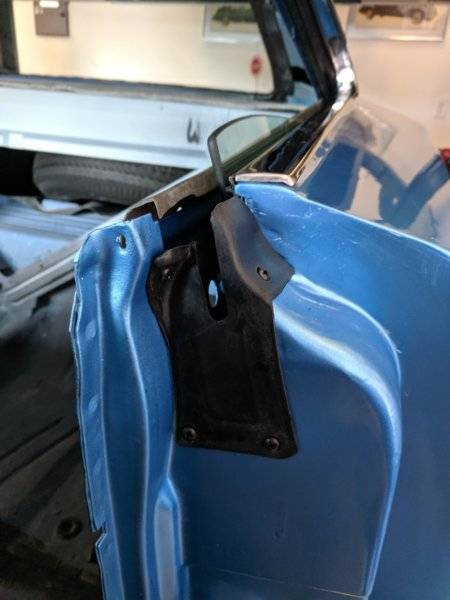

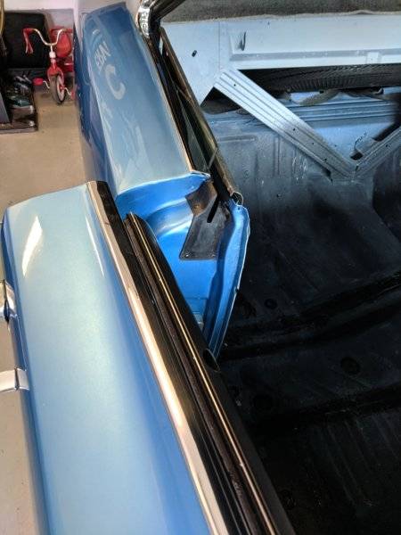

Window adjusted. It is much better but not quite where I want it but I'm out of adjustment in the screws. Repro glass may he a bit more curved or something. It's weather tight so gonna go with it.

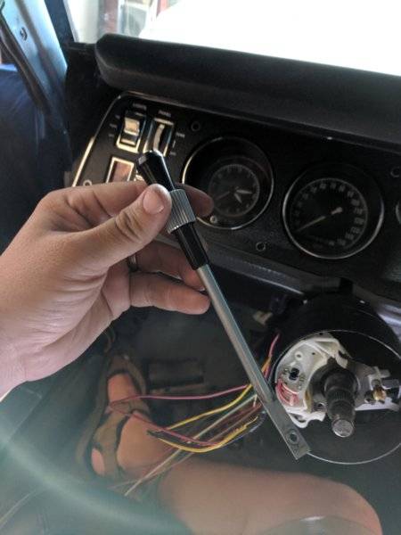

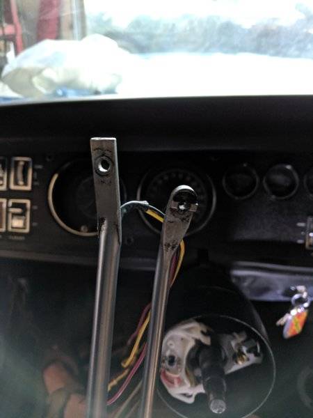

While I had the whole column more or less torn apart I figured I would put in the cruise control indicator arm I bought. Though I have no other cruise components yet. I intend to aquire them.
So threaded the wires down and went to install and all went good until I moved the indicator to make room for the screw driver to screw the turn signal switch collar down...nothing moved.
The non cruise indiactor arm is threaded and has to tabs to move the switch. The cruise indiactor arm is not threaded nor does it have the tabs. Yanked that back out and will have to research that more. Oh well. Minor detail. Right one is non cruise, left is cruise:

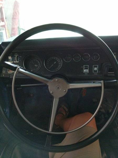

New repro steering wheel with no cracks...another first in my ownership.

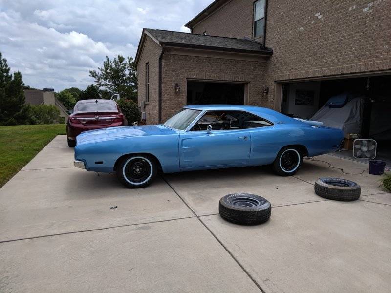

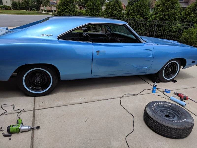

I pulled the car out so I could get the door open more to look at the brake. I see no obviously means to attach a spring or otherwise enure the brake returns 100%.
Prior to checking that however I thought the engine sounded bad. I opened the hood and noticed the fan assembly moving out of balance significantly. Sorry video is too large to upload. Will try to put it on YouTube.
Anyway. I think I found my coolant leak on the front side. New water pump will be procured.
I didn't want to run the motor to get it back in and of course, the rain that was holding off, didn't hold any longer ... My pitcrew helped me put it back in...

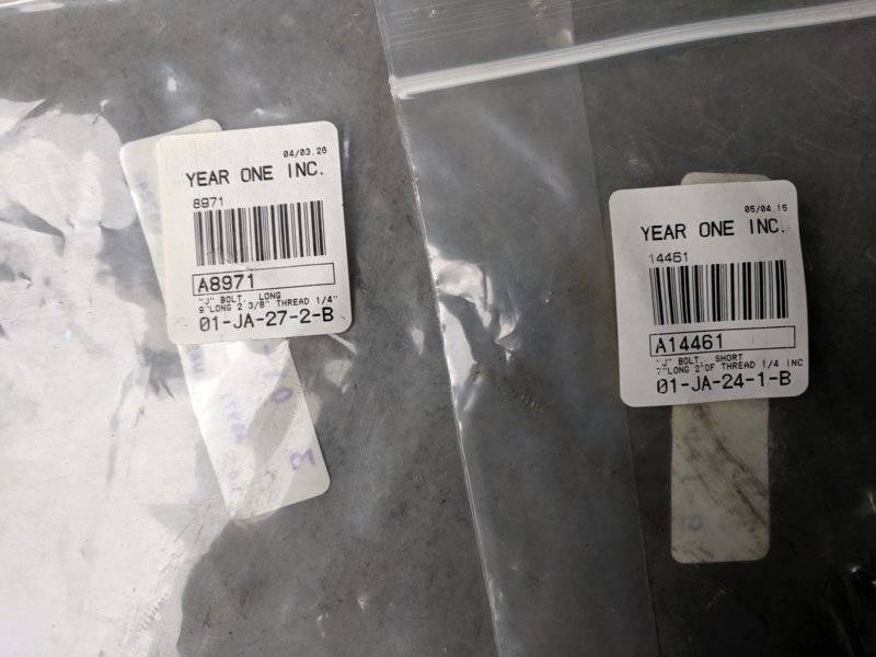

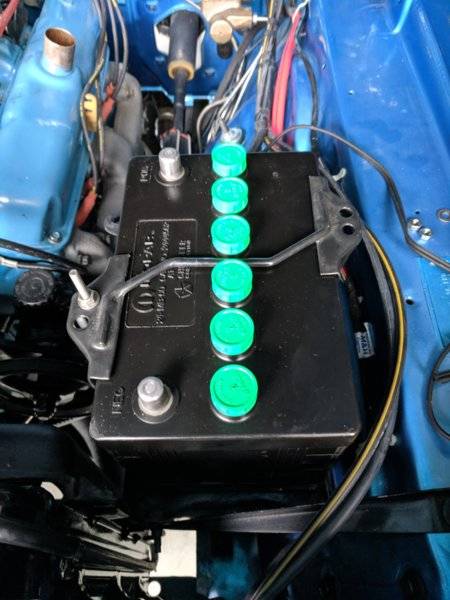

Battery hold down. It seems way back 10+ year ago when I bought the battery hold down I got a short and a long j-hook. Well the short doesn't work.
And then problem #2 is the the battery covers most of the hole in the bottom which I assume is the second j-hook location. Also feel like that one the hook would be on the top as it likes to fall out, but then you can only tighten on one side...more research...and another long j-hook.
