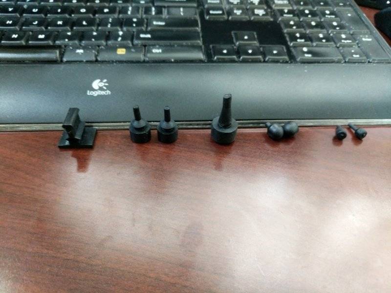

That leaves these looking for homes.
The console does NOT use bumpers.......

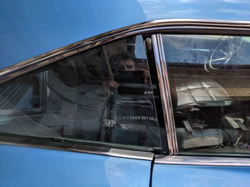

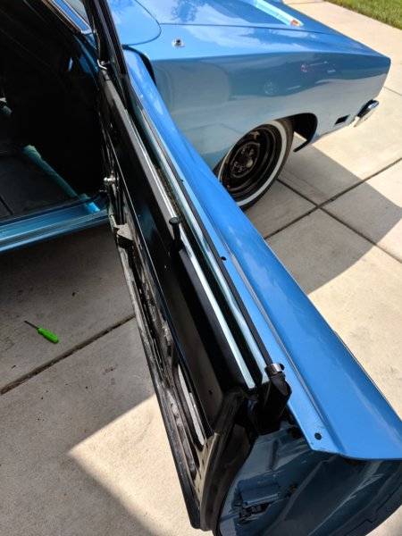

Passenger side window is in. God that was painful.
I learned several things that I'd like to share
1. I tried @moparnation74 's trick with the black magic and it definitely helped on the track this time, plus having the vent window in the car helped, but still wasn't perfect and still did some damage to those plastic track weatherstrips (those things are just awful).
2. I had to loosen and completely uninstall the track at the back of the door and then reinstall it once the window was in.
3. I did not realize the rivet and regulator track thing couldn't go on the window until after it was in the door, but also i should put the track thing on the roller of the regulator first then bring it up to the window and then rivet
4. The door fuzzy with larger stainless edge should go to the inside. I had them backwards

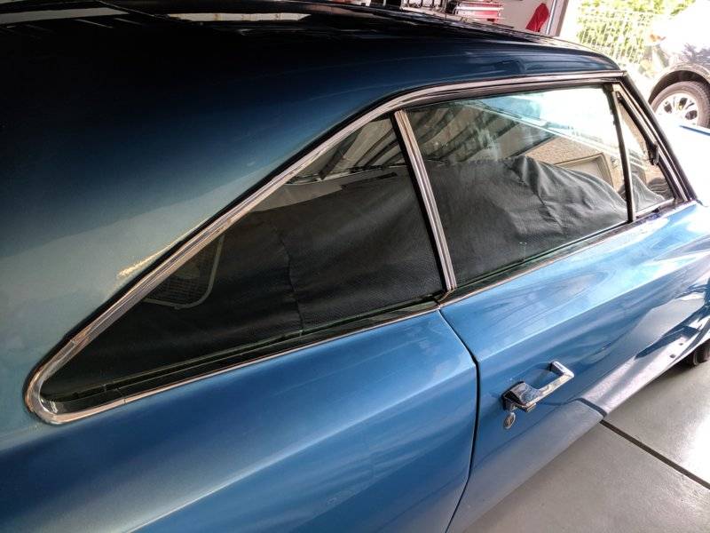

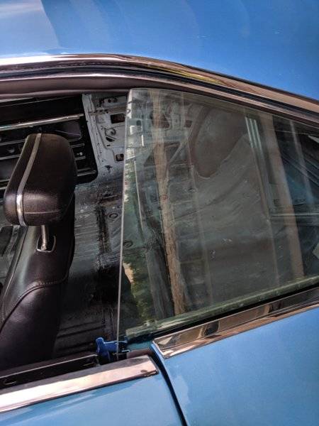

However my rear quarter window is still well out of adjustment
Drivers side is good, look how much further it overlaps the door
If you recall I stated that this is one area on our cars I despise to tackle......It took me a handful of restorations before I was decent at installing them....They are a royal PITA.....
I tape, double, triple quadruple tape....
Got an early start today to beat the heat, plus family plans today. Got the RR 1/4 window adjusted. Found I needed to slide the regulator forward (though I had installed it back where it was based on the primer showing previous bolt locations).

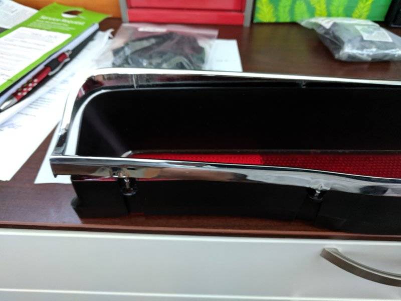

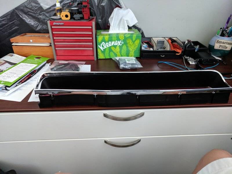

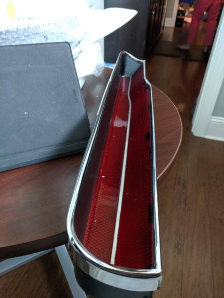

Finally got my repro tail light bezels after 3 month back order... Wow is the right one bad...
Left one is better.
I will epoxy them in I guess

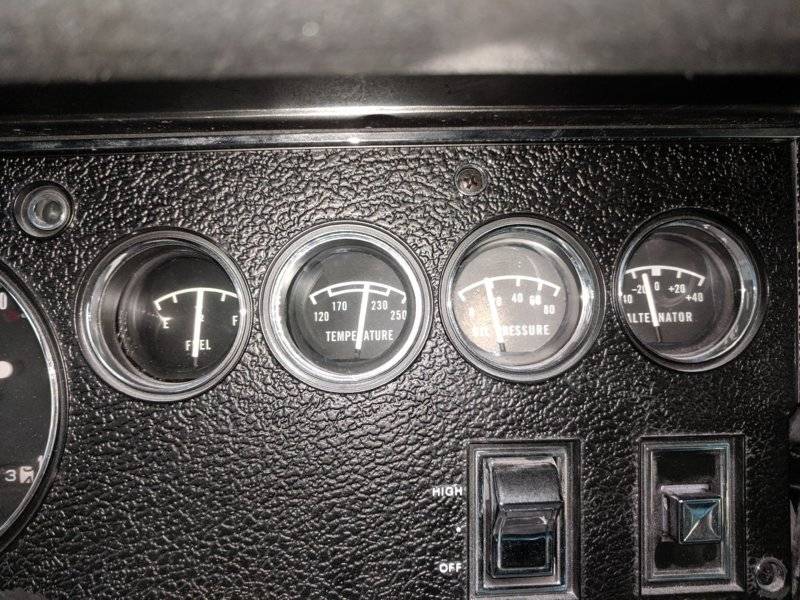

I did figure out my gauge issue and corrected that.
Went out for a highway shake down today
You can't really hear the backfire off throttle, but and it is running not perfect at ideal. Kind of felt like it also needed to shift another time as it was running about 3500 @ 65ish.
Here is the gauge reading at the end of the drive. Temp held steady, oil pressure I thought remembered it being higher, but it never really deviated from that reading so... The discharge has me puzzled as well.
