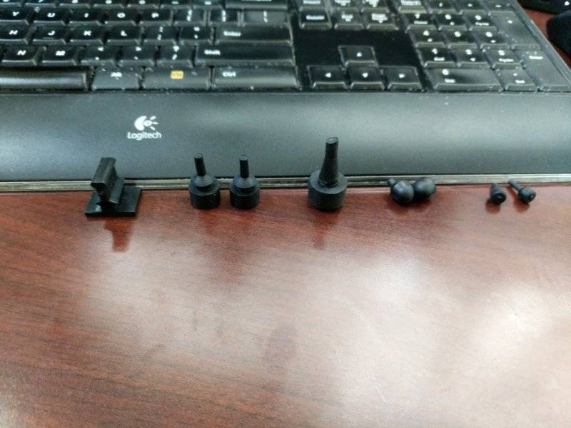

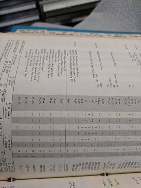

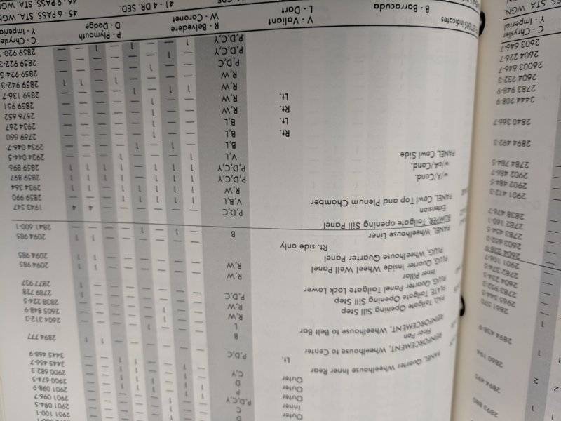

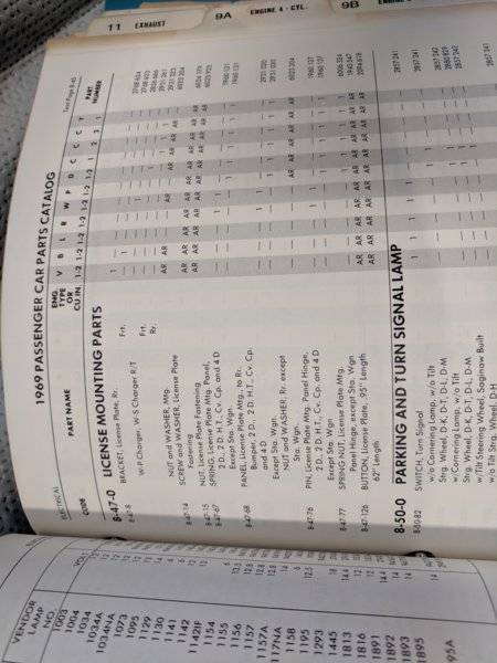

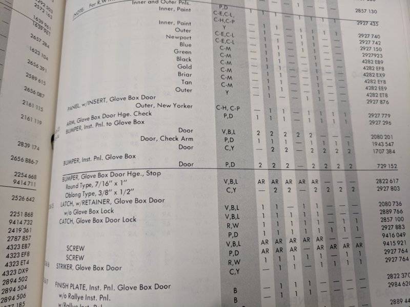

Chasing part numbers a bit I got
below 2094618 at 23-32-51 top most line rear panel bumper for a wagon
another 2094618 at 8-47-126 a license light bumper 62" inch and above that part number 1943547 for a.95" length
below 1943547 at 23-06-14 Bumper inst panel to glove box door, check arm
below 1943547 at 23-32-51 bottom most line rear panel bumper for a wagon
below 1943547 at 23-34-52 tailgate wagon
so all said clear as mud
Made some executive decisions

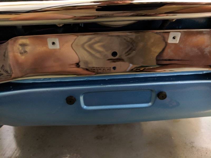

The ONLY ones that fit in the rear valence are 2094618, but not sure if there is supposed to be one in one of the two holes in the bumper? Perhaps the lower hole.

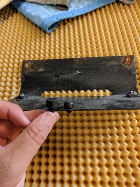

I grabbed the old front plate which still had the bumper in it and determined 1943547 goes there.
So as for the remaining two 1943547?? And two of the FK216'smmatch the hood bumpers on the fenders back at the cowl that I already have
I'm pretty sure when you order these kits they sent a lot of pcs that don't necessarily get used on every model. That being said could they be for the ash trays?

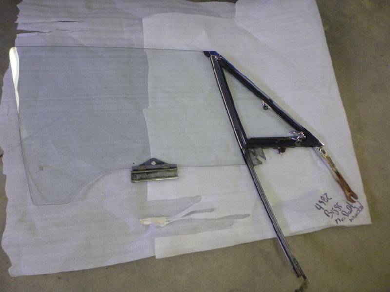

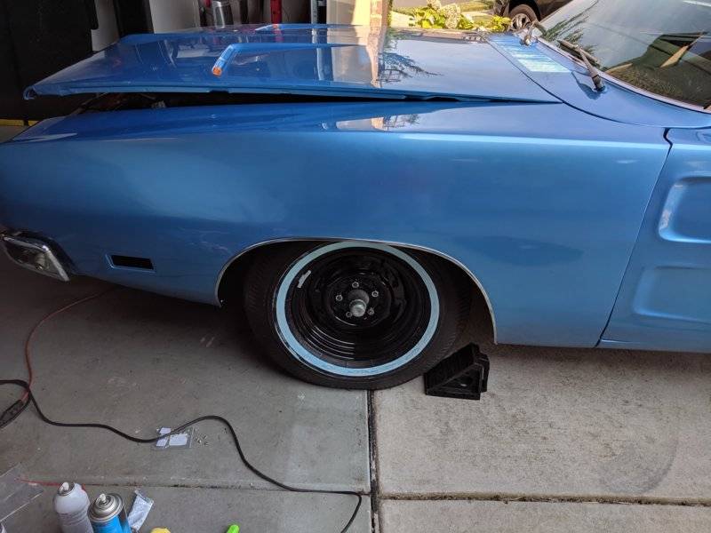

Well passenger side vent/side window installation wasn't as smooth as I was hoping.
First I installed the rear tracks in both doors.
That went relatively fine, had to figure out what I did with the hardware but otherwise fine.
Then I tried to install figure out how the side window goes in the vent window track but all I succeed in doing was killing the crap plastic weatherstrip thing.
Then went to install the vent window and discovered I have hardware for one side only...hmm...
But got the passenger vent window in.
Will have to order another set of weather strip things (maybe 2 sets). and try again on the side window
Screws in prior to headliner install so the can be found later.
Also note I marked the location of the clips for the windshield trim in washable paint marker.
Another keep busy item...wheel mldgs.
Could do one side, the other side has some runs near it that need to be wet sanded out so left the mldgs off.
So worked for about an hour today trying to get the trans linkage adjusted. I must be doing something wrong. I can get it to go in to park or into drive in the correct location but not both.
If I follow the shop manual I can get park but not drive.
If I get drive, neutral is at reverse and reverse is at park and I cant get park and I've adjusted the linkage every which way. For the purposes of shake down and drive to upholstery shop I chose the drive option and will use neutral and the parking brake for park. If I cant figure it out I can also drive to the transmission shop that rebuilt it and let them adjust it
drove around the neighborhood, got clean crisp shifts and even a kick down (though I haven't adjusted that). Think the carb needs a little adjustment and once I get the linkage sorted out should be in great shape.

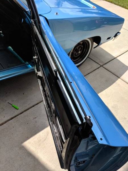

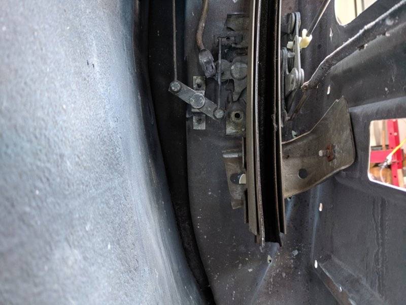

Passenger side window is in. God that was painful.
I learned several things that I'd like to share
1. I tried @moparnation74 's trick with the black magic and it definitely helped on the track this time, plus having the vent window in the car helped, but still wasn't perfect and still did some damage to those plastic track weatherstrips (those things are just awful).
2. I had to loosen and completely uninstall the track at the back of the door and then reinstall it once the window was in.
3. I did not realize the rivet and regulator track thing couldn't go on the window until after it was in the door, but also i should put the track thing on the roller of the regulator first then bring it up to the window and then rivet
4. The door fuzzy with larger stainless edge should go to the inside. I had them backwards

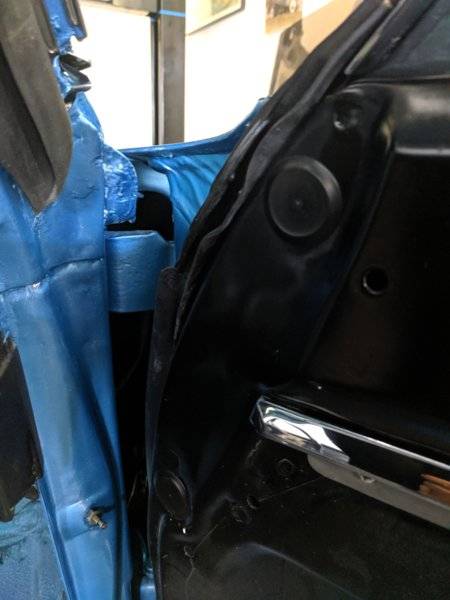

However my rear quarter window is still well out of adjustment
Drivers side is good, look how much further it overlaps the door
Your wife needs to hold the other end.. I learned that chipping the paint on the drivers side solo !
