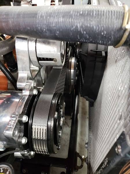

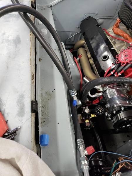

Compressor and belt installed: A/C lines test fitted
ACvnlWx9yPmXfIUwZN0JSDp8eAhYbuIXonWDgxljjGHMf2SstZRvLbeVryWXy7G7UUZhDT50rMtuIERXCXg=w693-h923-no.jpg
RHAg73bYq1htQ3MY6BInJEkCImu5QAqzBI8KhI45CPl3_pv9uLy1JAsy5ehdvF6wqubSkUSToKcop_LIK5Q=w693-h923-no.jpg
JrTfVMwGP1UEkHKrh9yTwIZgv1pBWA1Yr6AJSJNV70Elr3E98MU1lSGRRBkKm_gNi-kfXWOmZxywi4YfBQw=w693-h923-no.jpg
Lots of great progress, sounds awesome too! Must feel good having it moving under it's own power haha. Keep up the great work.

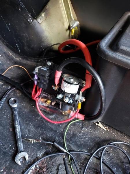

Farting around with stuff until the weather clears for the headliner and Windshield. Installed a Battery Cut-Off. It is an RV relay and requires no power when on..

Cool! Do you have a part # for that solenoid? I used a auto style for my ATV winch but burned it up because it's not meant for extended service. You might want some rubber boots over the hot terminals to keep from accidental shorting.
I need to shorten that cable and I have a boot for it when done..
INTELLITEC 0100055000 Battery Disconnect Relay
by RV Parts Center
Learn more: https://www.amazon.com/dp/B072N8NYN2/ref=cm_sw_em_r_mt_dp_U_s4RACbH0RMNW0
There is some wiring info in the reviews which is SUPER helpful..
Yep... I like it to just be able to shut off all power easy.. It is setup as well to provide power for interior lights and radio memory as well.. I was going round and round trying to find a way to do this and do it cleanly, this does it in one package.. They have a BIGGER unit, but if this works on RV's. It will work on your car..

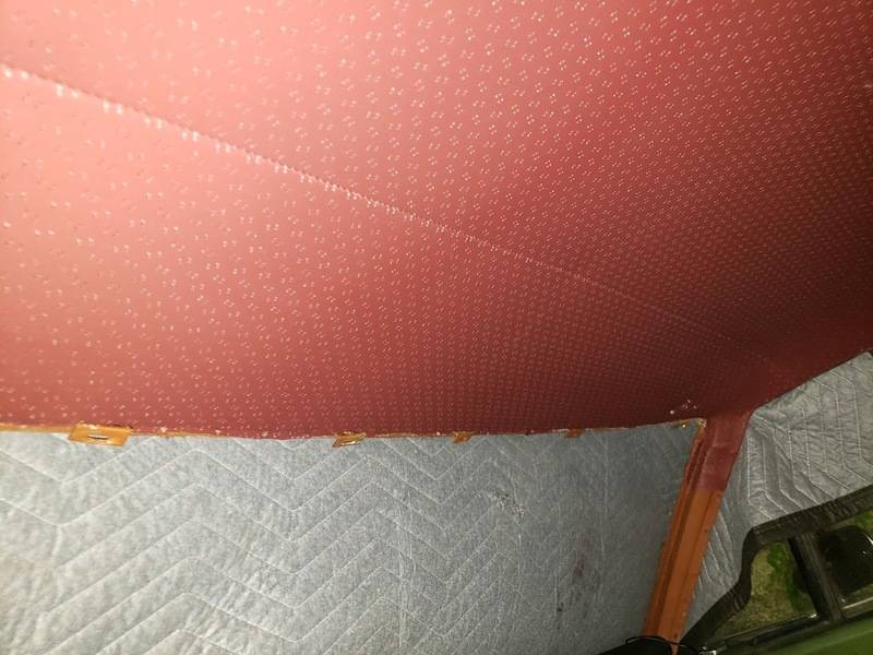

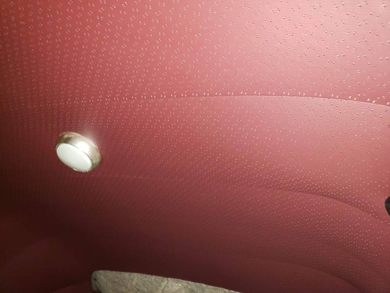

Sitting at my Dad's awaiting it's turn at the alignment shop, after getting a headliner.
B2v9uDbXxc5KB7kOkZPfbcQI10RTvq3Rf1qI4gHkjiEKHtYMVescgpM__c1VegAkRv88VMkIMGTrIRQb2w=w1250-h937-no.jpg
e37Wz9-MYapUQfwvSBHYn79BUJ6P-8SZ-SLTFSJXTzxevFJJjnmRLeNxV6PkE03XGy_1Dc1-sJ6o2ZYjFQ=w1250-h937-no.jpg
OnFCeKr2pvpKhnrdM97zFA6d3pO7vGB4tpLzEKz2zC-dkmr1xa3BTbtGt7obFEvNZRuZinjWlNo6oB052w=w1250-h937-no.jpg
Your headliner looks good. Smooth, tight and straight. I hope mine turns out like that.
