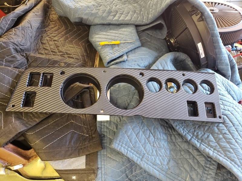

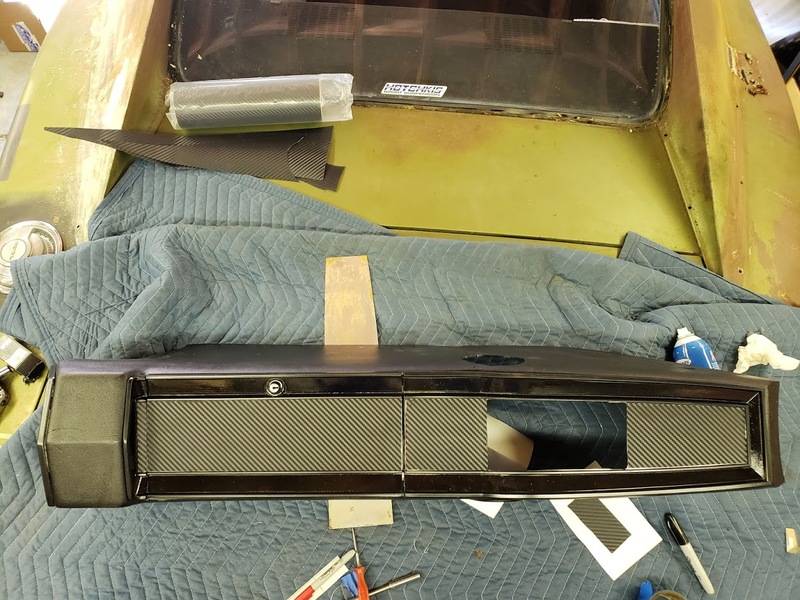

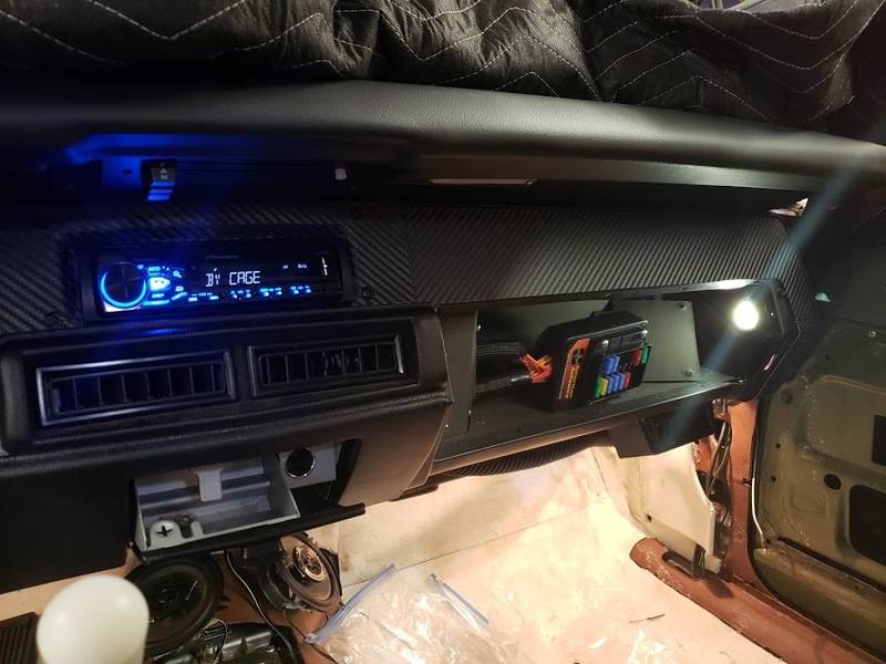

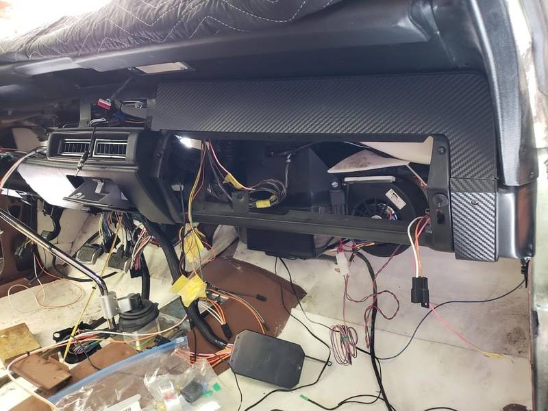

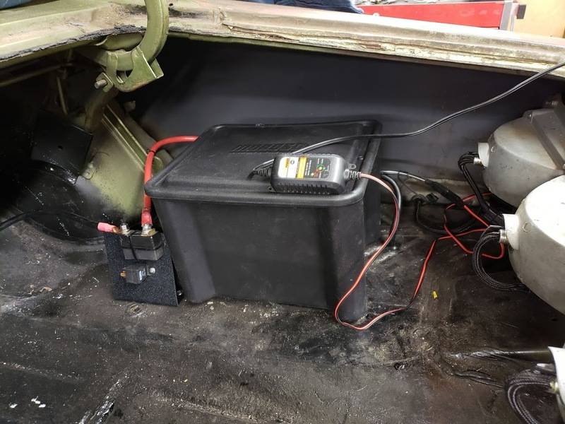

Trunk mount Battery and Fuel Pump wired. Carbon Fiber Dash and console pieces installed.

Looks pretty good. If you swapped the lower dash pieces left to right, would it line up the weave pattern of the carbon fiber?
At first I was like, damn I need to fix that, after staring at it for a bit, I like it the way it is.. I need to check to see of the drivers side does the same thing..

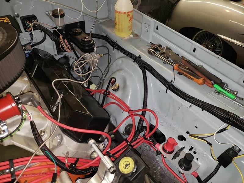

Started working on the Wiring. I am REALLY liking this American Autowire Classic Update. Dash and rear are almost done. Need to wire the stereo/Amp and trunk lights (Car never had the option, but it is part of the kit, so I added it). Then engine and front lighting.. Having a Power probe and a good Crimper is key! The only issue I have had is a 70 Charger only issue.. No provision for the electric headlight motor, but they have a provision for an Electric choke coming out of the bulkhead, boom new feed wire to new style headlight relay. Cut wire on dash side of harness and tap into the yellow wire coming off the switch (going to the dimmer) and add to bulkhead connector.

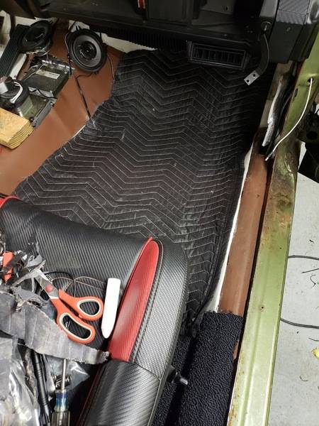

I wanted something to cover the floor while I finish up, so I had this bright idea:
ELRvM0MNDrLudxG9cIQl6aFJR3JENV7a8yT7wxOkMIJQhCuq1ECa8DaC9D5CGJ_q34ojeOfEEhRIfpNGBM0=w704-h938-no.jpg
1URIZ3yvcFMOjwU_Cbz7lEiShsdYIYB9JyTyXrmVHbDj_9bXenlzVc0egn4JQQbGbmwgck7C7rPiivbRCK0=w704-h938-no.jpg
Wife is going to clean them up and edge them and add Velcro..
