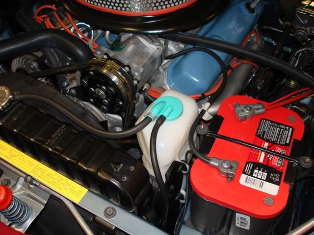

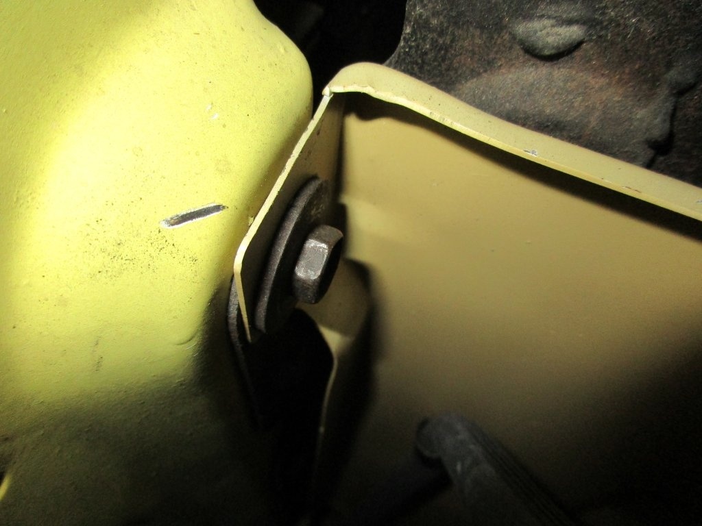

When I got my car it had a small crappy overflow tank. I eventually installed the correct one with the correct mounting bracket. I'm not sure if Plymouth mounted it in the same spot as my 72 Coronet. I can take pictures of mine if you like.
This may help
The repo tanks available today should not require any drilling if have the correct corresponding bracket kit. While not technically the correct tank that was optional in ’72, it will work fine. The ’72 versions are very rare these days and are not reproduced that I’ve seen.

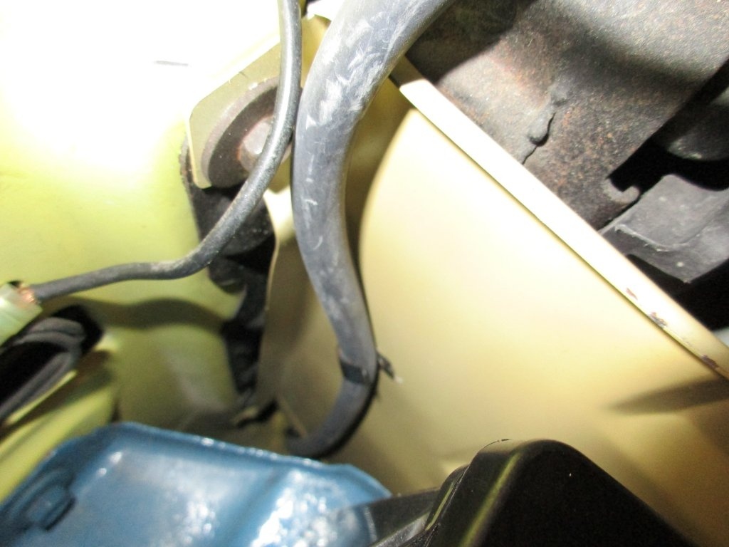

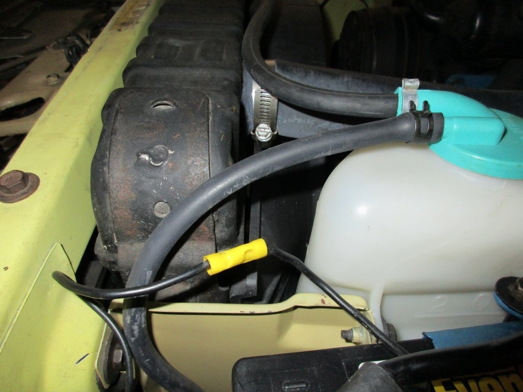

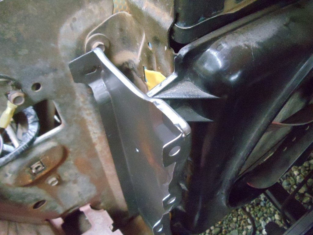

Already spent a small fortune on "correct" bracket and bottle. Neither will fit, my radiator appears aftermarket (no pentstar) and the repro shroud and factory shroud brackets I recently added interfere with bolting on the overflow bottle bracket. Maybe someday I can fabricate/modify the bracket and make it fit. Thanks for the above tips, my friends.

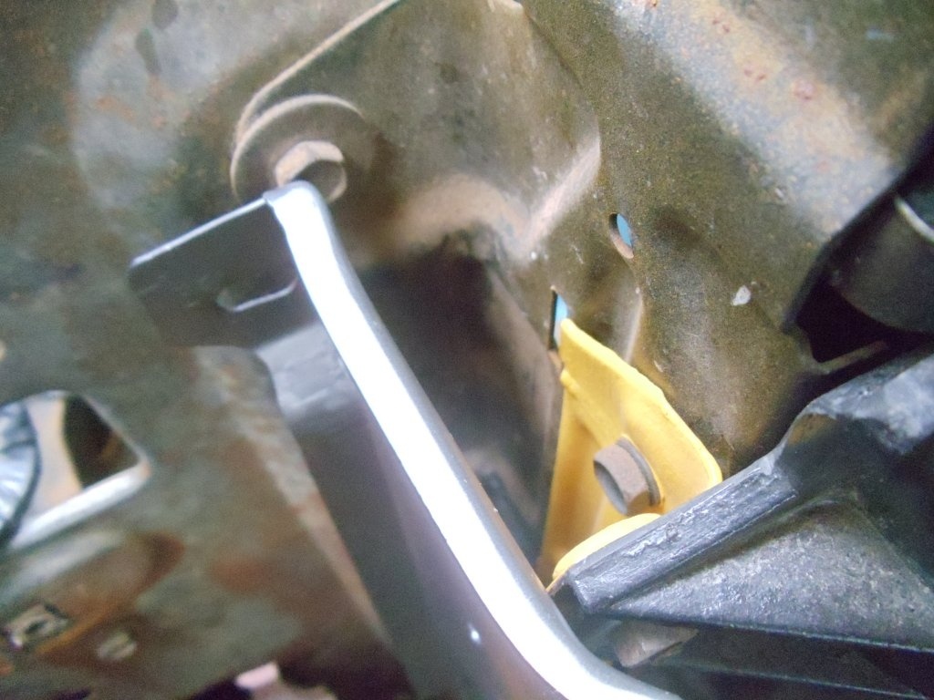

That looks like a 73/4 bracket. 72 is a two piece setup. Bottom one is cup shaped and top one goes over the radiator like I showed before.

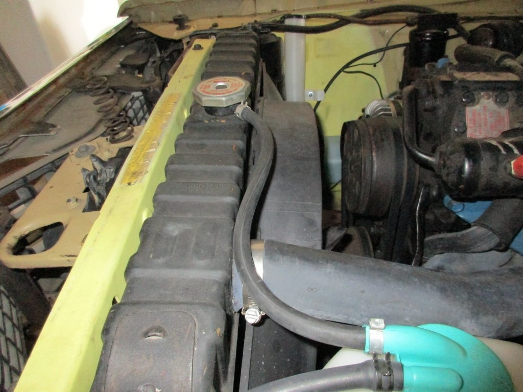

You have the wrong fan shroud and that is hold the bracket out to far. Get the right width shroud and yours should fit like Coronet 14's.
Is that a 22” rad? Appears that rad/shroud combination will not accept the bracket as designed. I can tell you the 26” original style rad/shroud will allow that bracket to fit, I’m running the same parts.
Yes, the repo parts are of a later design.
Already spent a small fortune on "correct" bracket and bottle. Neither will fit, my radiator appears aftermarket (no pentstar) and the repro shroud and factory shroud brackets I recently added interfere with bolting on the overflow bottle bracket. Maybe someday I can fabricate/modify the bracket and make it fit. Thanks for the above tips, my friends. View attachment 331026 View attachment 331027
Having the same problem as yours....22" rad
