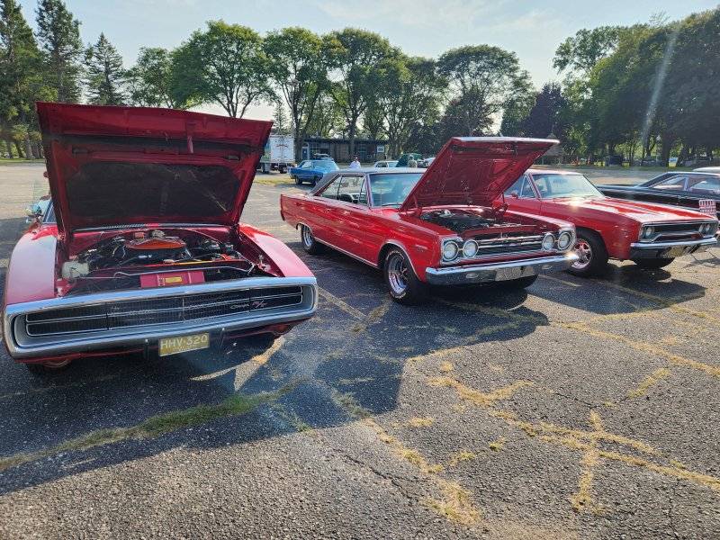

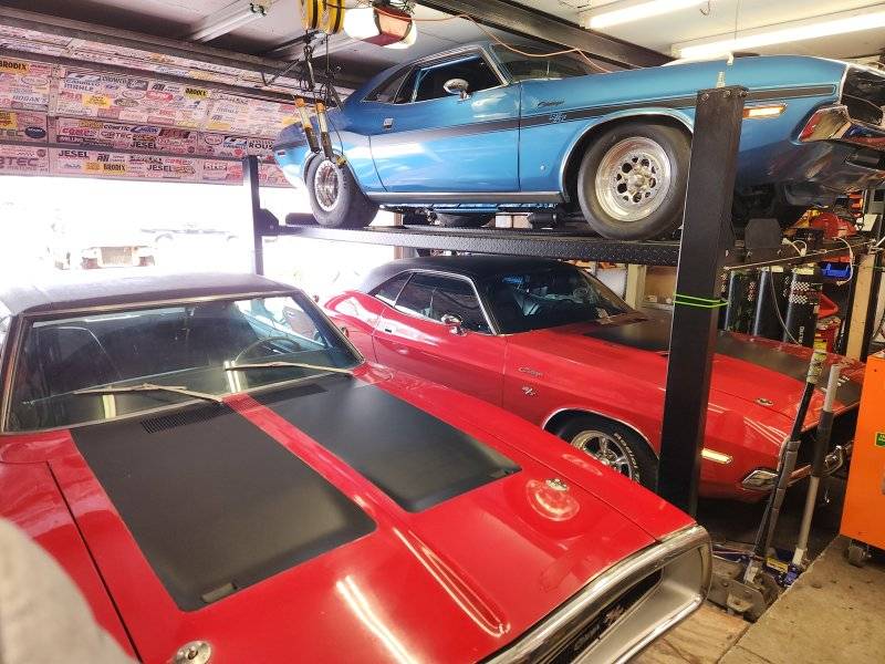

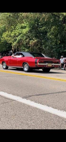

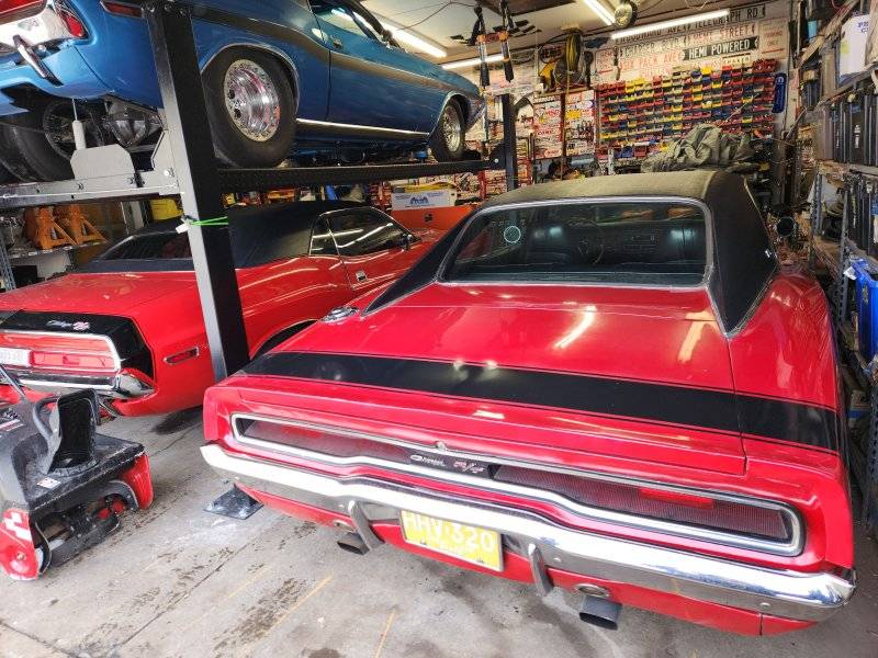

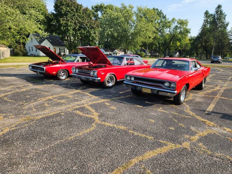

My 70 Charger and my 70 Challenger are both FE5. My buddy's 70 Road Runner is originally EV2 orange, now repainted a custom mix of some sort of red. My buddy's 67 GTX is a custom mix to match the factory 1967 red. All 3 are a different shade of red with my Charger more of a deeper cherry red, the Road Runner more of an orangish tint, and the GTX closer to the color of my Charger. However, they all look the same color in the photos.
