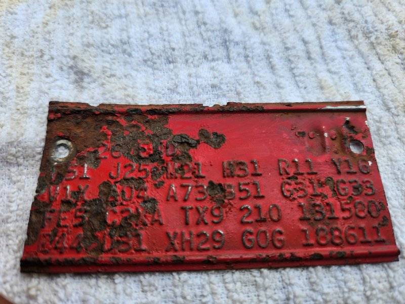

difference in color FE5 and E5?
As said above all the pigments changed so it s different ballgame trying to get the colors correct today. 1985 was the old materials.
Thanks for asking these questions and posting photos. I am contemplating painting FE5 this summer. Hopefully they will get it close when they mix it. Since I'm not trying to match an old color, close will be good enough for me.
luckily I have the bottom side of the trunk lid and radiator support that is not primed/painted yet so they can get it matched.

My tag says FE5 and its a 70

Sorry but I believe E69 F70 and so on
Hmmm..
In 1970 B5 was tagged E-B5..
Further digging discloses...
The 1st letter designation is tied to year of that specific paint code color introduction, not the car model year. For example, my 1970 Plymouth RoadRunner has E-B5 which was 1st introduced in 1969 and carried over in to 1970....

Hmmm..
Just my $0.02... :thumbsup:
Now you've got it. You've got a (E) 69 paint on your 70 rr. Then in 71 (G), B5 formula was changed slightly, so now GB5.
