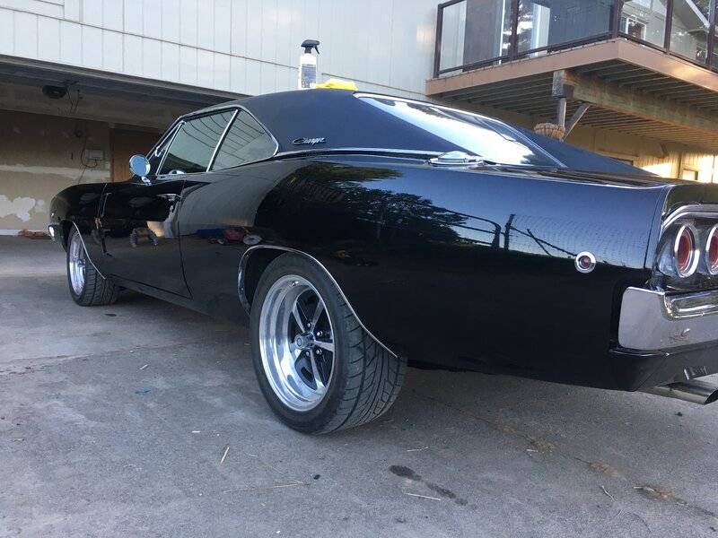

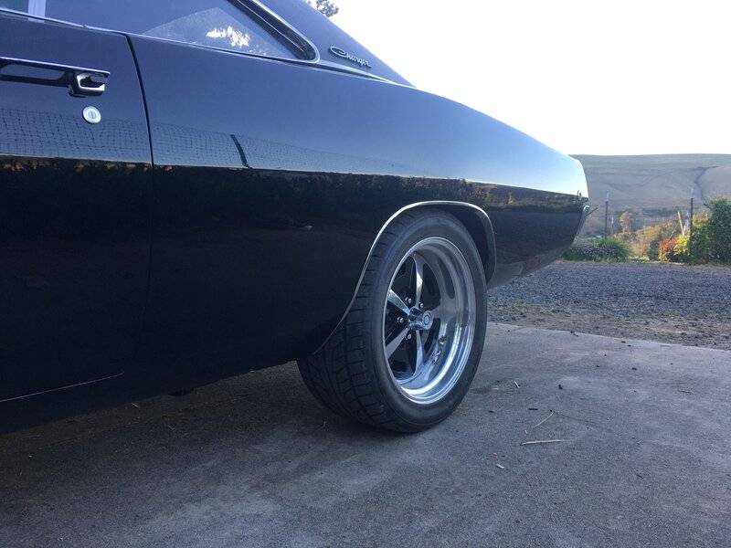

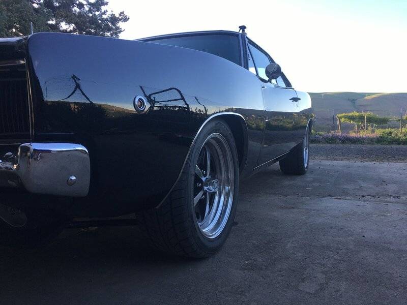

If you meant mine, sublimed70, here it is. This is stock, not +1". New tires in the second pic.
