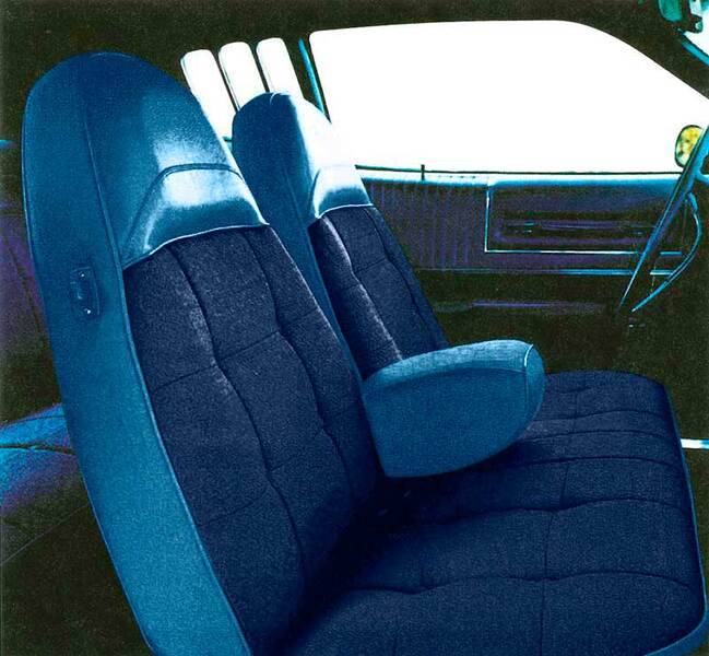

I have seen these split bench seats:
That are in later year cars 73/74. They are thicker and seem to be one whole seat without a buddy seat. Just the arm rest comes down.
Would this be a direct bolt in to my existing regular 71 bench seat holes? Seems like a much easier install. Would there be any problems installing this seat besides not being year correct?

Split bench with arm rest will be a straight bolt up into the regular bench provisions on floor boards

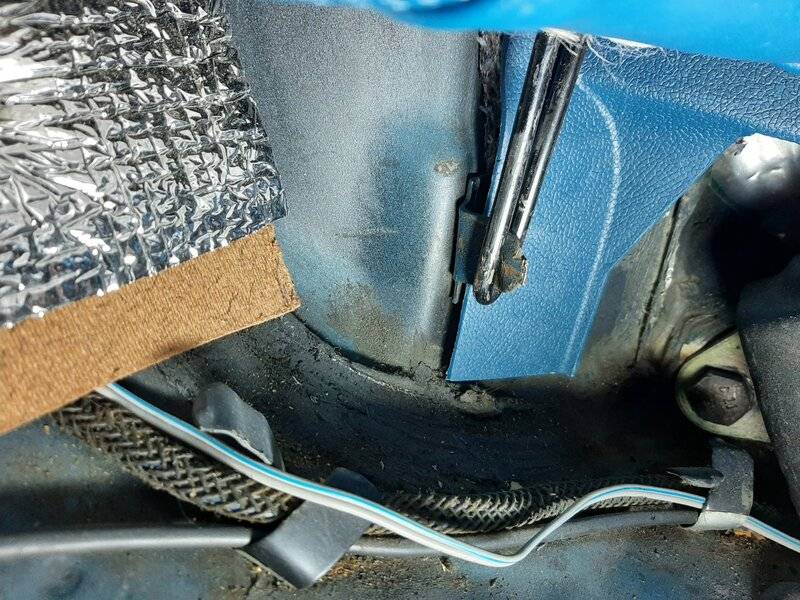

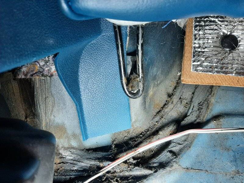

I’ve searched far and wide to figure out how to remove the rear upright bench seat, for my 71 Dodge Charger. I removed the lower rear bench seat no problem. I tore off all the roached covering to rear backrest seat. I also removed all the foam. I’m now looking at the frame and springs. I see no bolts or anything that looks like it would release the backrest frame. Any advice on how to remove the rear upright frame/seat?
Thanks
On my 74, and pretty much I'm sure on all 3rd gens because all interchange, you'll find two bent tabs on every bottom corner holding the seat back on bottom. Straighten them and the will be able to pull/slide it up to remove from the top hangers... and done.

Here's the tabs for seat back Nacho is referring to from my 74 Charger.

Guys, Thanks for the quick response! This Saturday I’ll hop into the car and see if I can straighten the tabs to remove the backrest seat frame. The car is under a tarp sitting outside in 10 degrees F… so it’ll be a quick job :)
Couldn’t wait until Saturday. Jumped into the car and was able to remove the seat. I can now get to the trunk, as the trunk lock does not seem to work(there’s tension, but it doesn’t release the lock hook).
