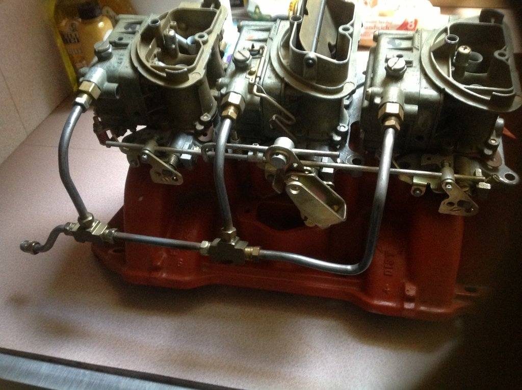

Hello All,
After reading the thread TUNING a SIX PACK I'm looking for any input on these Mechanical
Carbs these are OOTB new unused on a mid 440/.030 with 906 heads pics are below, I was going to take the current cam out and put in a 509-292/292 in her but I think the springs on these heads are to "WEAK"? All input APPRECIATED!!
Thanks,
Mitch
6-Pack: That is a "triple-pumper" setup typically used for race only with HUGE cams/heads/etc. and in my opinion are WAY too much for a 906-head motor with a 292/509 cam.
292/509 Purple Shaft Cam: A good cam in my opinion if you don't have power brakes (very low engine vacuum, so little/no power assist when coming down an off ramp). The old Direct Connection book said the 292/509 cam was "on the borderline" between needing "big"single valve springs & "small" double springs (fyi-doubles require cutting the valve guides & adding Perfect Circle smaller valve guide seals for clearance). If your spring are stock, I would definitely NOT run them with that cam. There's another guy on here that's is trying to do just that & I believe he's getting valve float (motor cuts out at 5000 rpm) and is flirting with disaster of dropping a valve & locking up the motor.

those springs are some kind of aftermarket hipo. count the coils; look like 911's. take one off and test it.

440 source heads OOTB don't come close to advertised numbers in the real world, but edelbrocks don't do advertised numbers either. if I did the 440 source I would send them out for a "tune up" before installing.
I don't like big hydraulic cams of any type. they're just power robbing tune-up headaches.
FYI, if it wasn't already said, with those aftermarket carbs, nothing Chrysler had for tuning tips would apply. Hell, I'm not convinced they ever did for my stock 6 BBL in the '70's. Those carbs will need plain old tuning, dyno could help.
