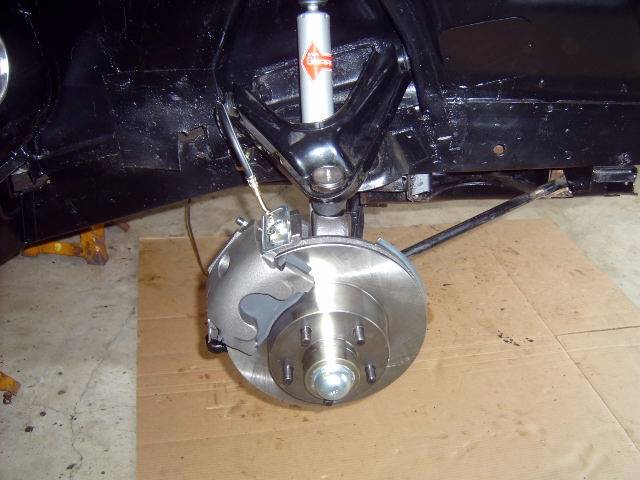

Fine looking installation! That setup will work fine for a stock or slightly hotter than stock.My guess is your brakes would work well.I just converted my 64 Polara to discs and all went according to plan. View attachment 632609

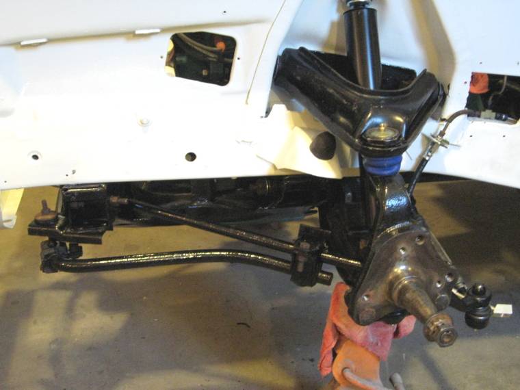

Simple question, when using the A body stuff, can you use the gem 62 and newer B body upper control arm or do you need to get the 73-76 A body version?
Ok. So that helps. It is different than A bodies. So you basically just take the complete spindle and swap it on then, that is easily doable. Tie rod tapers are the same?
Ok now I have it. I have a couple of A body swaps that I could employ. Was not sure if there were UCA issues such as with A bodies. That looks easy enough. BTW-does this advice generally cover all B bodies through about 1970?
$250 is a great deal for an SSBC kit. What model is it? How many miles on them?I purchased a SSBC kit like Al. Worked great, but did not clear my 4" wide Cragars, nor the ET Wheels I planned to run. The caliper rubbed the inner rim. I put a set of "Pirate Jack" brakes on FRUSTRATION. They fit great and cost around $500 without the master cylinder. They did clear the narrow wheels. Decided to purchase a second kit from Pirate Jack (ebay has them). They work great. If anyone is interested, I'll sell my SSBC kit for $250. I'm in PA. Send a PM.

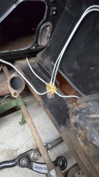

https://www.inlinetube.com/_p/prd14/2359639471/product/1962-64-mopar-a,b,c-body-distribution-block-blk241
First is a little pricy but you get proper fittings for master cylinder and the block takes regular size fittings.
Remember rear port on master cylinder is for front brakes.
Parts not mine. fbbo disclaimer.

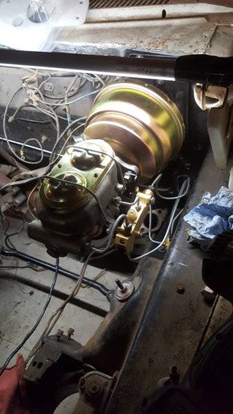

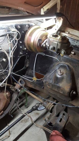

do you have a pic of the master
The only reason I used non mopar I because it was power brake car I switch it to manual and lost the original brackets so it was easier to go with the corvette style
