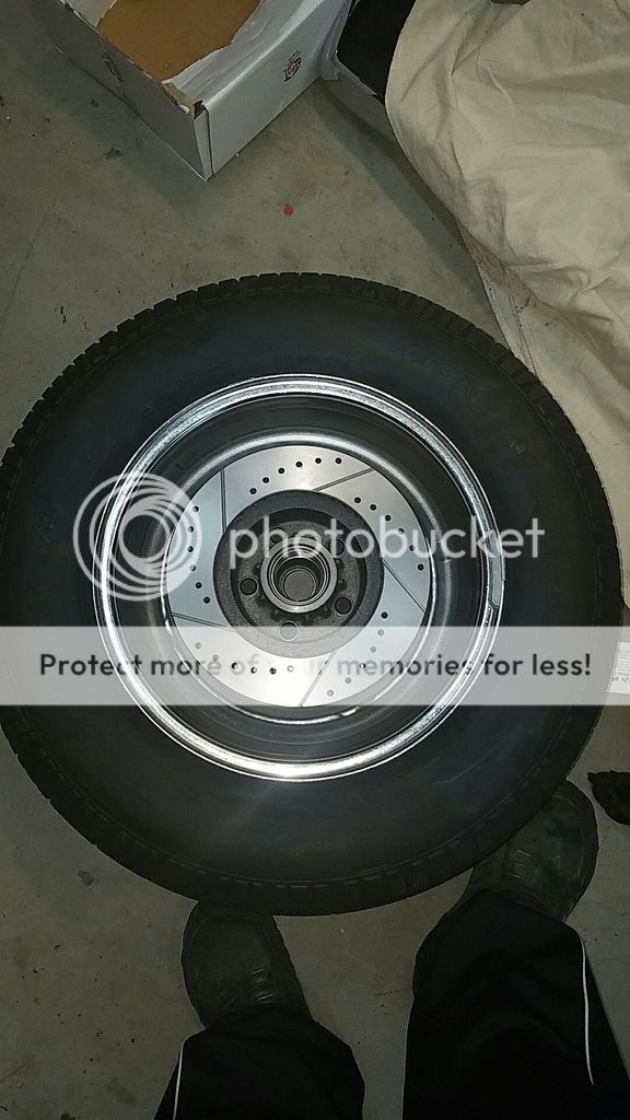

PirateJack.com! I just picked up 2 rotors drilled, slotted and vented for $60 each free shipping no tax and they fit perfectly with wheel studs already in them and the spacing is perfect for my mag 500's and M/T tires.
