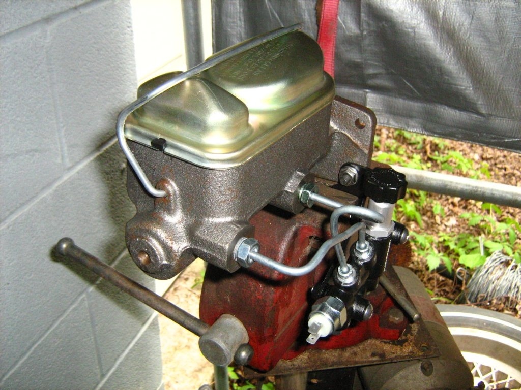

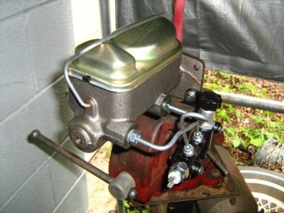

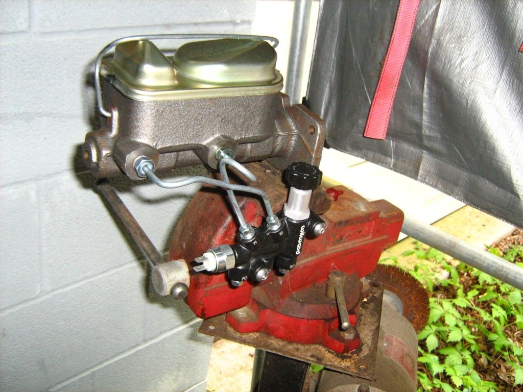

I'm about to do this conversion on my 65 Coronet. I did it on my 64 Belvedere a few years ago and that car burnt that winter in a storage fire. Can you jog my memory on the brake line routing? Which l line is the prop valve plumbed into? I feel stupid after doing it and not remembering. Seems to me the original dist block was just blocked for the rear port and the rears ran through the prop valve. Fronts went through the factory block.
You might have to replace all your brake lines. The single master cylinder uses a multi line connection about 36 inches from the master cylinder. On mine and several others the lines could not be taken off cleanly, rusted on. The line going to the rear brakes is where the adjustable valve should be installed. The line going to the disc brakes(larger size) could run to a 3 way connector. One line to master cylinder, one line to left and last line to right. The right side line CAN be made with the engine in the car, but is much easier if it is out. The front disc brakes run at full pressure all the time and the rear drums at a reduced pressure.
On a daily driver it can be hard to find the sweet spot for braking pressures, dry, wet and icy. On one car I went to a empty clear parking lot when there was glare ice on the roads and tweaked the valve till I had clean stops. After that the brake valve was left alone, the wet road braking was correct also. Much easier to set for dry only.
Due to connections I have been using the Wilwood adjustable valve which connects all the brake lines and valve in one place, without any adapters and is bolted to the master cylinder mounting.
edit: WARNING Mopar uses a odd size fitting on their master cylinder for one side, the other uses a common fitting.
2014-08-07-1 Coronet master and lines.JPG 2014-08-07-2 Coronet master and lines.JPG
